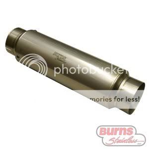

I know Im thinking ahead but I keep thinking of the SEXY exhaust tone of the VQ35DE engine and was woundering what if any body knows of a good sexy muffler. I thought of running a flowmaster, to give it a deep rumble but when I looked it up on youtube it didn't sound right at all so here is my second thought and its light. Does anybody else have any thoughts?
When Cornered, What G's Can You Pull
