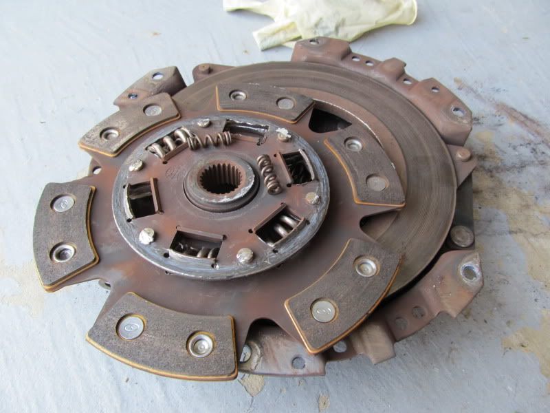

I had a Spec Clutch stage 3+ in my old sr20det so I decided to go with them again on the KA. Up until this past week I've loved the clutch but last Saturday I went to leave work and couldn't get it into gear, so I managed to limp it home without stopping after finally forcing it into gear. So I figured it was the clutch master, so I replaced it and bled it and I guess by some concidence it was ok for about 2 days before the same issues came back. ok? So I checked everything and I have full potrusion on the slave cylinder so I know that's working properly. The only thing I can think of is that something is wrong with the clutch that I've put MAYBE 4k miles on and have had in since April.
I'm hoping Spec has some good customer service and will work with me because I took all the time in the world on the install and I know it was done right. Right now I'm not a very happy person because now I can't even get the car to move without using the starter to bump me to get going. So I'll be doing that or riding the bike to work in the meantime. / rant

What does the pedal feel like? Does it go straight to the floor? Is it "mushy"? Any strange noises?
A pressure plate is pretty reliable and if they break, they break. It won't stop working then start working again. The clutch disk (if sprung) can loose a spring that will interfere with operation. It is not uncommon and is usually complimented by noise.

i had a spring pop out and it made the cluts work some times but not others.

Kfred wrote:What does the pedal feel like? Does it go straight to the floor? Is it "mushy"? Any strange noises?
The pedal feels good, well it has pressure to it. I'd almost say that the clutch pedal is STIFFER than it was before. Almost harder to press down.
sdaigle240 wrote:i had a spring pop out and it made the cluts work some times but not others.
This is what I think happened as I had it happen to another car of mien.

I vote you spewed a spring, possibly 2, out of the clutch disc.

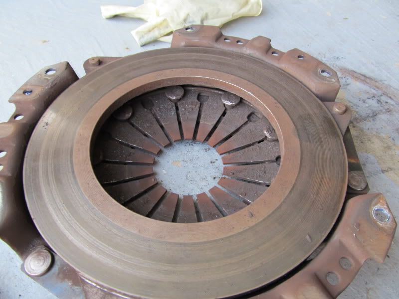

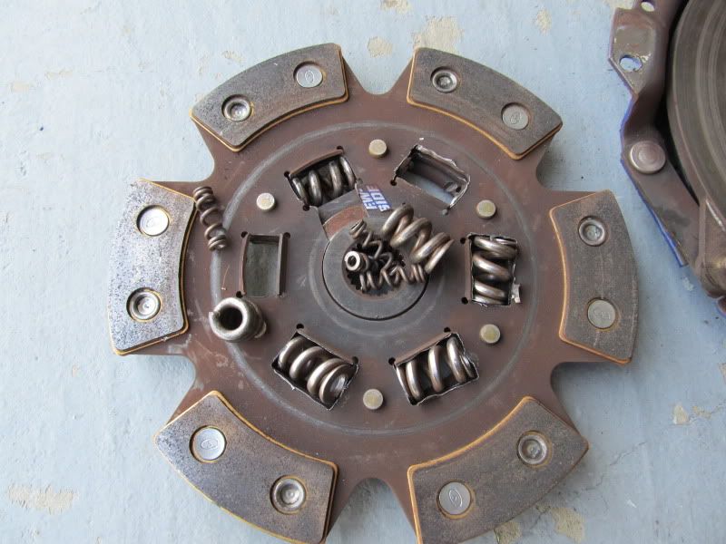

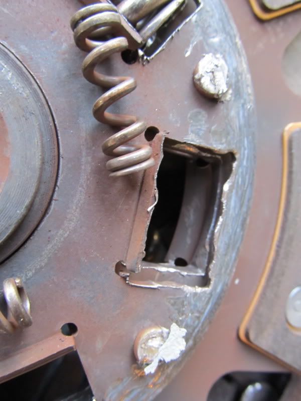

I've done this more than enough to know when something isn't right, and I was right to go about ordering a new clutch. I should add that I had double checked to make sure the hydraulic system was working as it should and transmission was in good shape. Pretty much only thing left was an internal problem with the clutch, and I was right. I shall let the pictures speak for themselves.
Friction material is BARELY worn as you would expect from a clutch with 4k miles on it at most. Pretty much all of the springs of the clutch disc fell out and were ROLLING AROUND inside. As my friend was turning the motor over with a rachet to give me access to the PP bolts we could hit them all rolling. As soon as I pulled the PP off all the springs fell out. I have never seen that kind of crap before where ALL of them fell apart. Even the XTD clutch I had in another car lasted me 70k miles before it fell apart. This is just unbelieveable. I know I won't be buying another SPEC product in the future.

I've said it before but those oem sized 6 spring clutches are not good for us turboed. They use stock stiffness springs and when they coil bind they twist and bend the retainer sections.
