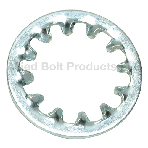

Internal tooth lock washers
You need something that digs into the material. These do the trick. My local Ace hardware store has them in stock. Should be easy to find and are inexpensive

^Yep, those should work fine for you. Something you might want to try if you want something fancy are Nord Lock washers - it also looks like there are knock-offs on Amazon now for about half the cost as the real ones.
