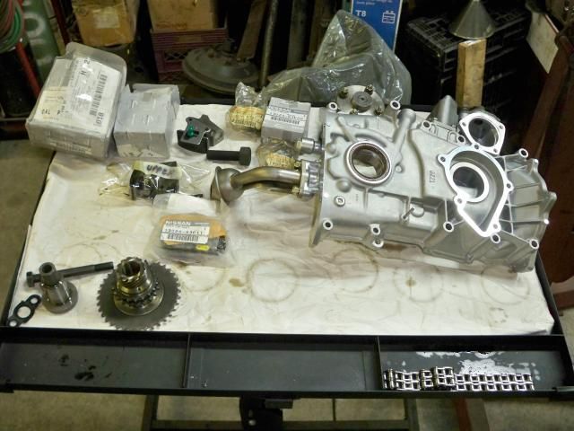

So, I've been getting out to my dads place again, Monday evenings like last time, and have made some pretty good progress.

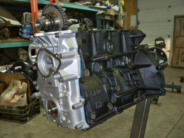

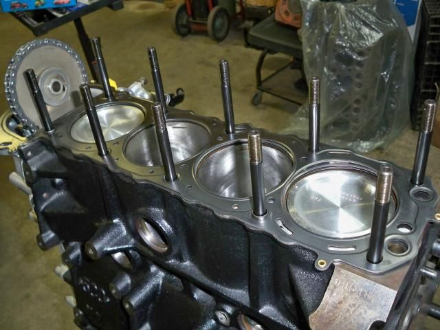

I can't find the shots of assembling the short block, but here are some of the progress pics thus far:

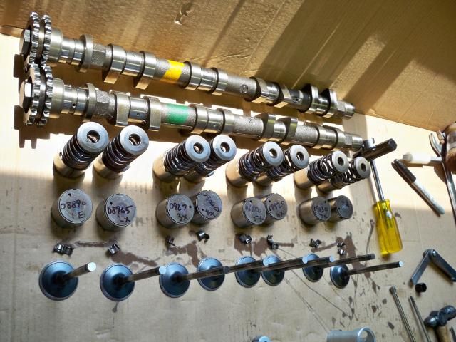

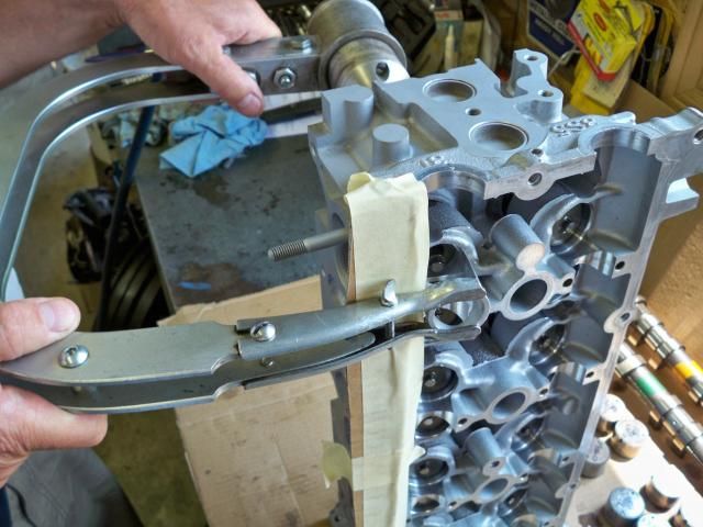

instead of searching for shims, we checked the valve lash and machined the stems to get the right numbers. Took a couple tries for a few of them, but we got them all right on spec.
Fancy removal tool my dad machined up
Timing is everything!
Goodies!!

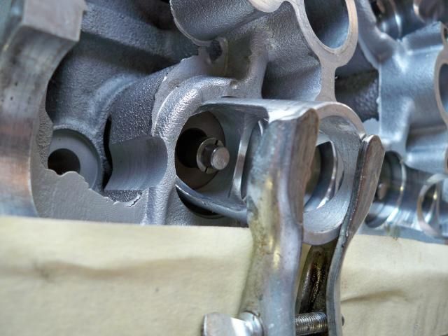

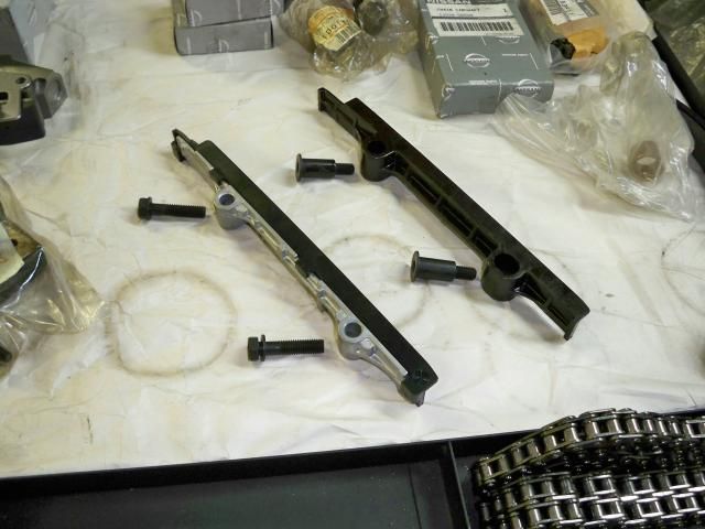

This pic is of both the old and the new replacement guide for the right side. As everyone says, be sure to order the correct bolts for the newer guide! I didn't, but luckily my local Nissan store had them in 2 days for $2.50 each.
The one on the left is the new one.
Painted her up today, lower timing cover on and torqued as well.

Got the head on, torqued with ARP studs and a new cometic head gasket.

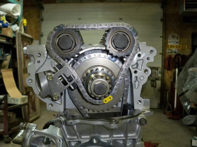

The yellow tag is connected to the cotter pin holding the tensioner spring as a reminder to remove it.
And we're done for another day. Next week, new cam gears, upper chain, and tensioner.

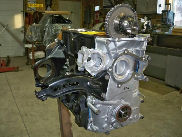

Another week, another couple hours out at Dad's.

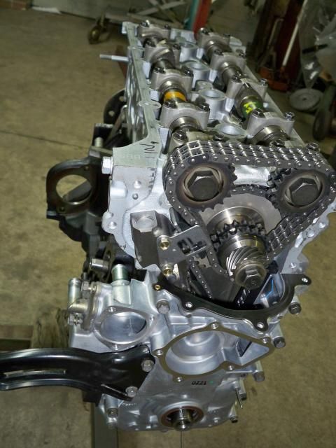

Finished installing the timing stuff!
New cam gears and bolts installed
New upper chain and tensioner
Also had to pull the cam caps off to lube them. (thanks to my dad for asking if I had done that.. brain fart)
I know this may be painstakingly slow for some readers (if there are any readers), but I'm just happy there is progress happening!!

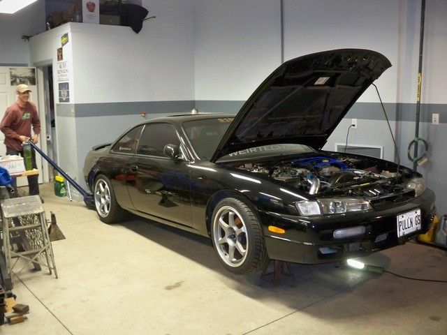

Has anyone else done a base dyno run before the turbo instal?
This is mine with just a k&n drop-in filter and a full mani-back exhaust
And this was after the turbo install, tuning the SAFC.

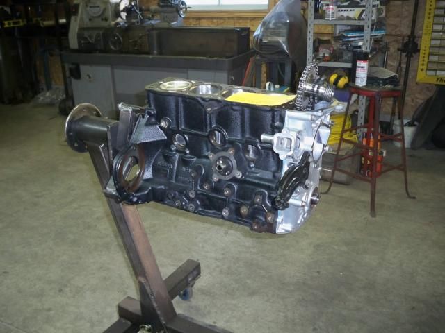

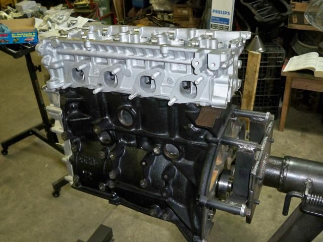

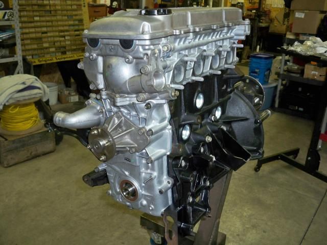

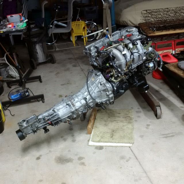

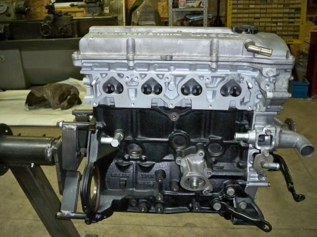

OK 3 week update.

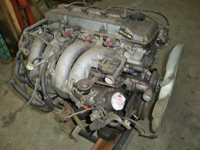

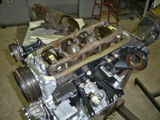

A VERY good friend of mine gave me this motor, and it is coming in super handy as a guide now that I'm bolting everything onto the motor.
All finished inside the motor, and she's all buttoned up!
Rudy makes a special (sleepy) appearance in these next two shots!
Getting some brackets on, also the frost plugs are installed (except the rear one dues to the stand.. hopefully I don't forget it!)
Just have to scrape the excess gasket maker off when it's semi-dry.
Front shot

I notice your cams are orange on the intake and green on the exhaust, are the s14 colours backwards from the s13 cams ? I have my orange one on the exhaust. But everything installed right and looks good.

ka240de wrote:I notice your cams are orange on the intake and green on the exhaust, are the s14 colours backwards from the s13 cams ? I have my orange one on the exhaust. But everything installed right and looks good.
You just made my heart sink into my stomach.. but they are right. The second pic in my first post of this thread shows them before they came out.

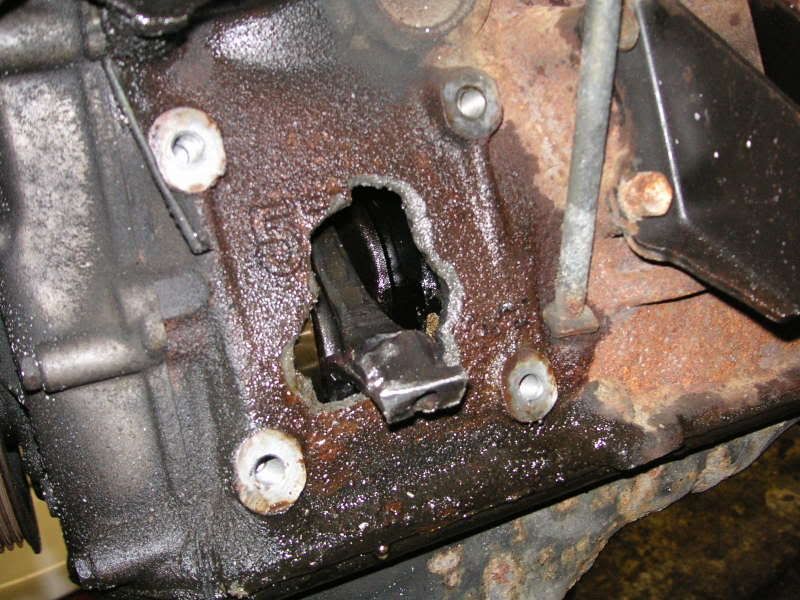

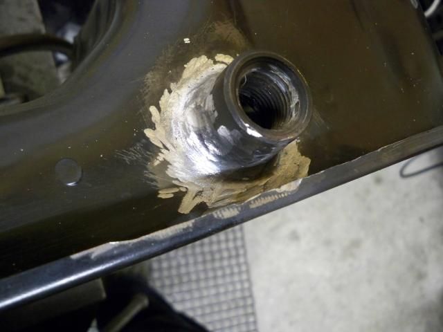

After my last post, I started working on the oil pan. I had a small leak since the original turbo install that was coming from a pin hole in my oil return bung welds.
I ground it almost all the way down, re-welded, and then tested and painted it. I don't have a finished product pic, but here it is before the re-weld.

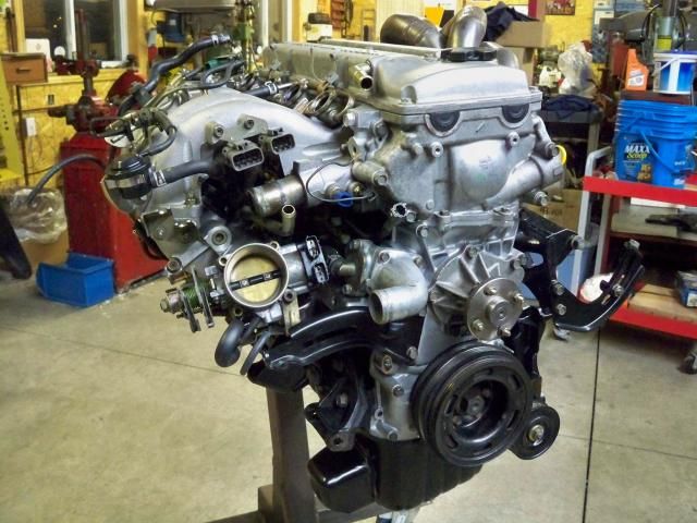

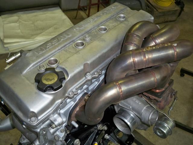

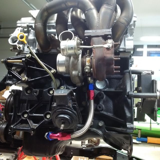

I started to get antsy to see the turbo and manifold back on, so I temporarily bolted them on.

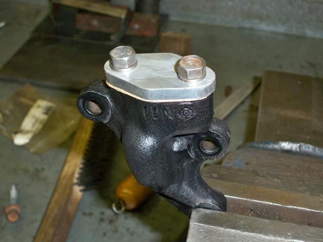

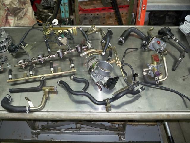

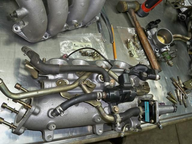

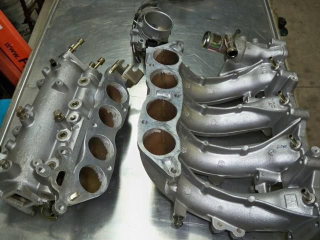

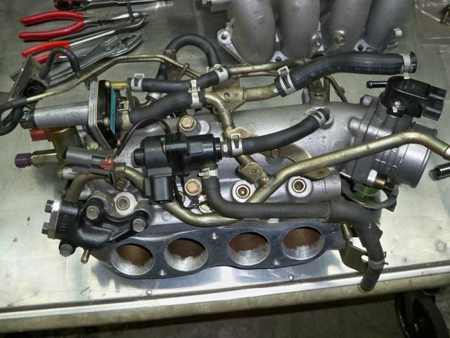

Time to get some real work done. I fabbed up an EGR block-off plate

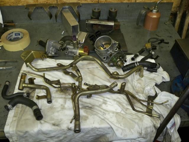

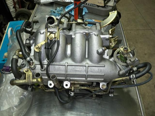

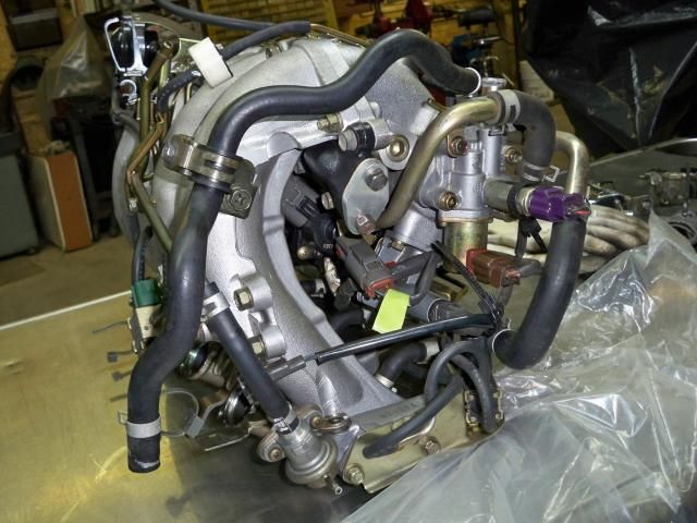

Cleaned up all of the vacuum hard lines and hoses that go onto the intake manifold
Plenum ready to accept the lines
So far so good. The spare motor from my friend John is a gigantic help on this one!
Next week, more EGR elimination and instal the resistor to trick the ECU into thinking the EGR is still operating properly.

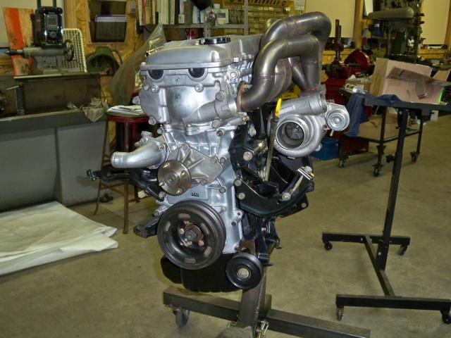

June update!!
Been grinding out the odd day and making progress.
The Manifold is all buttoned, hosed, and torqued up.

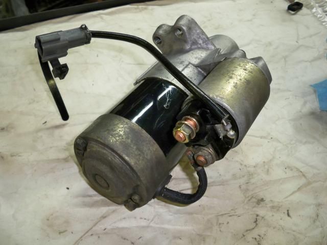

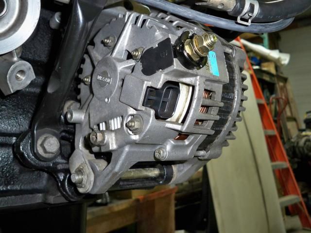

Cleaned up the starter and alternator
The alternator was doused with oil spray from when the oil puked out of the valve cover, so I decided it would be best to check it out inside. I cleaned it up the best I could, but when I went to reassemble it, the rear seal had gotten saturated by the oil, and swelled to the point of not being able to instal it. A great friend happened to have one kicking around, so we swapped seals, hoping that mine would eventually dry up and shrink back to the proper size. Just gotta get my seal back to him before I lose it!

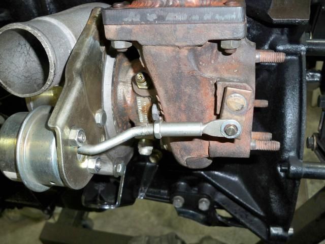

Did some reading up on wastegate set-up, and adjusted mine. I had it waaay too loose before. Should be more power right there!
After all of that, The long block is all together, except for the turbo manifold, one frost plug (engine stand is still in the way), and I have to torque the crank pulley. Super happy day!!!

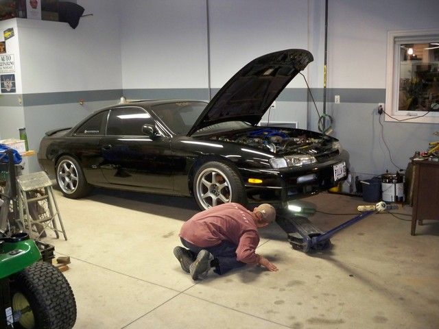

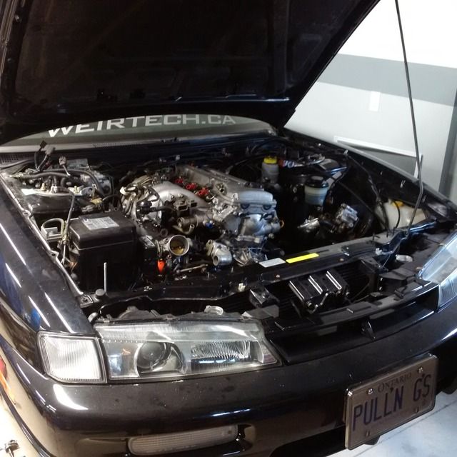

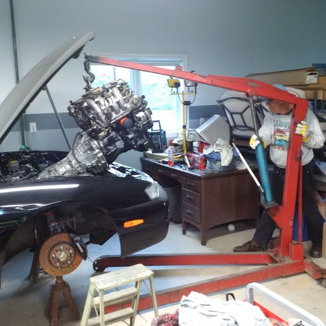

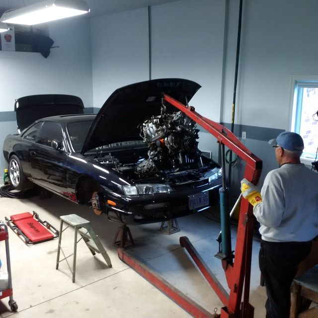

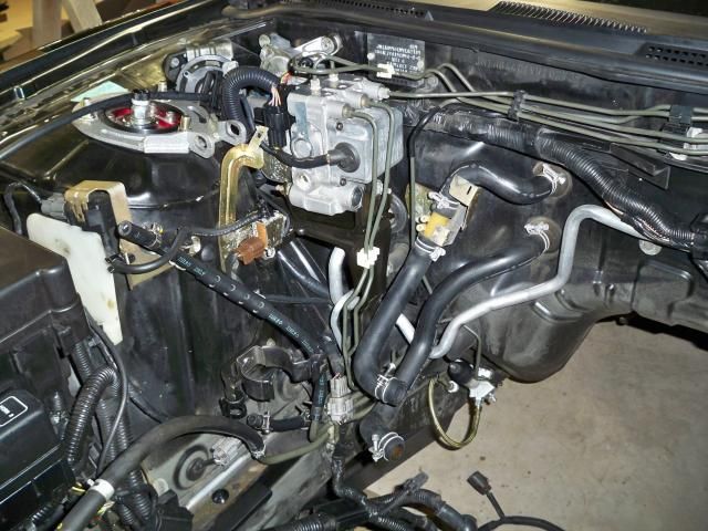

Now over to the "clean" shop, where the car is, to see what we find under here:

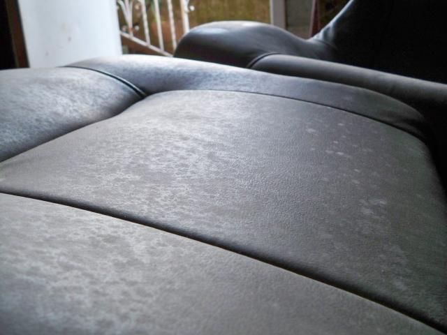

MOLD! tons of mold spores, especially the interior. More on that later.
The engine bay looks pretty much the same, a bit of mold on some of the rubber parts like the tie rod boots and some random spots in the bay. Shouldn't be hard to take care of that.

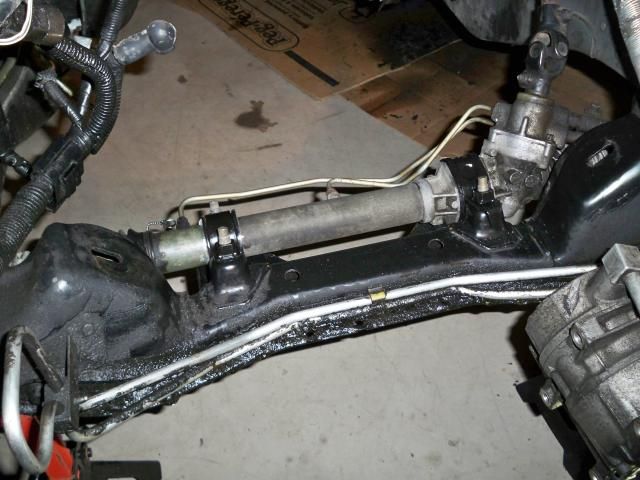

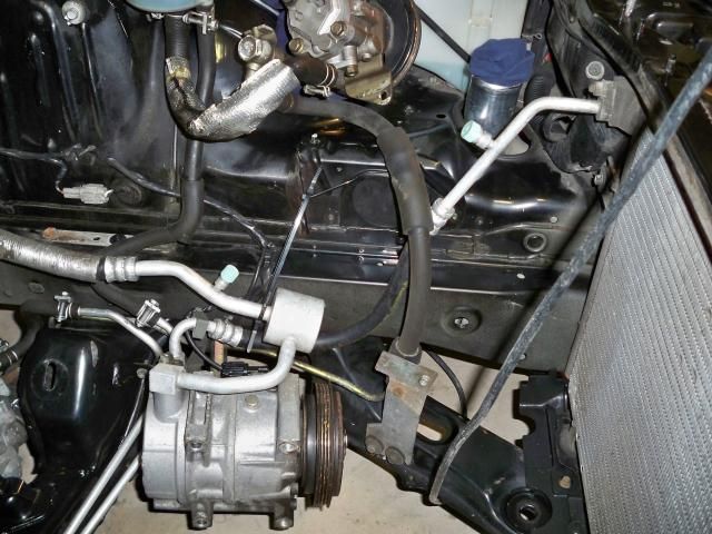

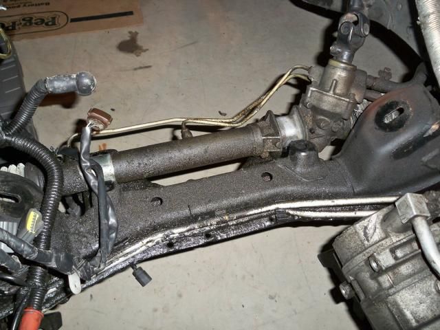

Pulled the tranny and front driveshaft portion. Removed the steering rack brackets to instal energy suspension bushings on it.
I was going to clean the bay right here, but soon realized how greasy it actually was and decided to get the bushings in, lower the car back down and push it outside to degrease it out there on the gravel.

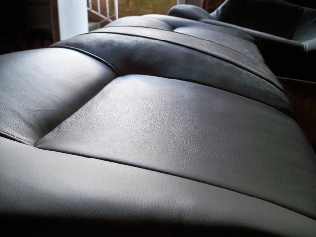

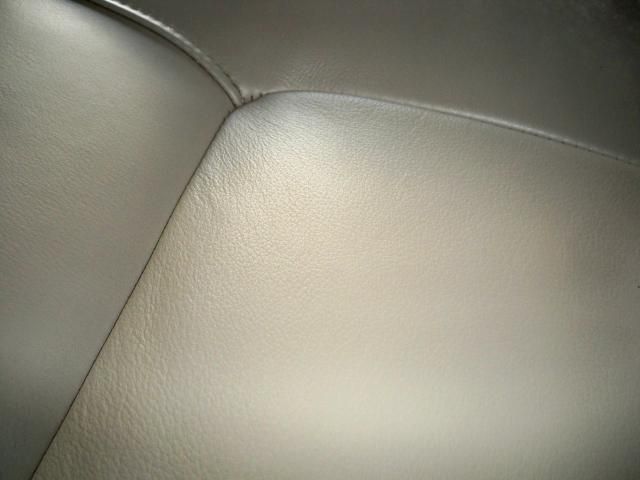

Now, back to the interior mold I mentioned earlier.. The entire interior will need to be removed for cleaning, ARRG!! One of the drawbacks of inside storage.. lack of fresh air. I even had the windows open a ways along with the trunk popped a bit to let the seals expand for better sealing.
So, I started with the leather mostly cause it's the easiest to remove, but also because it would be the most $$ to replace, and they are in pretty good shape.
Before:
During:
After:
I'm doing a 4 step process on the leather.
Step 1:Norwex bed mattress cleaner (kills all living organisms without bleaching)
Step 2:Leather cleaner with a light duty fingernail brush then buffed with a cloth
Step 3:Leather conditioner, hand-massaged in and buffed with a cloth
Step 4:NEVER let this happen again!!!!!!

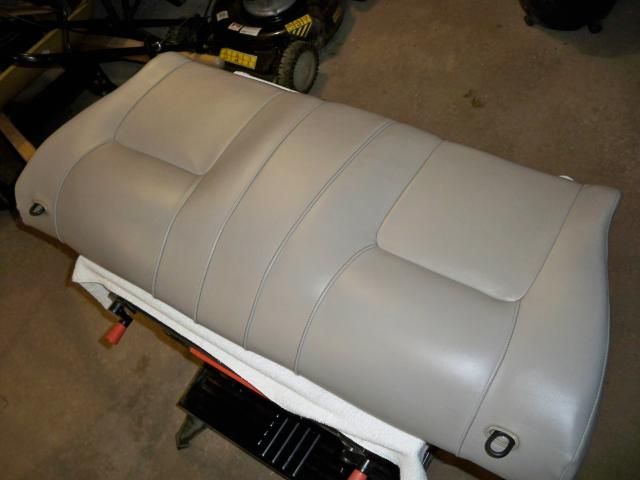

I finished cleaning and have applied the cream onto the back of the rear seat. It is now being stored in the house, where the temp and humidity is fully controlled. I can even monitor it with an app on my phone, and it will notify me if something happens outside of the parameters I have set.. So we should be good now!
Here is a shot of the rear, bottom seat, to give you a comparison. It is now ¾ of the way done too.

Ya not looking forward to chasing leaks when its installed..
I don't have a tig welder. My former sponsor Weirtech welded the bung into the coldpipe for me, if that's what you are refering to.

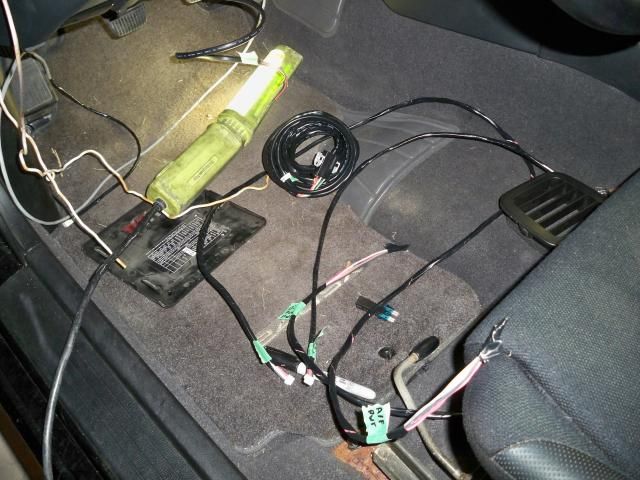

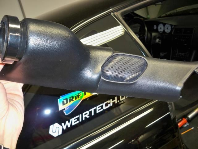

Slightly modified an Autometer dual gauge pod to fit above the tweeter.

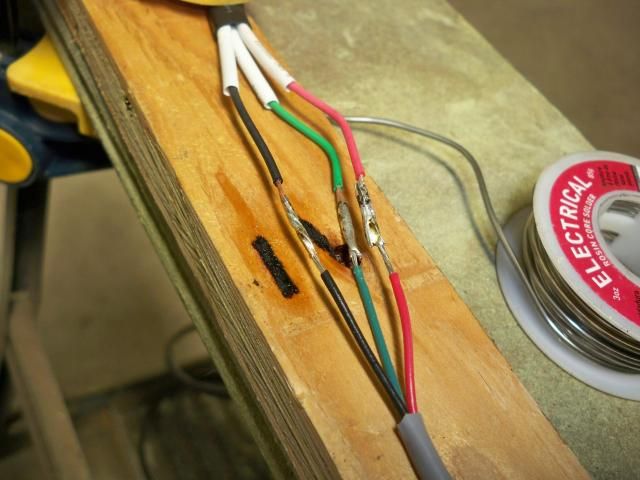

Soldered and heat shrunk all of the gauge wire connections.
Fun stuff.... actually wasn't too bad, just takes time and patients.
I was very happy with the fitment and texture of the plastic on the Autometer pod. The AEM gauges also fit in the holes nice and snug.
I wasn't fond of the plastic mounting hardware that came with the kit, so I epoxied some nuts to the back of the a-pillar, then used some stainless machine screws to fasten the pod to the pillar. It is working great, and I love the way it looks.
Gauges all finished up with the TruBoost set in where the lighter socket used to be.
Fabbed up a little 2 ply heat shield to protect the vacuum hose and gauge wires where they come through the firewall, as it is right behind the exh mani.
With the engine bay all cleaned up and wires run, it was time to bring the engine over from the engine shop.
It wasn't a very long trip (about 60 feet), but the driveway is gravel, so dragging the engine hoist over was not an option.
I hired the best crew I could find...
This is my Dads 1928 Model A Roadster Pick-up. All original with mechanical brakes, 6 volts, and a crank starter in case the battery goes dead
Once the engine was delivered, I could start getting things ready for insertion.
Cut and fitted the new oil drain line. Again, very happy with the kit (ebay), just had to purchase a 45 degree fitting separate.
Installed the new XTD 350z/RB25 clutch and pressure plate combo with the billet flywheel. I have heard mixed reviews on this set-up, but am hoping that with a long and easy break-in, she will work good.
Tranny is bolted up. Getting excited!
Time to throw this sucker in there!
Thanks for all the help, Dad!!
This is what he is working on these days. 1932 Ford 3 window coupe. This car will be getting that flathead V8 from the first page of this thread.
Yours truly.. cranking down my urethane filled engine mounts.. we will see how long they last.
AND SHES IN THERE!!!

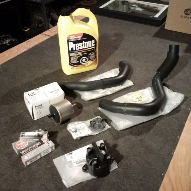

The final batch of parts came in from Nissan.

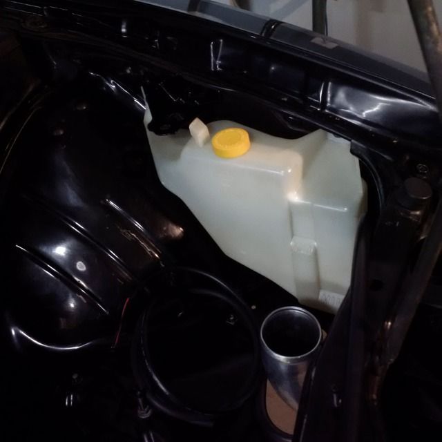

Removed the coolant overflow tank for a good cleaning and de-burr of the plastic flashing to facilitate easier cleaning in the future.
The vacuum lines will need to be routed properly, but everything should be in order at this point!!
