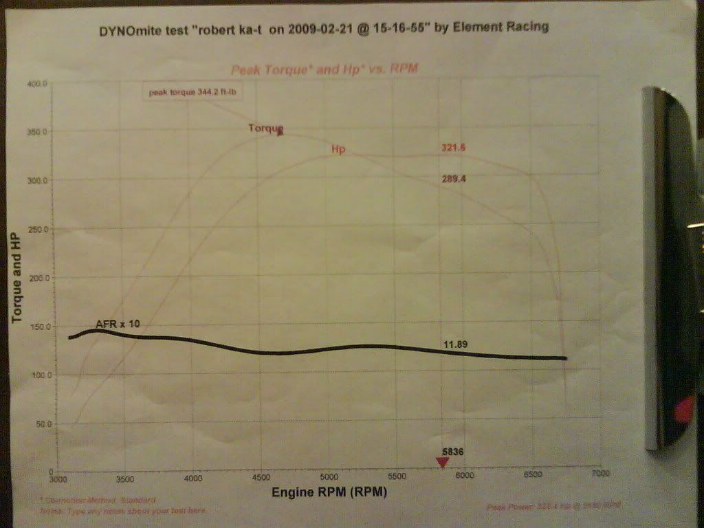

and heres my dyno i had done at element.
clutch was slipping pretty bad in 4th and 5th
kinda suspicious if thats the reason for it flattening out so much.
this was at 18psi and definitely not its full potential some things i need to fix that arent quite right
