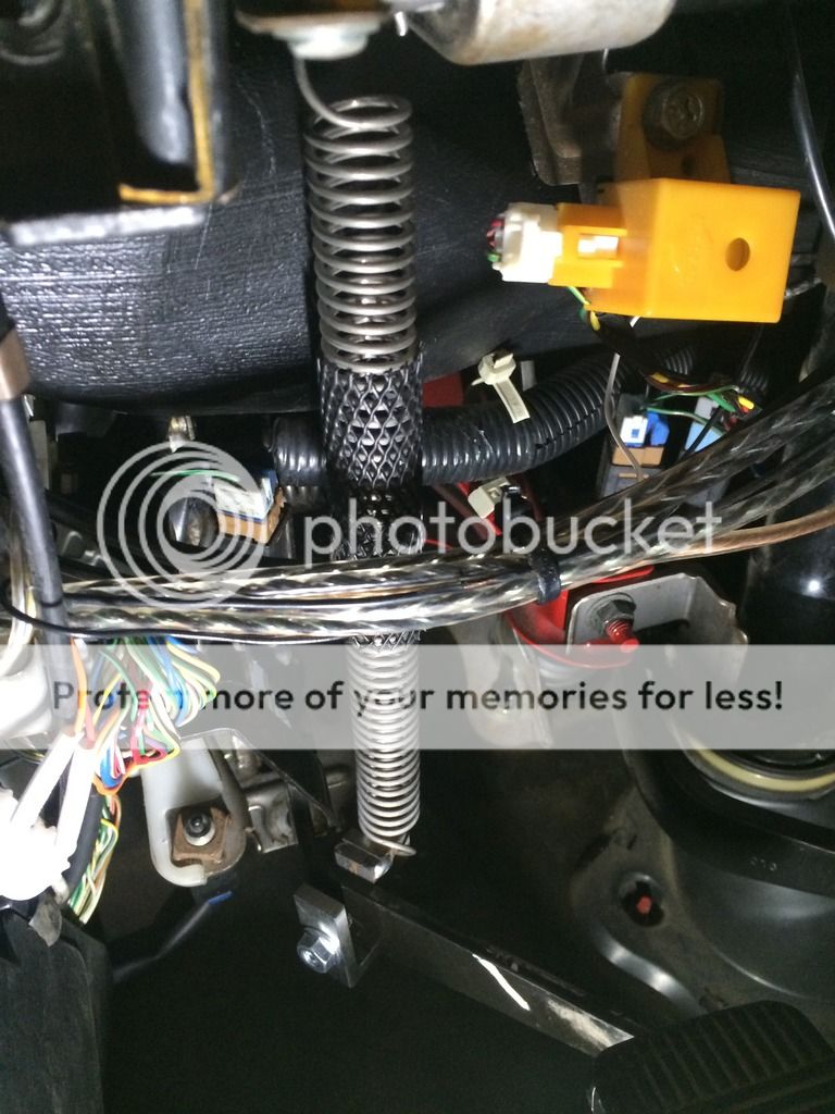

I know this is an old post but this is the most appropriate place to post the clutch hydraulic problems for high powered KA's. So here is my fix to the clutch pedal problem.

Hmmm...good idea. I go through quite a bit of slave cylinders. Wonder if this will fix my issue.

So the issue is with the pedal itself? Where did you get the spring?

I just run factory Nissan Slave. I have seen too many people with trouble out of the cheapo's. I refuse to spend the money they want for a Nismo. From what I can tell the problem is hydraulic. As stated before at high power levels (Above) in 3rd and 4th gear on a Z32 tranny these are long pulls. The pedal will start dropping to the floor just as Boback described. At first I thought it was a unique problem go him. Then I did my upgrades and making more power and experienced the exact same problem. What I did figure out was if I kept my foot under the pedal not allow it to fall during these pulls my clutch worked perfectly. If I didn't then you have to pump the pedal to get the pedal to come back to normal position.This kit is actually designed for the Vette clutch pedal. I had to add 1/4" thick piece of metal plate (its very small) to use as a shim to place between the "U" that goes around the pedal and the set screw. Also I drilled a small hole on the edge where the spring is hooking through in the picture under the dash. I needed a 90* drill to pull this off at least for me. Its very simple and easy. With this installed there is still smooth engagement and disengagement. The only difference is the pedal a little more firm.
Here is the link where I bought the kit http://www.lingenfelter.com/product/L36 ... 4i45zVZrIU
Like I said "You have to add a 1/4" thick shim to work on the 240 clutch perfectly the keep the "U" square. The U is just too big to use without it and expect it to work perfectly in my opinion.

Post by adamky » Fri Jul 15, 2016 7:05 am
At what power level did it start to happen, approximately? You made 530 or so whp for years without issue, correct?
Excellent work figuring this out! I would have never guessed that this was the fix.
