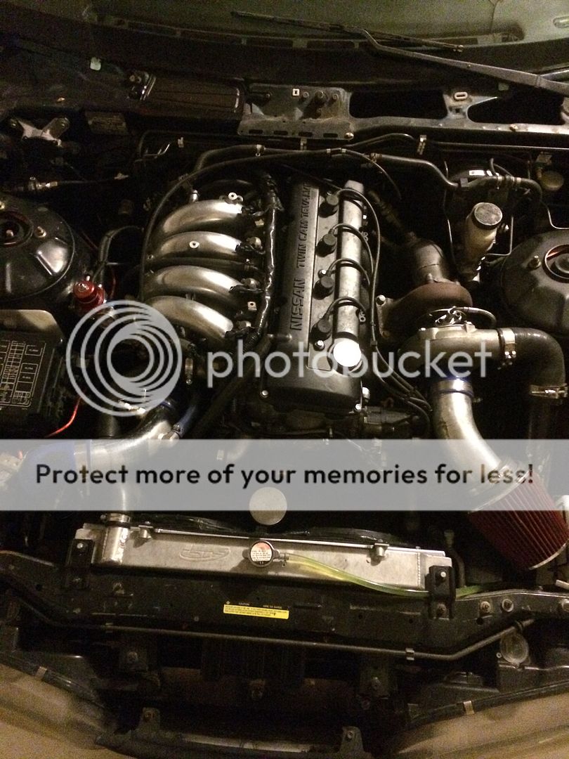

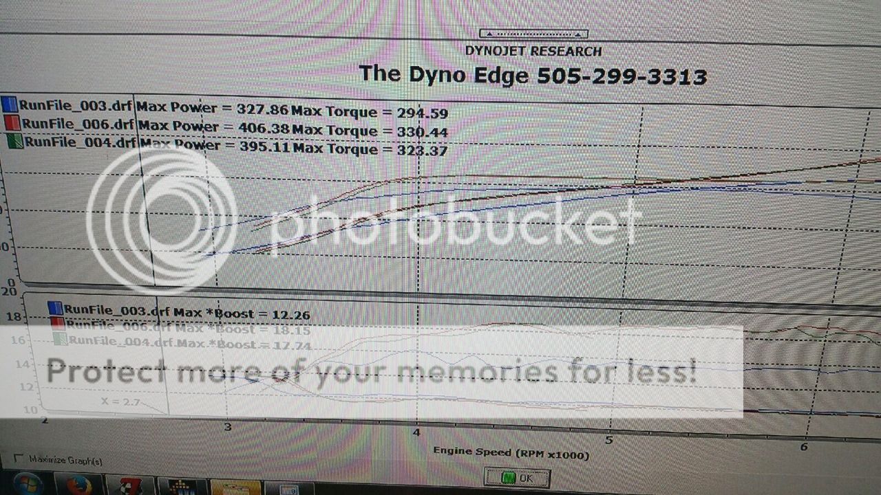

well before i sell my Ka-t engine a must dyno session it needs. made 406whp 330 torq.
total rebuild .20 over
AEM ecu
740cc injector bosch
wolf jwt S1 cams
aeromotive Fpr
forged wesco piston/rods. 9.0:1 ratio
edt mani
38mm wastgeat. turbosmart
blow off valve turbosmart
ebay piping
stainless steal valves
255 wlbo fp
garret gt30
3 inch downpipe with catback.

Pretty decent numbers for a gt30 @ 18psi. GLWS

Postby iamxchris » Sat Jun 20, 2015 7:46 am
I am assuming 93oct due to your injector size.
Sweet numbers, don't sell it

Thanks cris and supakat. Cris Iam on 91oct. at the end of the day I had fun with my Ka-t.
