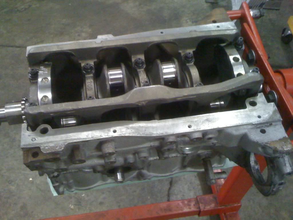

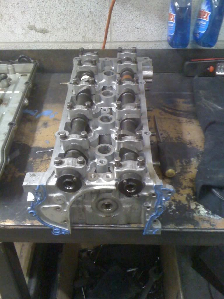

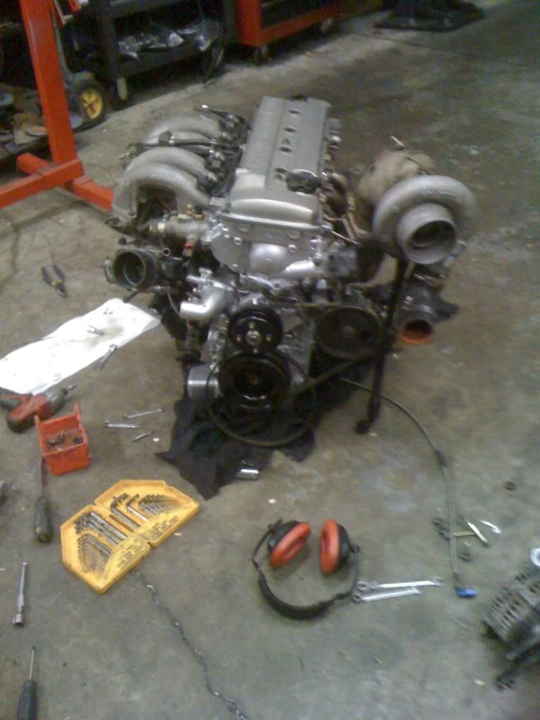

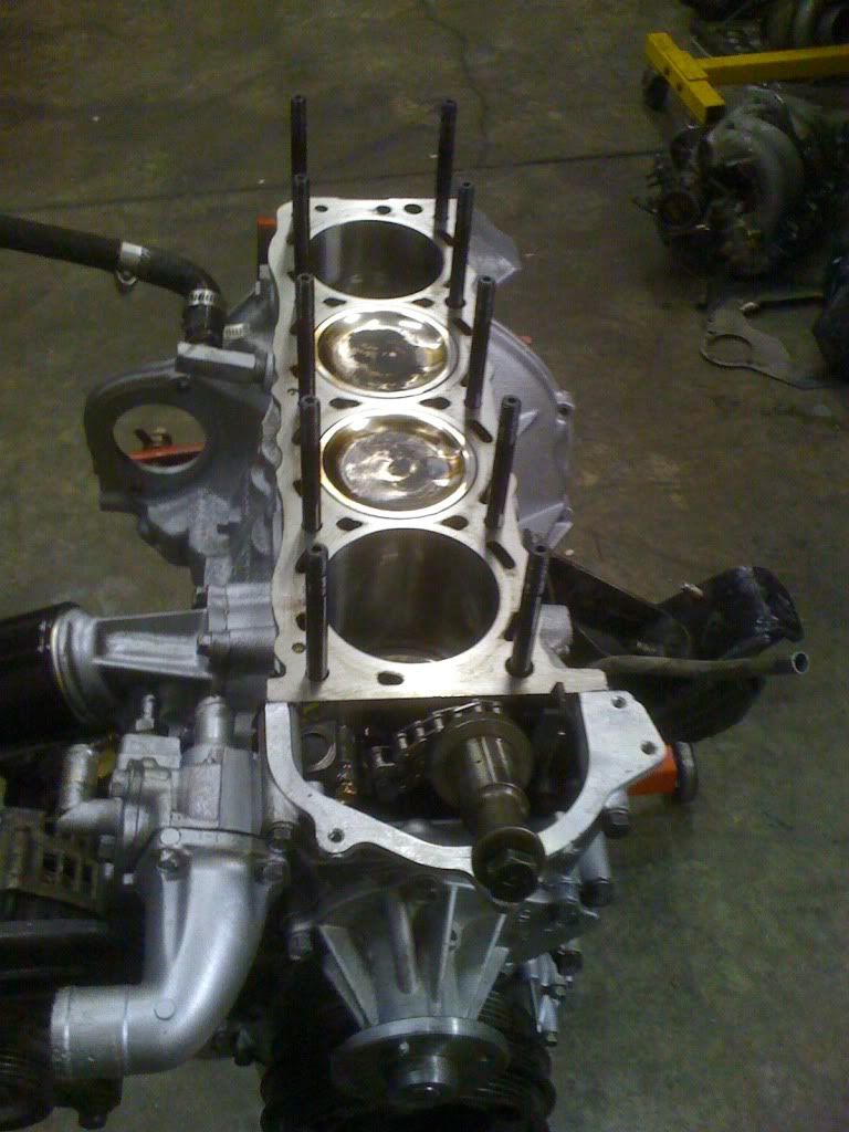

319.2 rwhp / ~330 tq @ 10psi, built KA w/hx35
Dyno Sheets/Results Only! We have a separate forum about ECU Tuning and Theory
Postby ka-t240sx » Tue Nov 06, 2012 12:28 pm
-CP pistons 8.5:1 iirc
-Eagle rods
-BC valvetrain minus valves
-Stock intake manifold. (kinda wanna try the xcessive one, opinions?)
-BC 272 cams
-Holset hx35 w/12cm^2 exhaust housing
-Turbosmart 38mm external wastegate w/8 psi spring
-3"straight pipe to dual 4" tips
-clutchmasters fx400 clutch
-MegaSquirt v3
-760cc side feed injectors
-LS coil packs w/MSD 8.5mm wires
-arp 11mm head studs
-94 octane pump gas
-bkr7e, gap @ .028
*sidenote: theres alot more im probably forgetting and im doin this on my lunch break, so i don't have alota time at the moment, sorry. but If ya'all need anymore information just lemme know.
I've had a few stock ka-t's i can try to remember the specs on them too if wanted.
might have a dyno graph or two on those ka's.
graph.
