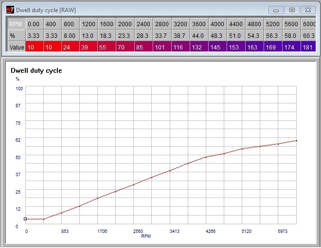

What's your injector duty?? What maf you using? Obviously something is holding it back. 550cc are small but they should max around 350whp, on pump. A OEM maf wont let you boost high.

I don't exactly know the duty cycle. They did everything but I plan on looking at the tune today. I had to drive 3 hours to get home after 8:30pm, hit traffic, and ended up home at 1am. I didn't even think to look at the information.

I apologize. I'm a noob but i'm learning. This is what i found on the duty cycle. If i'm reading this right, there is a bunch of room left. IIRC, I remember them saying it was leaning out on the top end and they couldn't getting it to enrich. I could be wrong on that though. I really need to get them to email me the issues so i can post it here.

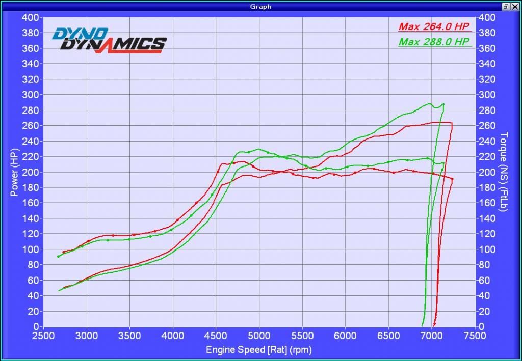

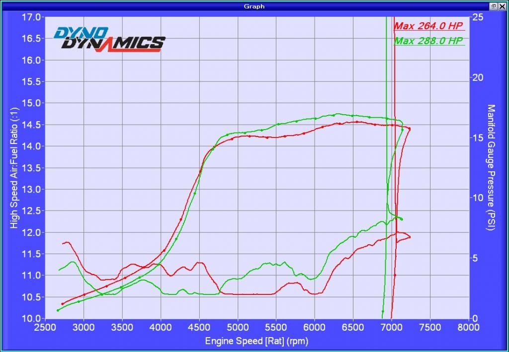

Here is my dyno results they gave me. From what i understand, the tune on the car made 272 but this is what they sent so i'm not sure what my car makes at this time. Either way, this is what my car did. It looks terrible compared to other graphs. I wouldn't mind peoples opinion, whether it's good or bad.

Looks like your hitting full boost at 4500 which is not right for the turbo you are using. you should be hitting full boost at 3500. Timing seems to be the issue try going to another tuner I know it sucks dishing out another $400+ but you should easily be making 400whp I still think you should go wit bigger injectors and max the turbo out!

I know the graph doesn't show it and being this is my first boosted car, when the power comes, who cares about low end! This thing flys!! I had a 02 camaro ss with a 75 shot and this 40 would have come close to, if not out ran, that old car. I just hate that it's so jumpy on the graph. I know if corr had time to work out the bugs, they could pull more power and it smooth out. I should have had the car ready for them but I didn't fully.
I agree with R34SR that I should have started out stock and worked up. My next build, I will use that advice but I do feel I'm so far along with this one, I'd rather keep pushing forward. Thanks for the advice.

From 4700 to 5700 there's a big issue. do you have a wideband? If that graph is correct its rich before 6500rpm which causes power loss and lag.

RosadoRacing wrote:From 4700 to 5700 there's a big issue. do you have a wideband? If that graph is correct its rich before 6500rpm which causes power loss and lag.
They had issues getting things to work out right on it. I think the major cause was i had the stock 240 sx filter in and not the 300zx filter. They couldn't get the fuel rich on the top end and it was running a little lean. I think they may have changed a setting which cause the issues in the middle to feed the top. I'm going off of memory here and I had been awake since 6am that day and the tune was finished at 8:30pm and I drove home. They emailed me a tune a few days ago to see if the top end would enrich with the new filter I installed. They want to see if it changes. If it does, a few more hours retuning might solve tons of problems.

If they had such a issue with the fuel being lean why is it 10.6 afr down low which kills the spool??

RosadoRacing wrote:If they had such a issue with the fuel being lean why is it 10.6 afr down low which kills the spool??
That is what i was trying to figure out. Everything I'm saying is what they told me. I might not know much about tuning but i can compare other tunes to mine and i noticed differences which brought up these questions. If it leaned out on the top, why make it rich in the beginning? I don't know if they tried to change the setup so it would read richer on the top end so they could get more power but caused it to be over rich on the low to mid. If that's the case, that would cause my choking on the bottom and mid but full power on the top end. If that's case, i would go back and it would be like starting all over again wouldn't it?

AN OTHER consideration is the dyno calibration. maybe the dyno you went on is really offset on the low side. I've seen more dyno offset on the highside. usually. (i know a local shop here that renoun for giving false higher number... aka sti with 450whp when they prolly have more like 350whp)
I'm using a 3.692 rear diff from a q45 and I have a 300zx n/a trans waiting for installation. I have a 350z stage 2 Jim wolf clutch on a chromoly steel r32 flywheel on the car so it will hold up to 500 ft lb of torque so I can push the injectors and turbo all I want.
I think I'm going to keep the kelford cams because I started with them, might as well finish with them. Their dyno reads low. On a mustang or Dynojet, I would have pulled 300whp easy but I could have much more with some timing done right.

I don't see it mentioned anywhere but did you upgrade the fuel pump?
If not that's most likely why it's leaning out at the higher RPMs.
I also have to say those low RPM afr numbers are horrible and there is no reason I know of that it should run richer at low RPM to allow running richer at high RPM. This isn't a carb that requires compromises like that, everything should be adjustable across the entire RPM range.
Absolutely changed the fuel pump. Sorry, I forgot to post that.
I agree on the afr being crap. I will bring all the info I'm getting from y'all to them so I can get an answer as to why it's so terrible. I'm sure, as most shops would, they will try and correct their mistakes and tune it must better. I'm being patient because they have been patient with me on a few things. When I get some money ready, I'm gong to set up a retune date. This way, after it's all done, they don't have any excuses, and I won't pay if it's not right.

I think your cams are out.
You should be makin way more tq at low rpm. At least 200 at 3000rpm.

RosadoRacing wrote:Leave the kelford cams I don't know why there saying go with stock cams not bashing anyone but the stock cams suck.
It was only suggested to go back to stock cams to eliminate the possibility of cams being the issue (degreed wrong/not at all/what have you).
You said you had the tune emailed to you, think you could open it up and take some screenshots of the fuel and timing tables?
I will jump in to say that if you have Nistune, you should really look into learning the tuning basics yourself. It will save you a LOT of money. I realize you don't have your own dyno, but you can still tune for fuel with your wideband and timing can be done on the street with a knock light.
Crossing my fingers you get this figured out. However judging by the whacky rich AFR down low, I'm going to blame the tuner for a lot of the problems. There's a good chance your plugs could be fouled too.
Post by sdaigle240 » Mon May 20, 2013 9:47 am
hope i didnt skim over it but id like to see the timing table. just looking between 4700 and 7k you can see the missing timing in the shape of the curve..... IF the mechanical timing is correct.

huffman made 223 on 8psi from a z31 turbo, very conservative timing wise and very rich. I used the simple 1degree per psi timing retard, street tuned.
NateDogg
Posts: 993
Joined: Fri Feb 11, 2005 4:31 pm
Location: BC CANADA
Post by NateDogg » Mon May 20, 2013 12:39 pm
When you ask someone to tune a car on pump gas they are going to be conservative. There isn't much margin for error on pump.
Depending on octane, I would add at least a couple degrees from 4000+ to get a more linear powerband but overall it's not bad considering the low reading dyno.
Best way to judge power is to take it to the track and see what MPH you get in the 1/4.

I'm still on board with the boost leak or other issue. It's not right. Personally I can't comprehend the spool and tune issues with my personally experiences. I've had a cracked manifold and spooled well before this....with boost leaks to top it. Something is not right..PERIOD.
