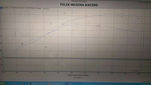

I finally got my KA-T back up and running after almost 4 years, did some dyno tunning last Thurdays and made 625@ 26psi with a conservative tune on E85. My goal of 700hp was cut short by my PTE 6765 billet which started making noise after a few dyno runs so I decided to leave it at that(turbo ended up crapping out last Sunday @ ATco raceway). I will slap on an old 70MM cast wheel turbo I have laying around so I can keep dailing the car in at the track.

s14fiend wrote:Nice work.... any videos ripping up on EVOs or other cars? What does the car weigh in at?
Unfortunately don't have any recent videos of the car just old vids from 4 years ago with the old setup.
The car weighed in @2540lbs without me in it when it was a street car, now it should weigh 2400ish and I have more unnecessary stuff to take out of it.
The plans are to going with a bigger turbo and make 800hp+ but I would like to dial the car in with the power it has made so far before I try to make more power.
This thing spun 1st-4th gear on 26x10 slicks last Sunday at the track.
The boost did shoot up to 33 psi on the track for some reason.

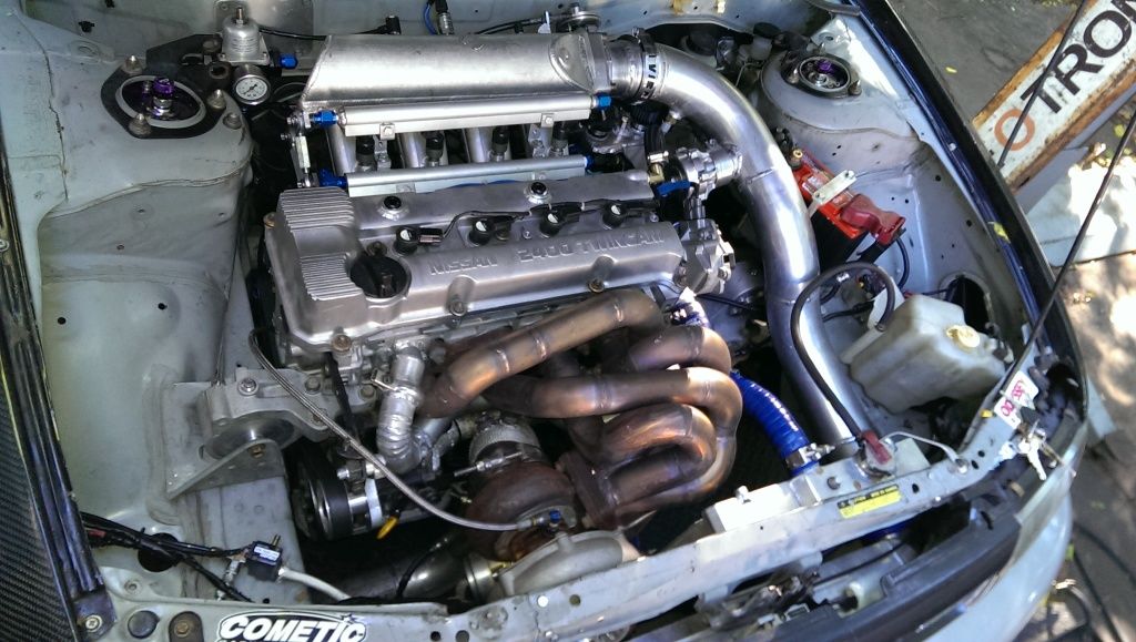

The rev limit is set @ 8500rpm, I also have an ATI 7" damper to help counter act crank vibrations. I'm running a stock style Altima trans with PAR 1-4 dog engagement gears, billet cuff and billet final drive. I also have Quaife diff and a comp twin disc.

I'm running an M&W Pro-14 box with these CBR coils.
