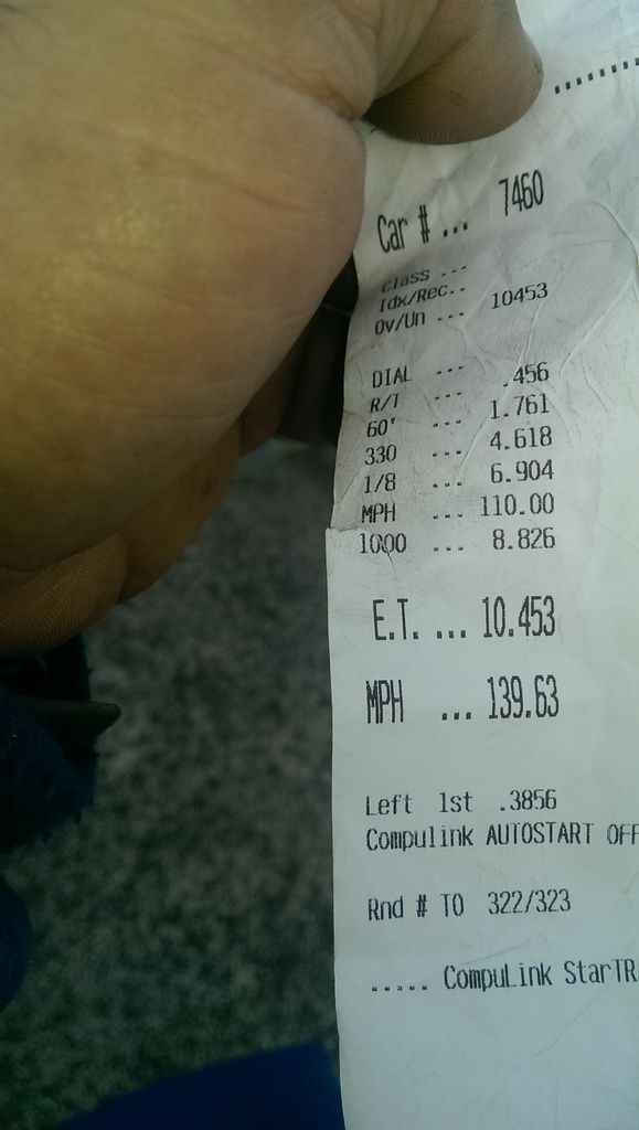

I decided to start messing with my car this past fall after a 2 year rest..
We had a few fruitless track visits but this past Sunday 12-20-15 finally had a good day.

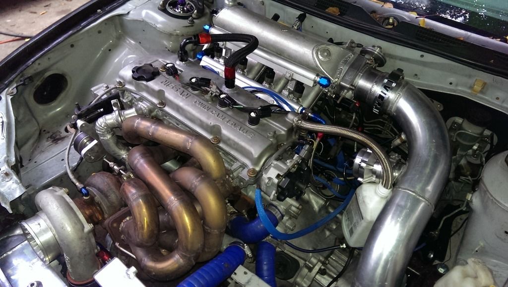

Motor:
Wiseco 9:1 pistons
Pauter rods
BC STG 3 cams
Ferrea retainers and springs
Ferrea valves
mild ported head
AMS prototype intake manifold
Turbo manifold fabricated by me
Old Innovative Turbo (unknown Specs) 70mm wheel I think
TRANS:
Factory Altima Welded/Reinforced cases
Quaife ATB Diff
PAR engineering 1-4 dog set
PAR engineering Final drive set
PAR engineering gear cuff
Gforce shifter with custom adapter plate and linkage
Comp Twin disc
factory axles for now
Fuel:
Pump E85
Twin Bosch 044 pumps
Weldon regulator
4 Bosch EV14 2200CC injectors
4 MSD 96lbs injectors (not working now)
EMS:
AEM series 2
M&W ignition box
Honda CBR coils

Track conditions were not optimal that day, 40F outside.

Awesome car and VERY impressive time slip. Congratulations!
Are you using a strain gauge for faster shifting with the dog box trans? It didn't look like it from the video, but I couldn't really tell.

adamky wrote:Awesome car and VERY impressive time slip. Congratulations! Thanks bud!!!
I'm not using a strain gauge yet, I'm still trying to get used to the car. Once I learn how to control it better I can concentrate on shifting faster. You can see how the car pulls hard to the right in the videos.

Looks like your taking it up to about 8200? Great run bro hope to c u next yr good luck

RosadoRacing wrote:Looks like your taking it up to about 8200? Great run bro hope to c u next yr good luck
Thanks bro!! The limiter is set @ 9000rpm but I shifting around 8500 because that old turbo runs out of steam. It used to pull higher when it had the PTE 6765 billet.
