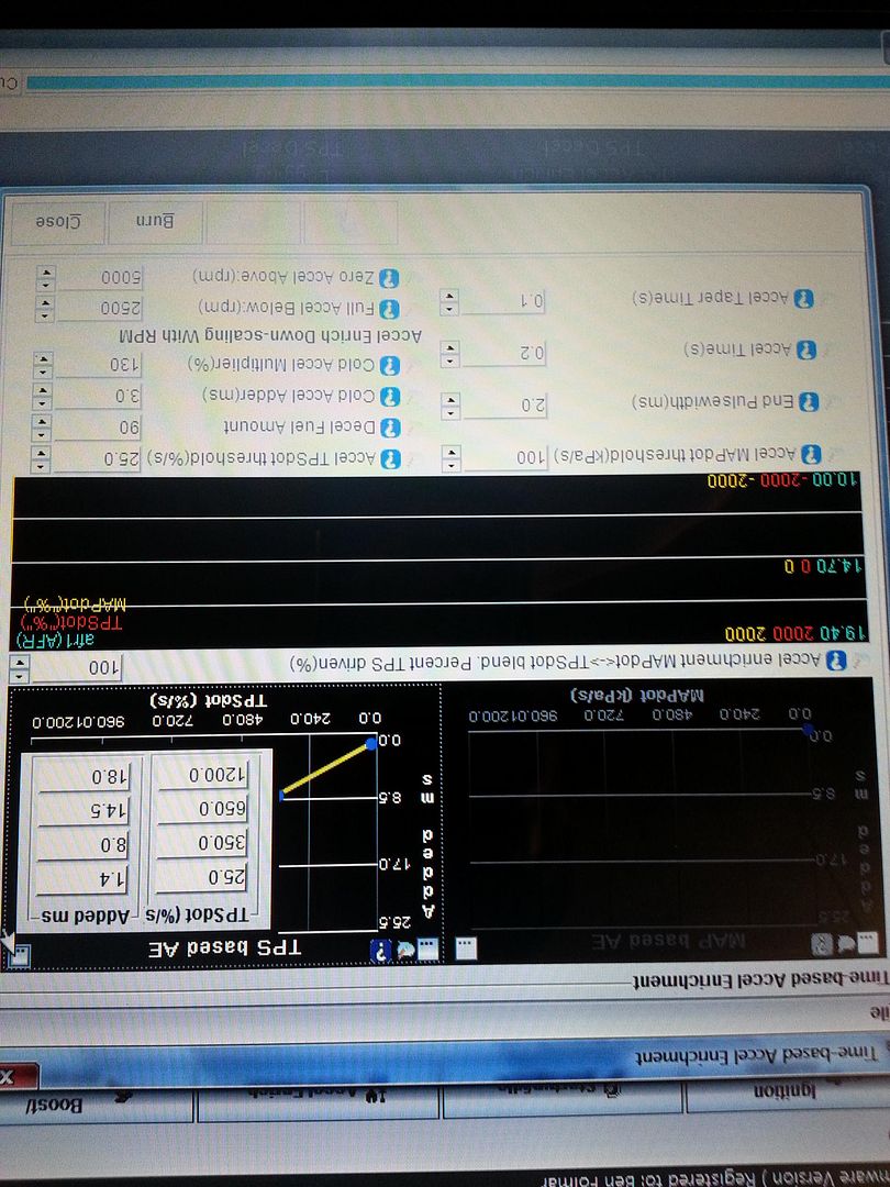

Postby 91boostedb20 » Tue May 20, 2014 6:30 pm
I tried those settings tonight and it didnt like them at all, it was lean spiking real bad and the throttle response was terrible. Here is a screenshot of what im using now, its very different than what you posted. I also added some fuel in the lower rpm area in the higher load ranges and that seemed to help alot.
