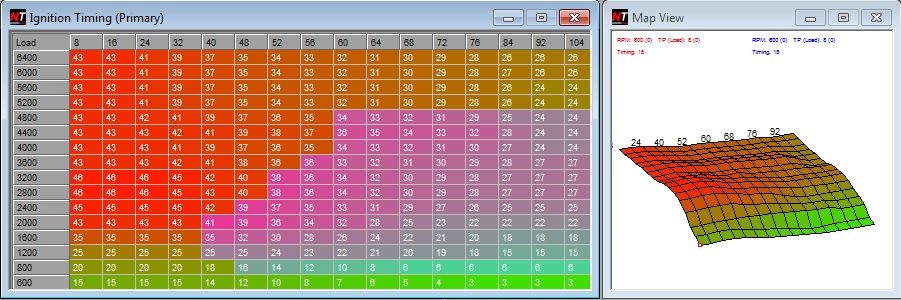

This is a timing map for a S13 KA24DE:

Post by Adrenalin » Wed Jan 13, 2016 1:22 am
Thanks Adamky, your the man.
This a stock curve or modified?
Cheers.

Post by adamky » Wed Jan 13, 2016 2:43 am
Stock map

Post by Adrenalin » Wed Jan 13, 2016 3:22 am
Thanks that's great.
Wow, It has a lot more advance down low than I was expecting.

Post by adamky » Wed Jan 13, 2016 12:10 pm
Let me double check it but I'm almost positive that's the stock map.

Post by BigLoukaT » Wed Jan 13, 2016 3:49 pm
Meant to respond but never got there. I would feel comfortable using the ka24de map as a safe start. The combustion chamber design for the single jingles dictate that we will have a few degrees more advance than dohc kas. For reference, peak torque and 0 psi, I run 26 (or maybe 28) degrees (where the dohc shows about 24).

Post by adamky » Wed Jan 13, 2016 3:50 pm
According to my notes, that is the map for a '91 KA24DE manual trans.

Post by Adrenalin » Wed Jan 13, 2016 8:50 pm
No that's great. Not doubting you guys, I was just a little surprised at the the amount and quick increase of advance at low rpm.
Excellent info. Many thanks. I'm sure this will help.

Post by tchida14 » Fri Jan 15, 2016 10:36 am
Great, now I have something to base my single cam maps off of, not just random guessing! 8)
How does the load relate to psi or kpa? Any conversion that would be useful?
EDIT:
My only concern now is the drastic differences I have noticed in the mid rpm, mid load range compared to my map that I beat the crap out of with no reliability issues or signs of detonation.. After translating that map to my tunerstudio map, I am seeing up to 10 degrees difference and more in other places. I do know that I didn't translate that map as seen above perfectly over to my 12x12 map, but that is a big difference in timing, big enough where I lowered the majority of it by a few degrees. I will attach the tune that i modified from the stock one provided in this thread so you guys can take a look if you'd like.
