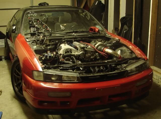

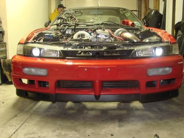

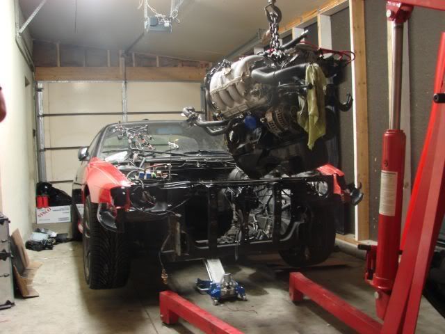

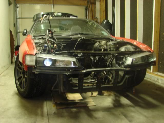

Post by Turbo24sxt » Thu Feb 01, 2007 5:14 am
Alrighty well i just got done working on this car for like 7 hours tonight and here is where I am
here is where I started
and then here
then then got it here
and then put the snail on
and then made a new cold air intake for the snail (not yet complete)
the filter in bumper
and then the mounting of the hide and seek intercooler
and then finally where i left off ....
MORE TO COME TOMORROW!!!

Post by TanManS14 » Thu Feb 01, 2007 5:31 am
Nice man. Where did you hoist the motor up from? I was thinking about trying to put the motor in with my turbo setup installed, that way pulling the oil pan off wont be such a bi*ch... and I could just run my oil line's and everything before hand.
joshds25
Posts: 1005
Joined: Sun Oct 16, 2005 5:47 pm
Location: NC
Post by joshds25 » Thu Feb 01, 2007 6:54 am
TanManS14 wrote:Nice man. Where did you hoist the motor up from? I was thinking about trying to put the motor in with my turbo setup installed, that way pulling the oil pan off wont be such a bi*ch... and I could just run my oil line's and everything before hand.
You will wanna use 3-4 thick washers and a lil longer bolts to run threw the chains - or get some engine hoist lifters from Nissan for $100+
Post by TanManS14 » Thu Feb 01, 2007 8:16 am
Holy **** lol. That couldnt have been any better of a response. Thanks for the help josh. :).
Post by Turbo24sxt » Thu Feb 01, 2007 11:18 am
yup that is exactly where mine was hoisted from ... it sets the motor up perfect to drop in ...
