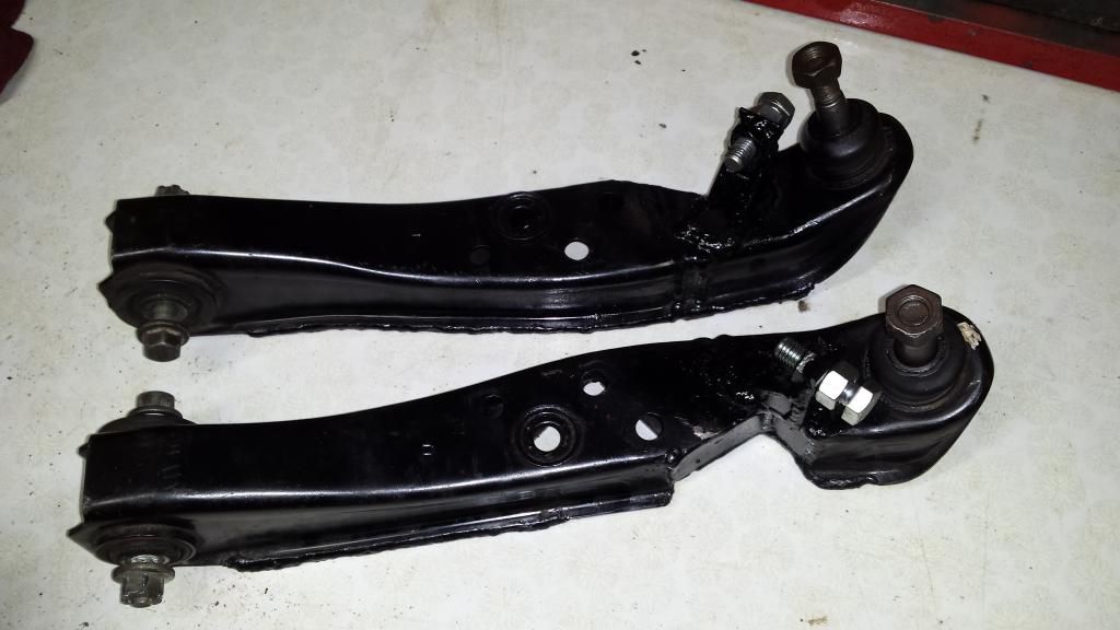

Re: Daigle’s S14 - LCA's extended, notched, boxed and stoppe

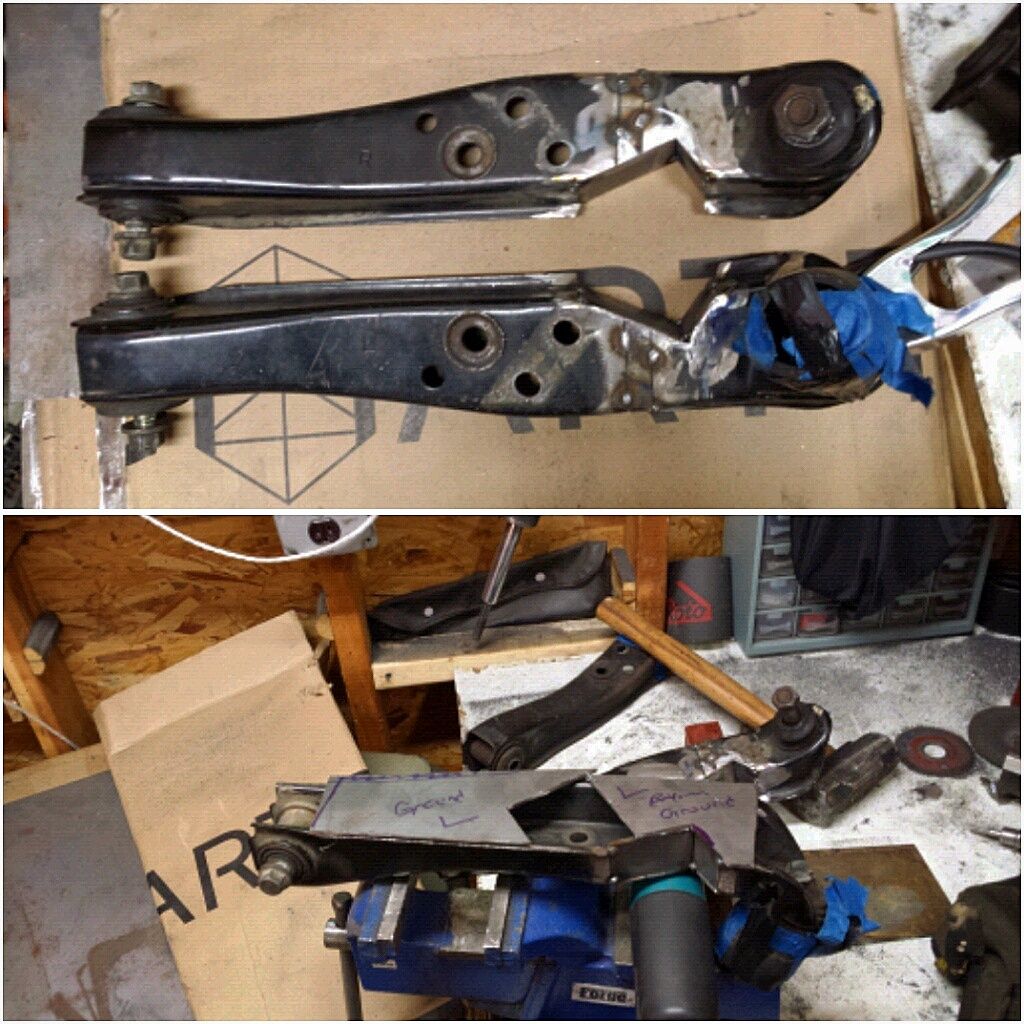

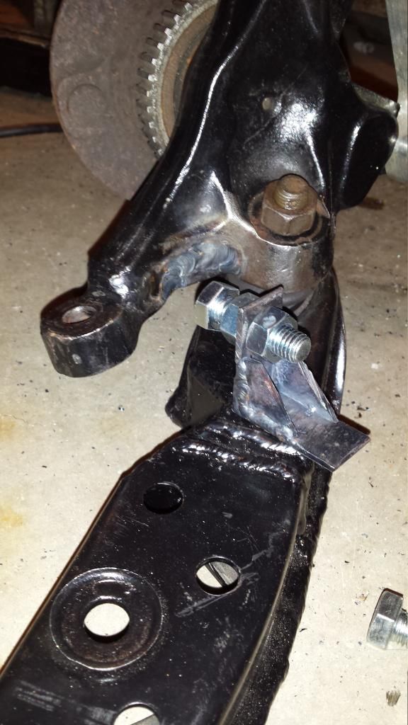

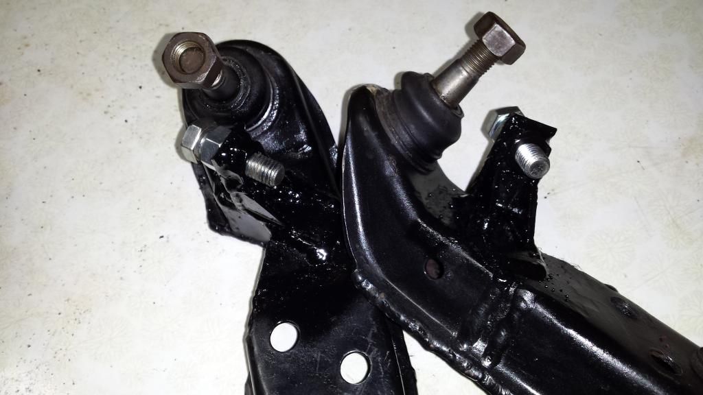

LCA WErK
added 1/2", box'd n notched'd, adjustable stopper and added some meat to the knuckle to accommodate it.
Re: Daigle’s S14 - LCA's extended notched boxed adj stops
Nice work. I see you are really enjoying the car now more than before. Keep it up.
thanks supa! yeah i really like to tinker and fab, apparently almost as much as driving the thing! ...i am missing events though but hey motivation struck me and i went with it. Im skipping the tubs for now, between time and them not seeming completly necessary ill just save it for another project. i really want to drive but i also really want to stuff in a welded diff and mod my subframe bushies into risers. so another projects already lined up.
really cool fab work you've done here ! cant wait to see how the lca mods affect things
thank you kind sir! im going to hold off posting the picture untill its all bolted down but its got pretty serious angle. Im most excited about the reduction on turns lock to lock. from about 3.25 to 2.5 so that should translate to a lot less wheel input while sliding. thats why **** takes me so long. overthink overthink overthink execute and enjoy.
yeah it might also be something to get used to if you've drifted the car before! I can imagine that would make things easier for sure

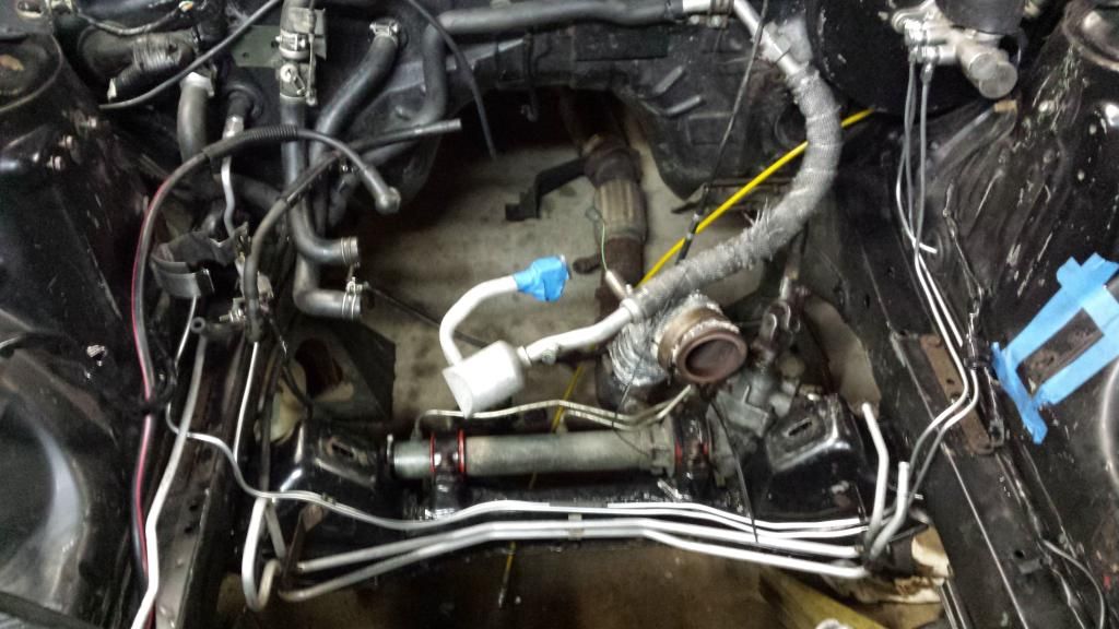

sloooowly making progress. brake lines done, just gotta insulate with fuel line and adel clamps. also working on fuse box relocation. box is going half in the bay half in the fender well. all cut out and fit up, just extending a few wires and need to build a metal box off the chasis to keep the back side of the box out of the elements.
m10x1.0 to -3AN fittings with -3 tube nuts and tubes. using a ridgid 37* flare tool.

Re: Daigle’s S14 - Tucked Brake Lines w/Banjos 7/8/14

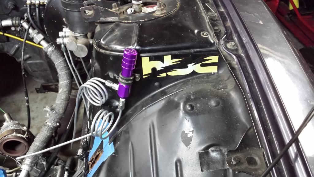

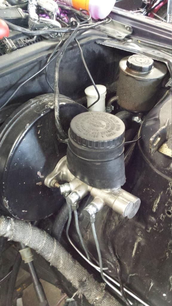

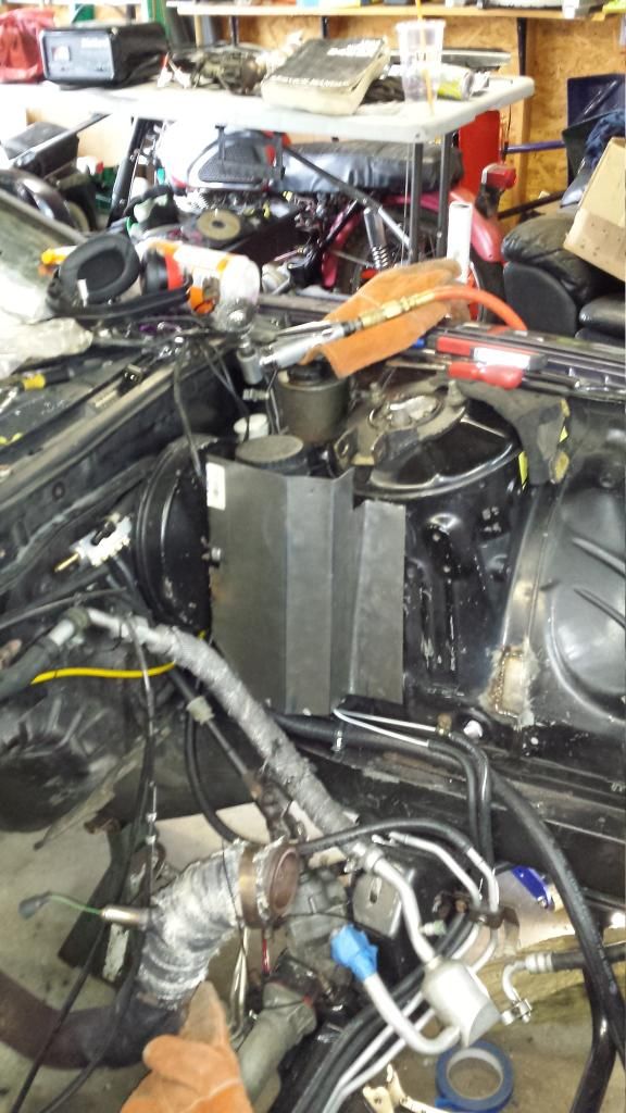

hard lined the WG setup

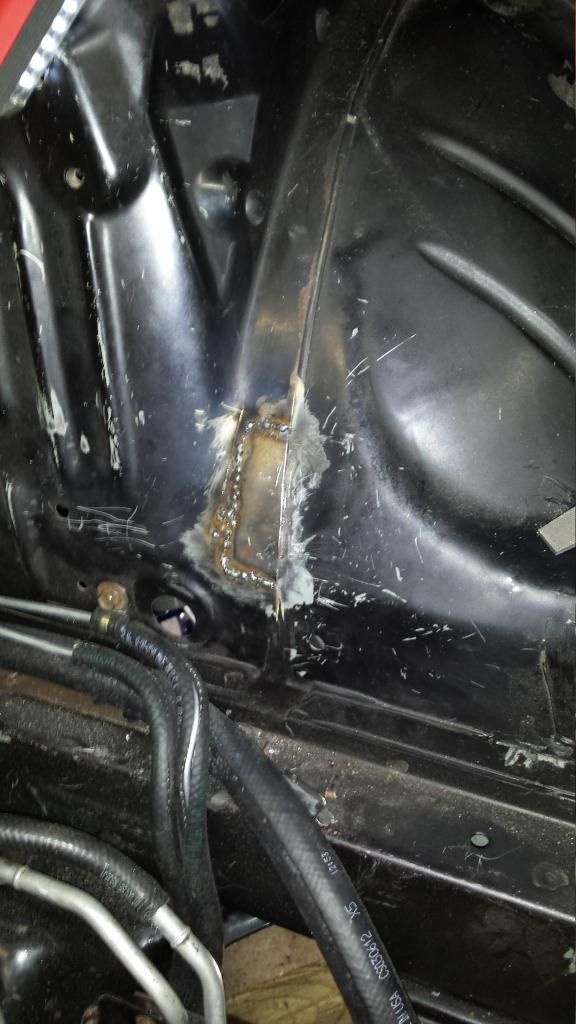

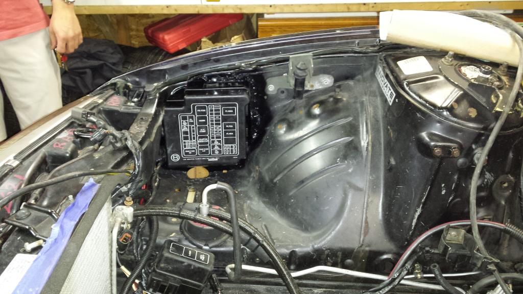

Fuse box relocation - tight everywhere but clears everything.
some light tint on the headlight.... do like.
moved the PS Res. also tight everywhere but fits mint

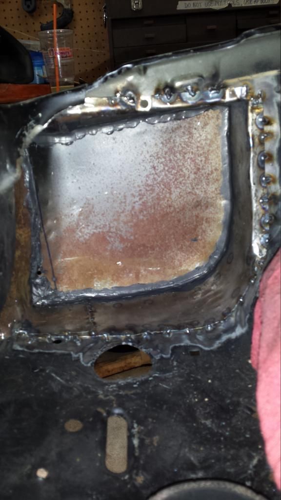

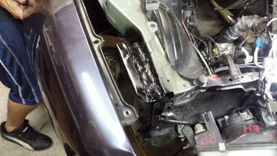

typical rot spot. all fixed up now.
redid the brake shield. lil more triming
Re: Daigle’s S14 - Fuse Box & PS Res Relocated, rot repair 7
The fuse box relocation is very innovative. Tucked out of the way but still accessible. Pimp. The PS relocation is great too. There's a lot of wasted space in that area and that's a good way to make use of it. I can't believe I've never seen anyone else do that before.
Don't be surprised when you see me copying some of your ideas! Keep up the good work.
Great work daigle! Finished product is gonna look clean. I still amazed on the fuse location. Sick.
Thanks my Doods! hey have at it, i throw my twist on things but of course get the motivation from other other smart bros. props to my bro toby (i think altimaDET) for showing me the fuse box location. i just live in new england and wanted to have it all sealed up. the PS idea i dunno but saw it somewhere. just grab a spare stock 10mm bolt, about 1.5-2" long and tack it to the flat sheet metal under that corner. i used a stock s13 res (obviously) and made use of half the stock bracket. i cut of the larger of the two tabs and made use of the rubber insulated bushing thing on the smaller tab. threw a washer on the bolt then put the reservoir and bam, tight tight, yet insulated. with out the washer it was pretty floppy.
Haha brotivation. I like it. It's 6AM here and now I'm going out to the shop to straighten up for when I get home from work this afternoon...for tonight...I (may) dine as a KA-ter!
I love seeing this kind of stuff in builds. Fuse box is ace. On the brake banjo bolts, did you use copper washers? If so, did you feel it necessary to true up/flatten/machine the "face" of each outlet, or do the threads seal it well enough?

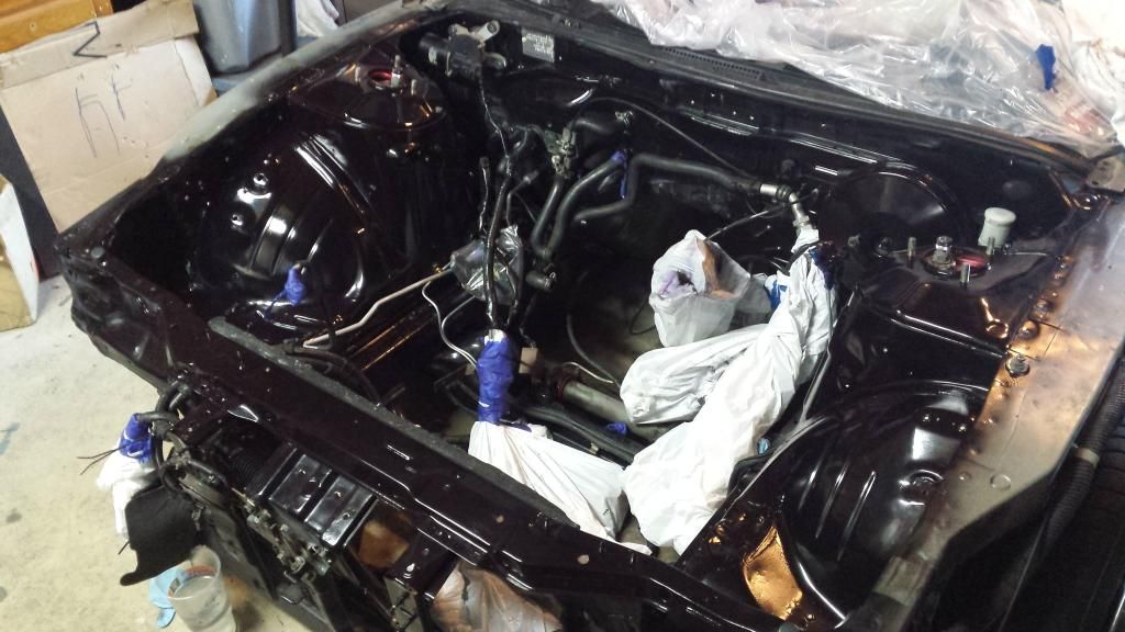

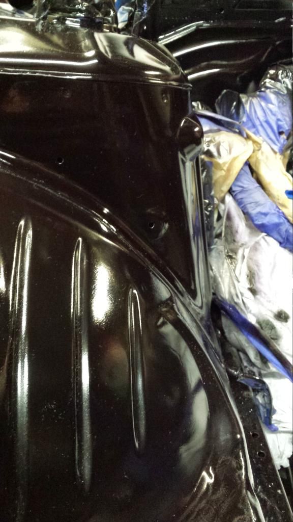

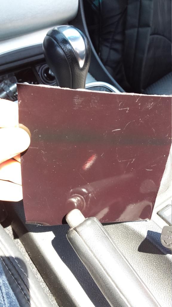

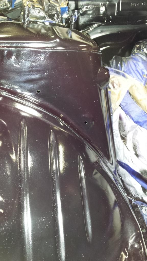

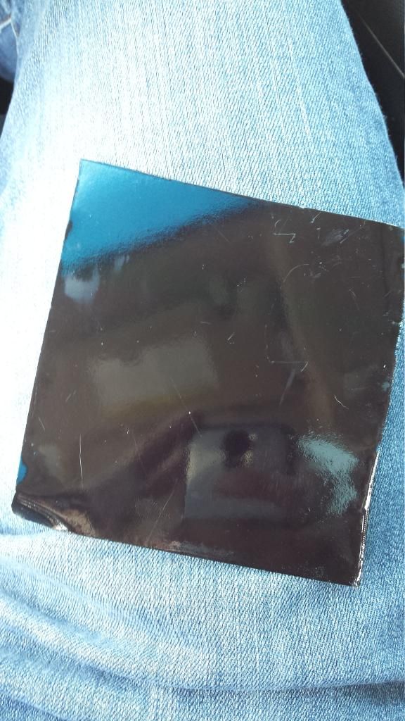

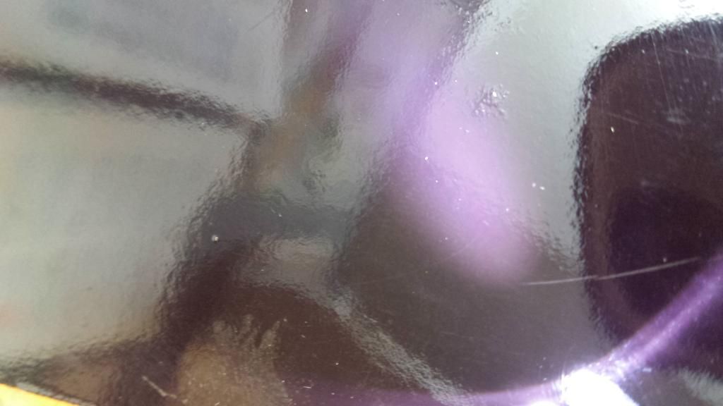

same paint, different angles and lighting.
duplicolor gloss black caliper paint
metalcast anodized transparent purple (2 dustings)
gloss
wet sand
wax
**** is wild... constantly changes appearance. you may spot what appears to be imperfections in the purple application but its actually just lighting. a small dimple creates a very different look than the metal adjacent to it. i love that it pretty much looks black, untill further inspection.
between this and my truck bed liner idea years back im like the **** rattle can sensai
gloss
wet sand
wax

Re: Daigle’s S14 - Painted Bay 7/22
thats enough wet sanding for me. bahh that **** sucks. i see how you could just keep going but good enough for me. here she is kinda waxed.

the mods turned out awesome. my car gained insane turn in grip. i think my drift car would do really well at autox with some meats on the back right now lol. definitely feels more agile than how ive autox'd it years ago. the faster steering ratio is awesome, i just cant get over the way it progressively gains grip the harder you turn in. it all makes sence, i added 2 more degrees of camber, which translated to more contact patch while turning (and less while driving straight lol) and i can feel it. the front end felt amazingly planted and really handled the added shear from additional angle without washing out or anything. my old poly rack bushings were hammered by the end of the second day so i got some PBM alu ones on the way. i was also pleased to see they DONT RUB! well they rub on the frame rail above the tire but i call those my "bump stops" lol. 17x10 +0 with a 1/2" extended LCA at 4.8* camber, ~8.5 caster.
unfortunately due to an error in my WG hardline execution i was stuck to 12 psi but still managed. also swithed back to recirc'd WG.. it had been a while, and i can shamelessly say my car sounds amazing. a kid rolled up in a kouki asked me what i had cuz it sounded amazing. i later realized he had an rb26 in his car... lol! awesome.

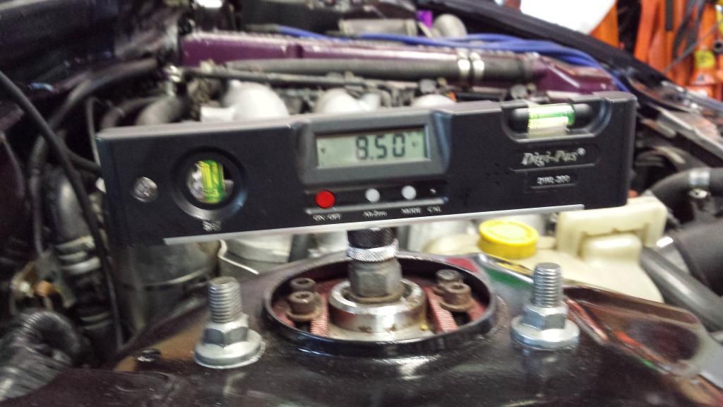

Dude YES! 12psi looks just fine. I've been streeting on 7 haha and it's been okay. And your smoke I wanna be there. ***** looks good dude.
And hey do you have a way of measuring caster? Or do you have to somewhere?

Re: Daigle’s S14 - ClubLooseNorth Event
thanks man! my caster methods are ghetto at best. my buddy has a kit but i cant seem to get a realistic caster measurement out of it (3*). i knew my caster was set to 7.8 years ago at a higher ride height (maybe 2" higher lol) so i figured it had to be atleast that. i was replacing the heims so i just added length right off the bat and adjusted till both coils read the same mean number. obviously you cant align the gauge dead straight so if you go back and forth you can get a pretty good feel for the average or center. i dont claim this to be accurate, but i do feel my caster is even and thats whats important to me. the wheel is in the center of the well anyway, much movement in either direction would cause rub. my wheel centers just fine while drifting, so wherever im at, i dont see a need for more. i like how our sport is about feel. its just whatever feels good to you, right now i am feeeelin this **** righ hea.
this is some of the more hood rat **** you'll ever catch me doing haha
