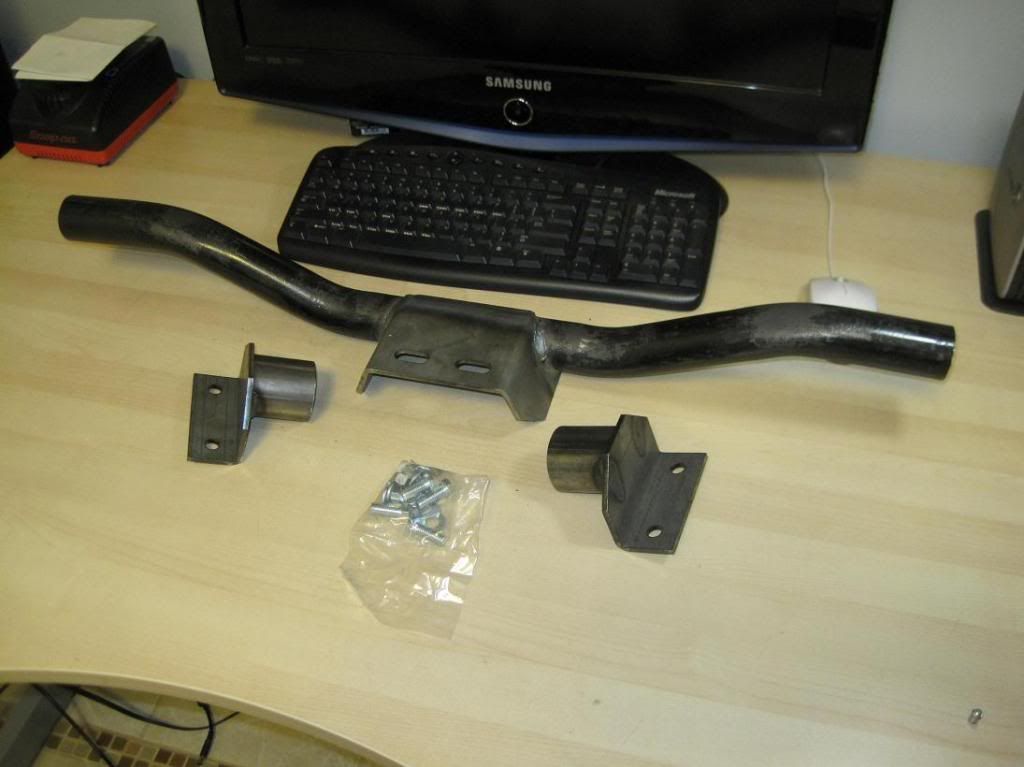

Since the Z32 transmission places the mount about 4" back, I can't use the stock X-member.
Ordered a custom one that I will modify to bolt on like the stock one.

Post by cleantune » Thu Apr 04, 2013 6:38 pm
Whoa, you did WORK on that trans! Great job. The new cross member looks nice; Same clearance as the stock cross member I'm assuming?

cleantune wrote:Whoa, you did WORK on that trans! Great job. The new cross member looks nice; Same clearance as the stock cross member I'm assuming?
Based on my measurements the Z32 trans will place the mount 4" further back, which is why I chose that specific X-member. I won't know for sure till I get it in there.
