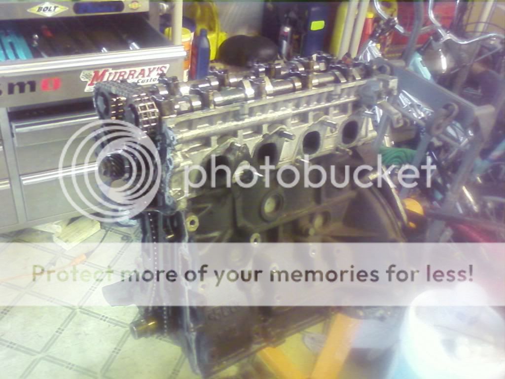

I bought this car bone stock. Its a 95 240sx Se
this is after I put coils on it

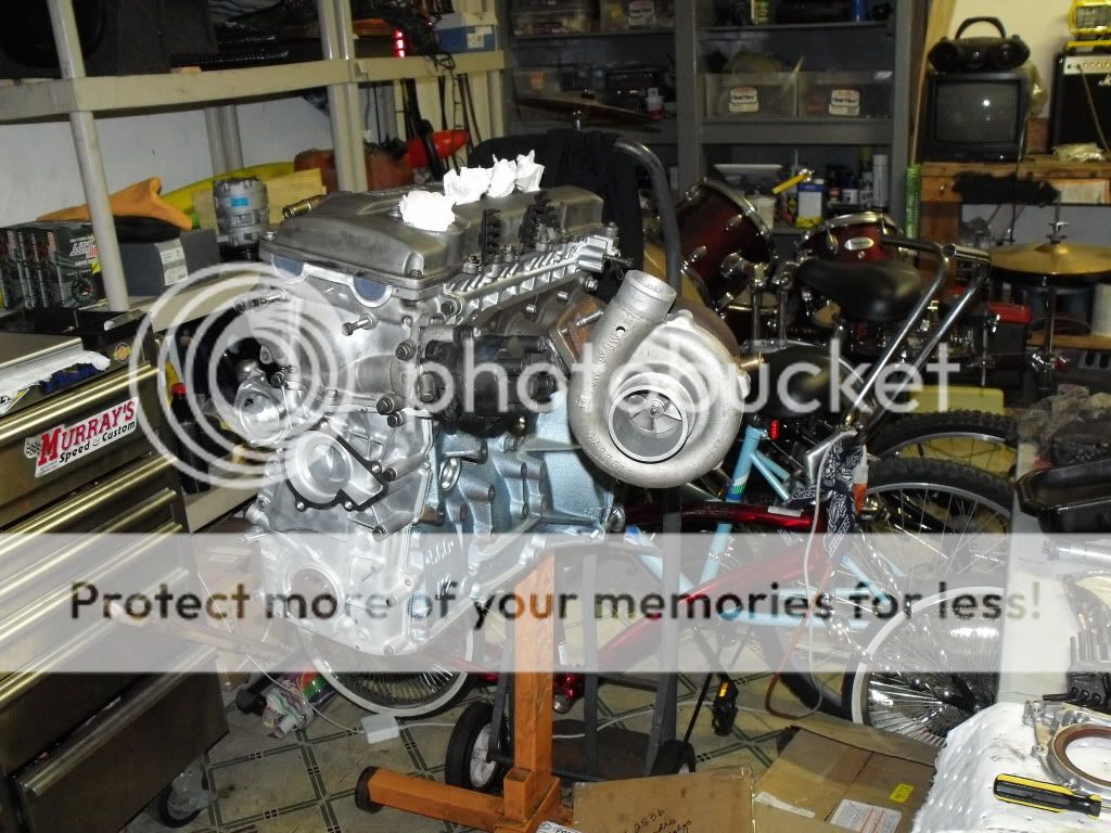

Now I rebuilt my Ka
Cp pistons 9:1 .20 over
Clevite bearings
ARP main and rod bolts
Cometic HG
Reconditioned Head
Reconditioned Rods
Bore, honed, decked, and line honed the block
Balanced the crank
Also resurfaced my flywheel and got a spec stage 3 clutch
Isis FPR, Walbro fuel pump and some other **** I cant remember right now
Also did a full gasket kit on the engine. Got new gaskets everywhere
Before and After
And soon to be boosted

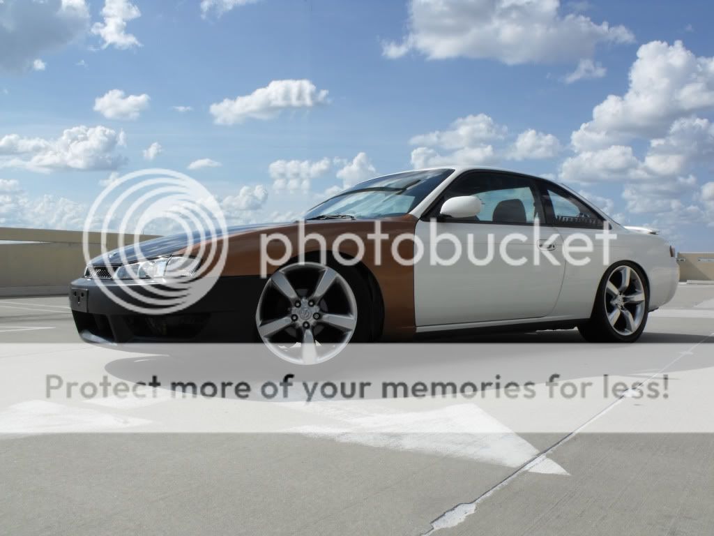

Now the car looks like this

blacks13coupe wrote:Nice. What kind of turbo is that? What kind of numbers you looking for?
Its a Garrett T3 .60 trim, I think they call it the super 60. Considering its my daily/drifter car Im looking to go about 350 to the wheels

dang im loving that brown on there.

tom550 wrote:dang im loving that brown on there.
uhhh I hate it! The guy who I got the Kouki front end had his whole car painted that color.
It was so badly painted the paint just chips off to the touch
If I'm not mistaken, a t3 super 60 supports up to 350 HP, not WHP. So you will most likely have to do other mods to make over 300whp. But the turbo should spool and respond excellently.
