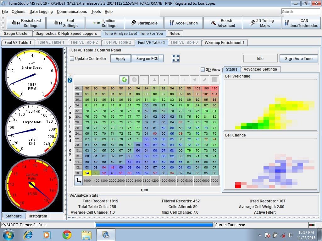

I did some work this weekend. Weled up a pinhole on downpipe and covered my immaculate welds with black exhaust wrap. But the major thing was install the billet wheel. I know this turbo will wake up sooner now. Just curious on how she will respond. Should be able to finish up today and go for a test drive.

Post by supakat » Tue Nov 24, 2015 6:58 am
As and you shall receive...lol. Yea, I just say whatever on the vids. No editing, just raw vids. But here it goes, this wheel is something else I and I have the image to prove it lol.
All around improvement but very noticeable on top after 5500. It is like VTEC hit! But proof shows that it starts spooling around 1800 @ 3psi. 30psi by 3800. I need to recheck my timing due to the tq curve shifting back. Also in the vid @ 25psi in 2nd from a roll, she breaks loose. The car is floating but going straight. I need to be careful tho.
