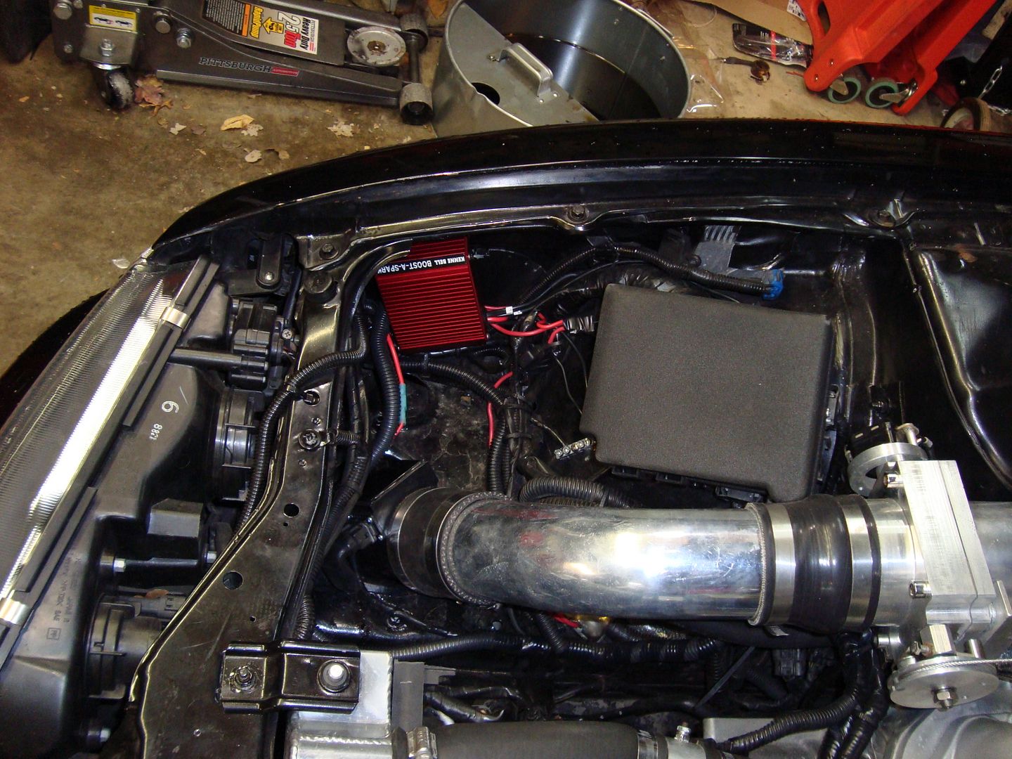

This weekend I installed my Kenne Bell Boost a spark. However, it's not working correctly so I have to contact them and see about sending it back. It isn't increasing the voltage like it is supposed to. I was actually able to get 16 volt output yesterday. Then today I check it andf I'm only getting 14.2 volts. WTF? :?

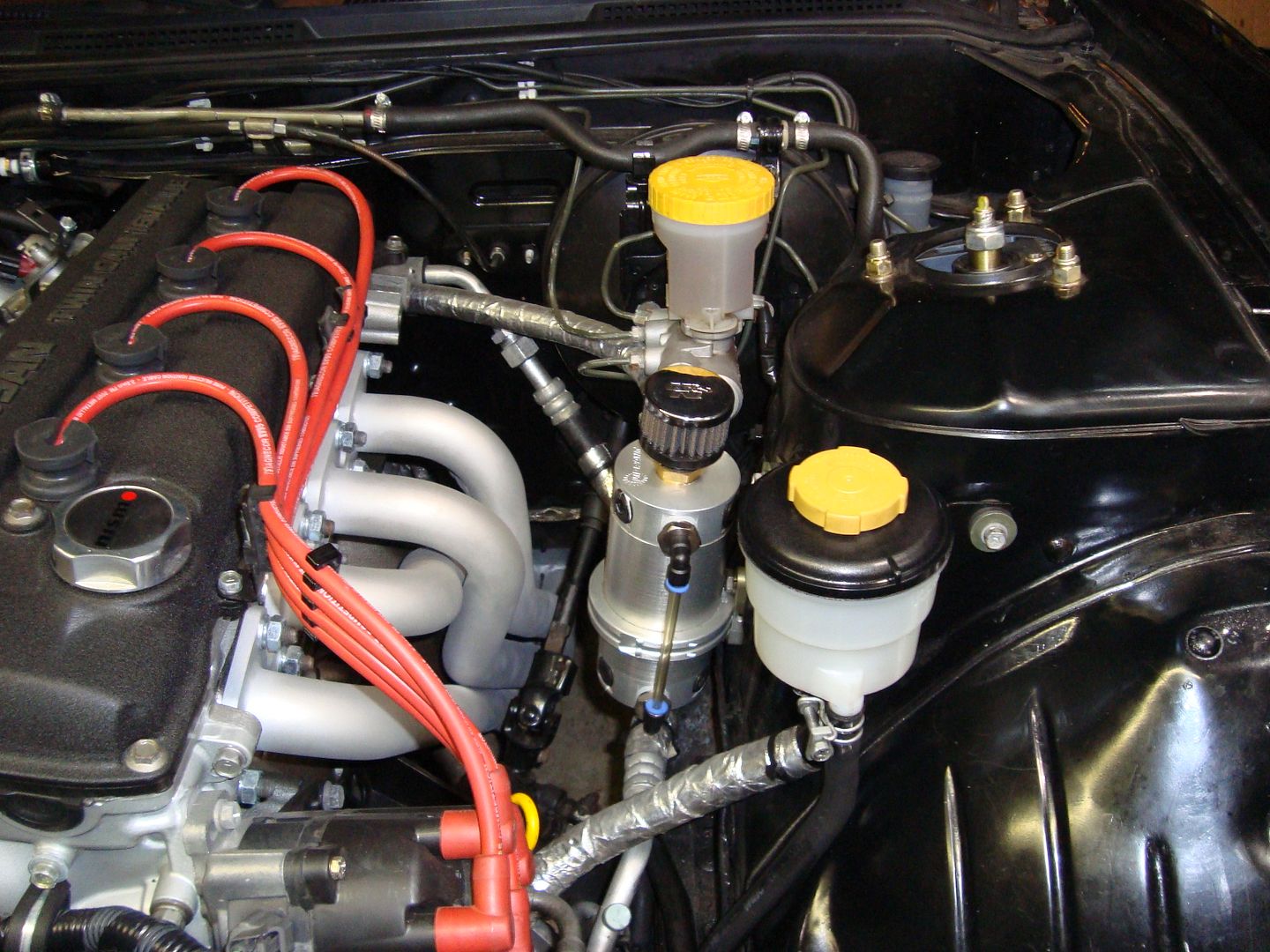

I also finally replaced my power steering reservoir with a brand new OEM one. It's been bugging me that it was the only thing in my engine bay that looked old and dirty:

Fixed my issue with the Boost a Spark. I had to bypass the adjustment knob by just connecting the two wires together. Now I get 17.4 volts to the coil. I'm running a .050" gap on BKR7E's with no issues.
