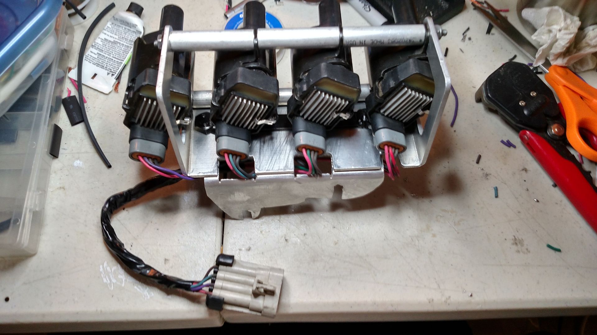

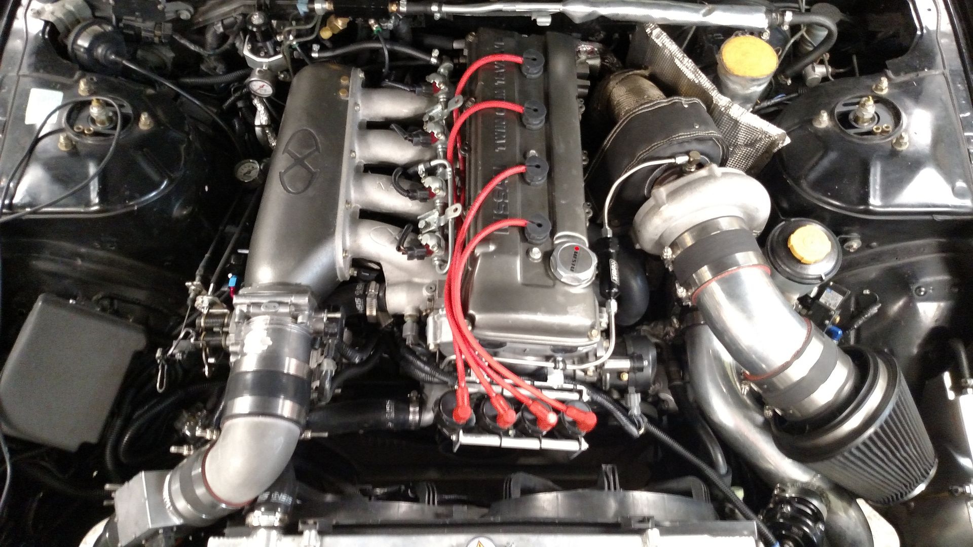

Updates! I've been adding more and more ethanol into my tank and it looks like the winter blend for this area is 75% ethanol. Not bad. I love having an ethanol gauge and I love that my ECU is automatically adjusting the tune for me. I'm pretty sure that with Nismotronic, I can set not only the fuel and timing adjustment, I can also set boost duty cycle. Meaning that my boost will automatically raise or lower depending on ethanol content.
Back to work on the Nismotronic upgrade. I decided to just go straight to the LS2 coils and will sell my VQ coils. Here's a quick bracket I fabbed up that will attach to existing screws on the upper timing cover. And then I will take my coil bracket and screw it to that plate. Wiring can be hidden behind the bracket on the valve cover.

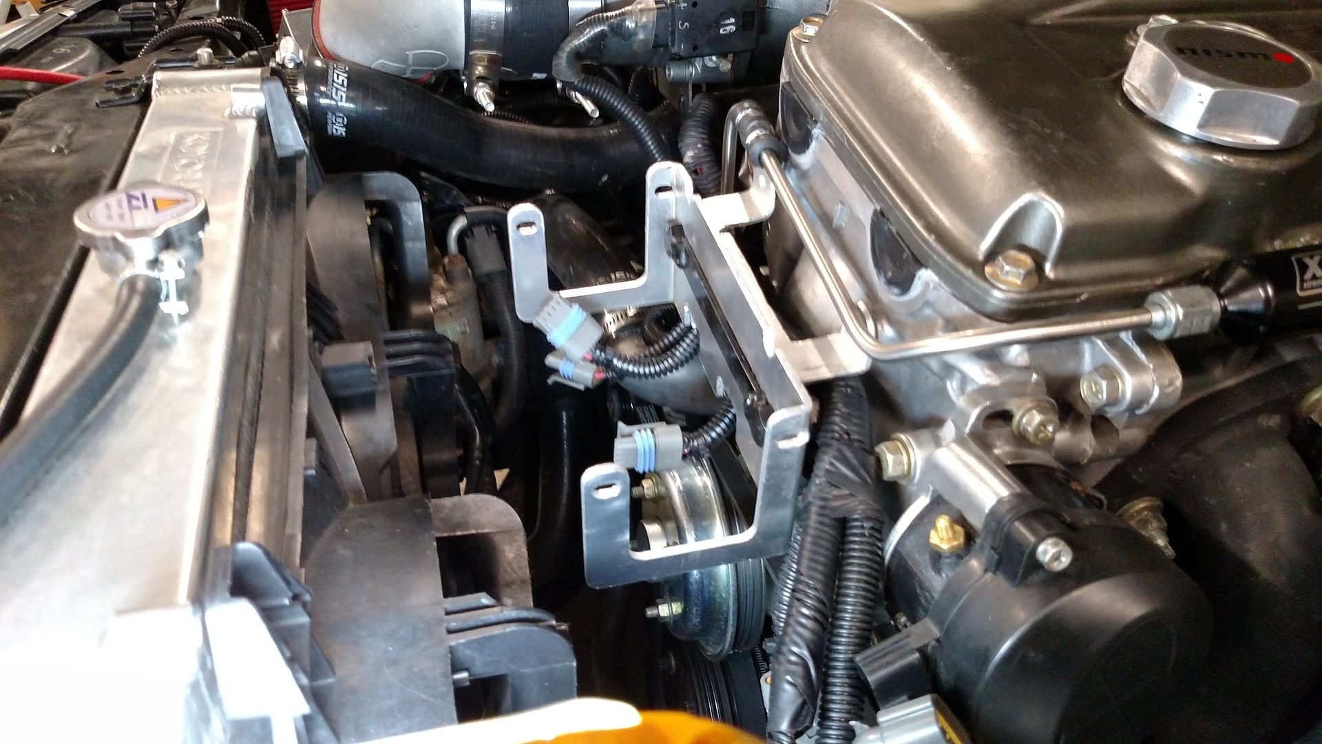

Nice work on the custom mounting bracket! That Nismotronic system seems like it was a great investment; just seems like it has so much capability and room to adapt to new modifications.

Love the LS2 bracket you came up with man. I went with something much simpler with mine, and always wished Id taken the time to do it right.

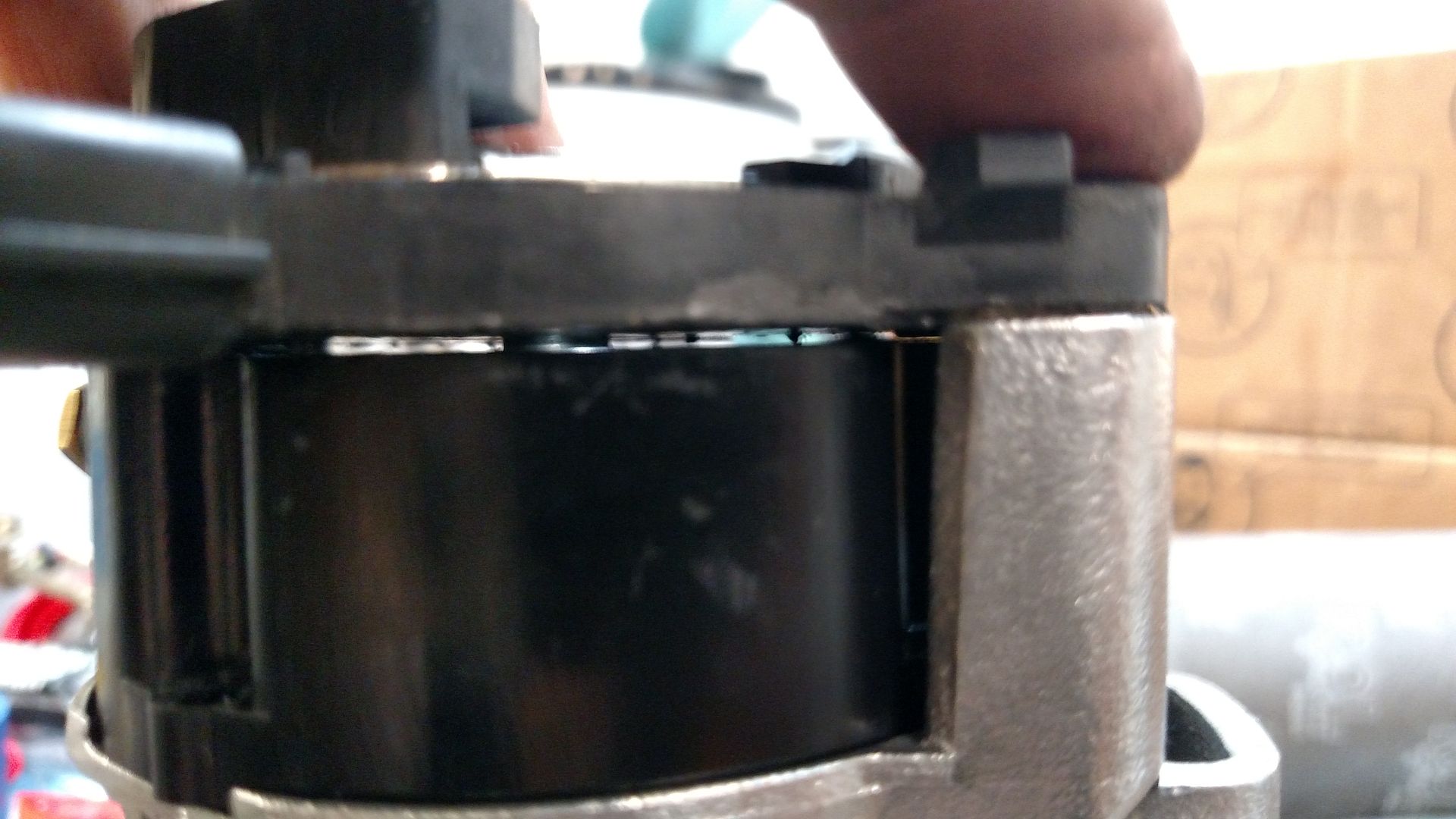

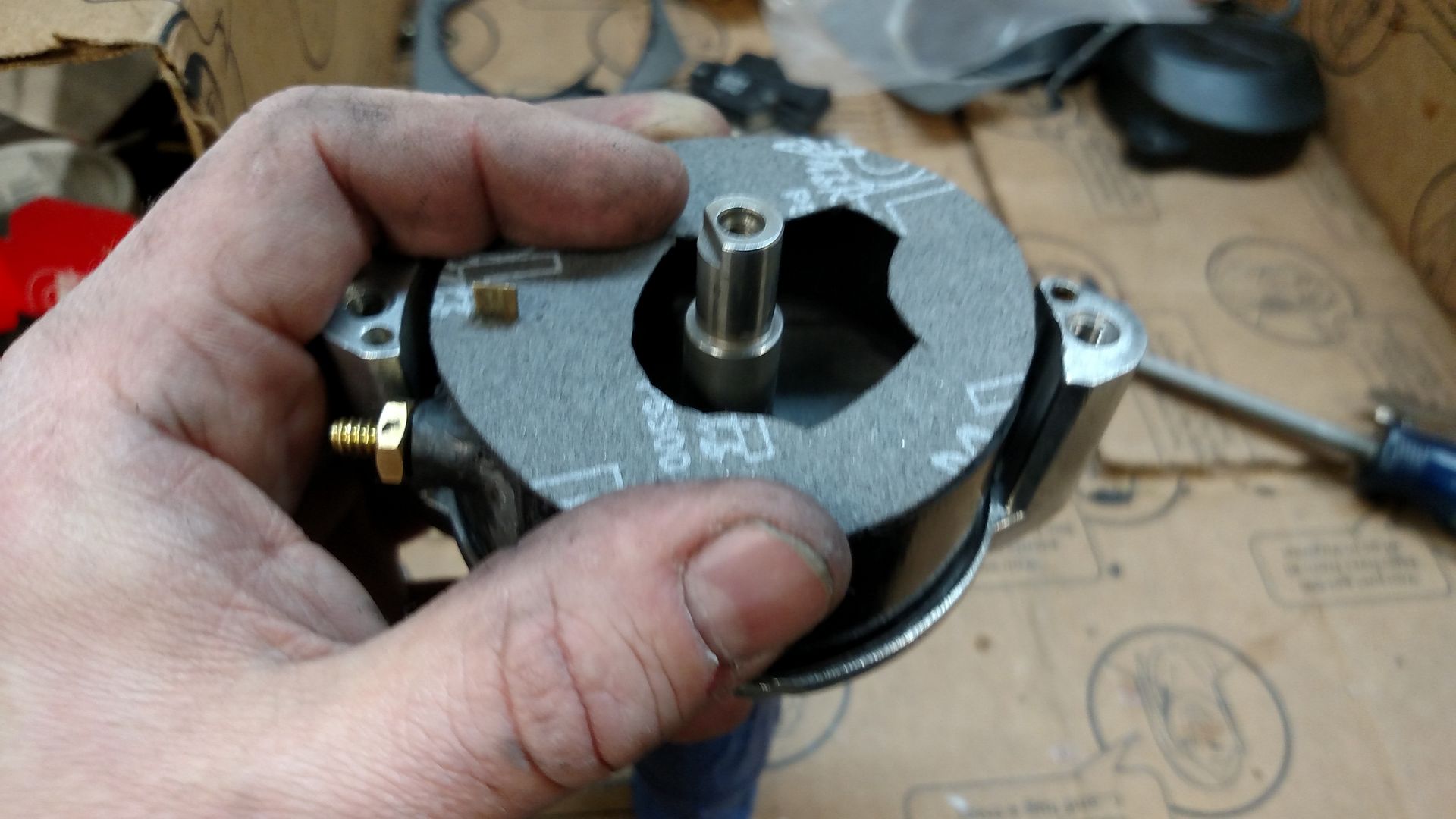

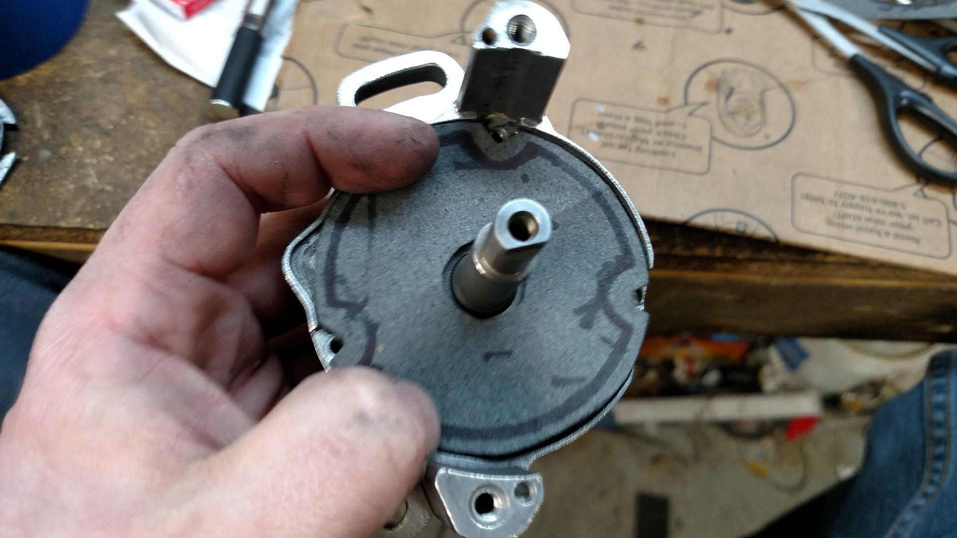

So check this out. As I was pulling the wastegate off, I heard a klank and looked down to see the wastegate valve on the ground. Umm, that's not normal.
I took it apart and there are the 4 set screws that secure the diaphragm to the valve, just banging around loosely on top of the diaphragm. That explains the valve falling out and it also explains something else... when I had boost-leak tested the car earlier, I couldn't figure out why I was getting boost all the way through the wastegate. I figured the diaphragm had popped out or gotten damaged somehow, but luckily that wasn't the case. It was just blowing through the screw holes.
As for the screws backing out... I know that I put them on tight. I know I did. What I didn't do is clean them and re-apply threadlocker, and I'm guessing that was my issue. I cleaned it all up and applied some high temp threadlocker called Resbond, which I had left over from my Inconel turbo stud kit. Unlike other thread locking compounds, it holds up to high temps very well. I put the screws in good and tight with the Resbond, got it all back together, and she's back to normal now. I actually thought something was wrong on the first drive. I couldn't understand why it felt so slow. And then I realized the boost controller was just off. :mrgreen: Even low boost, 12 psi, feels so slow now.

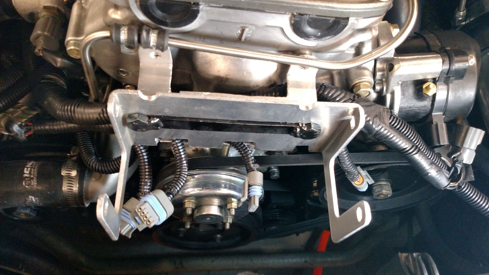

nice bracket, but those bottom bolts are gonna be a bi*ch to get to...

Good point and I think I know a possible solution to that. I could slot the bottom holes so that the bracket would slide on at the bottom. Then I could go in from the side with a racheting wrench and snug them down.

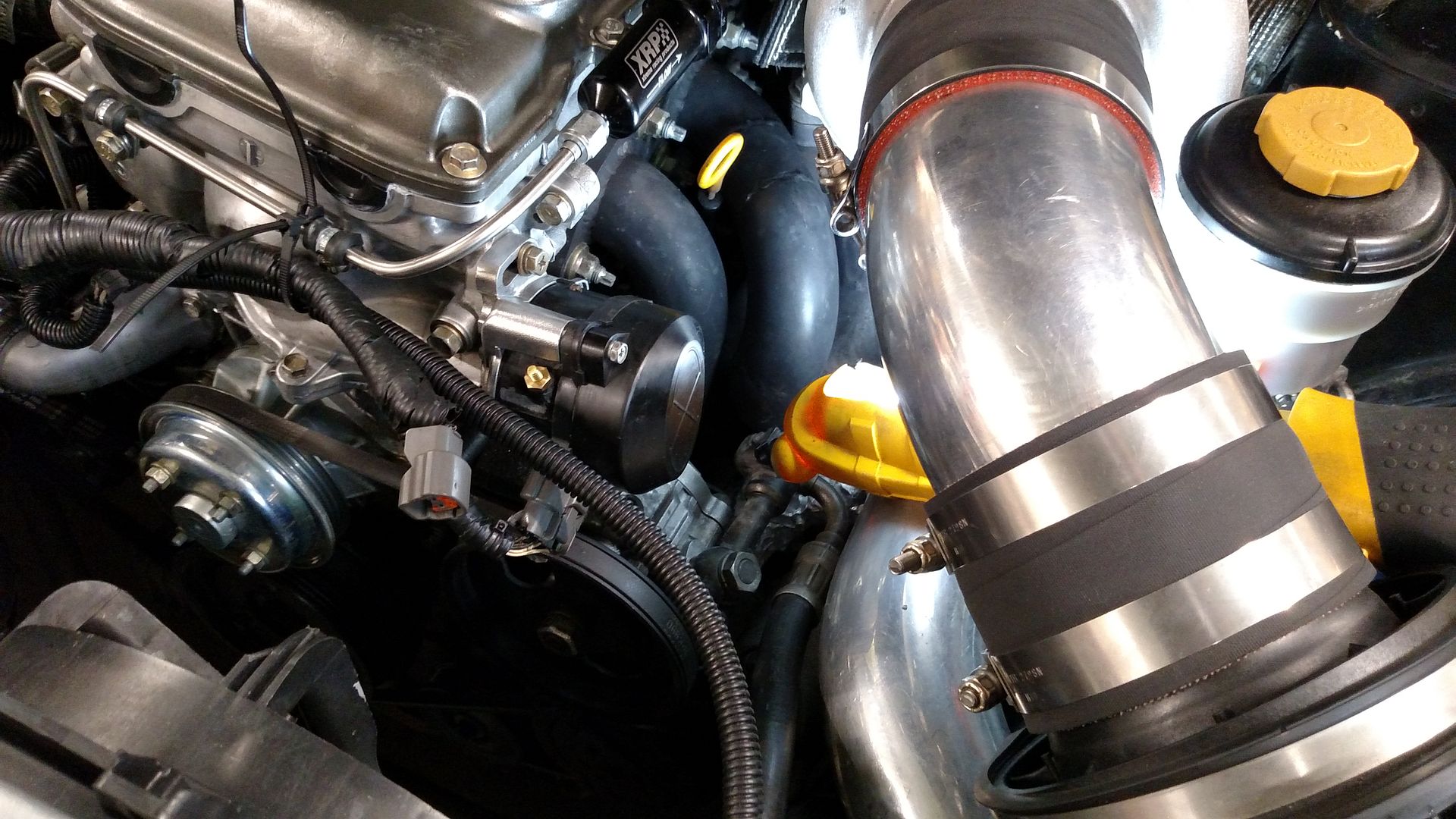

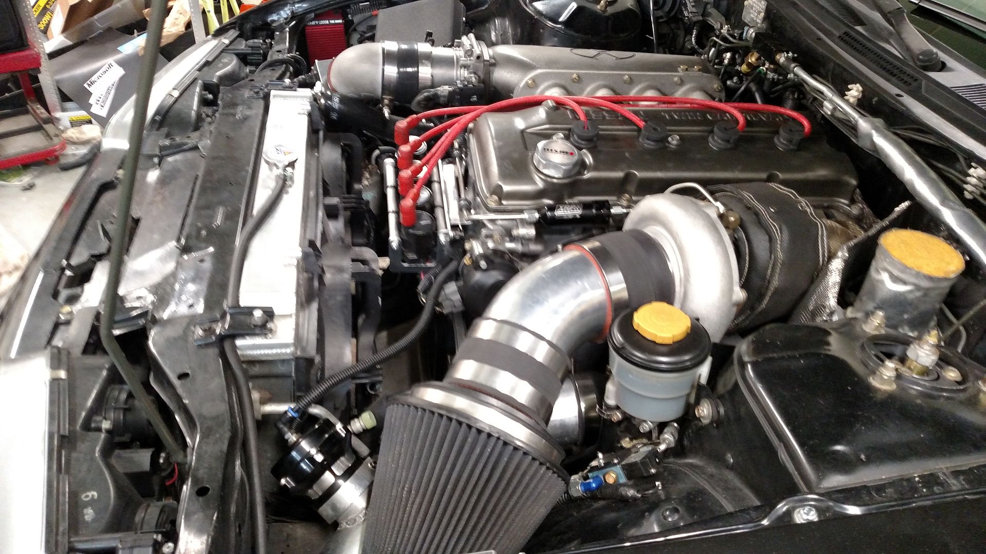

I've been wanting to change my intake piping to get rid of the short radius 90* elbow that presses up against the upper radiator hose. Luckily, Xcessive makes a 45* swivel elbow (https://xcessivemanufacturing.com/xm-un ... se-45.html), which I happened to get for my birthday last month. I test fit it today along with some spare mandrel-bent SS tubing (60* bend) in order to figure out how it's going to fit.
Next I need to order an aluminum 60* bend and figure out where I'm going to install the IAT bung.

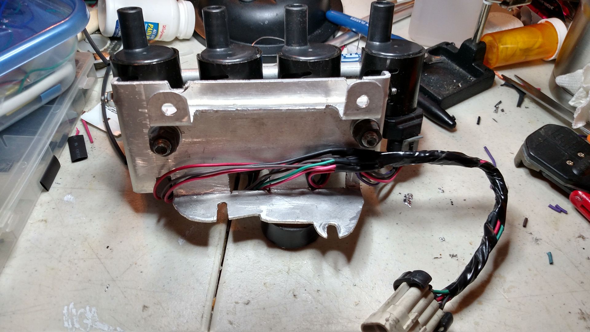

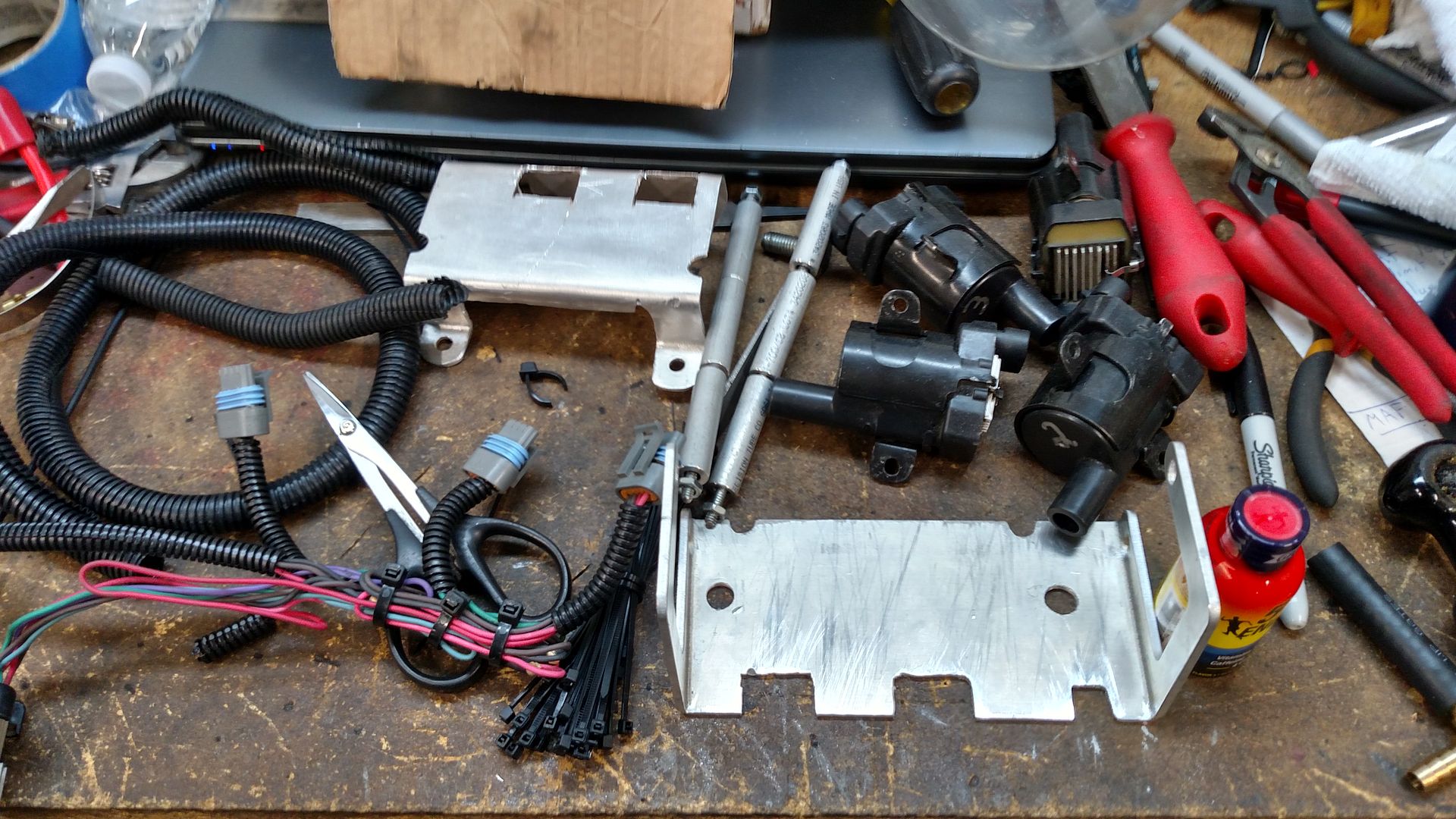

I'm too lazy to type right now, so here are some pics.

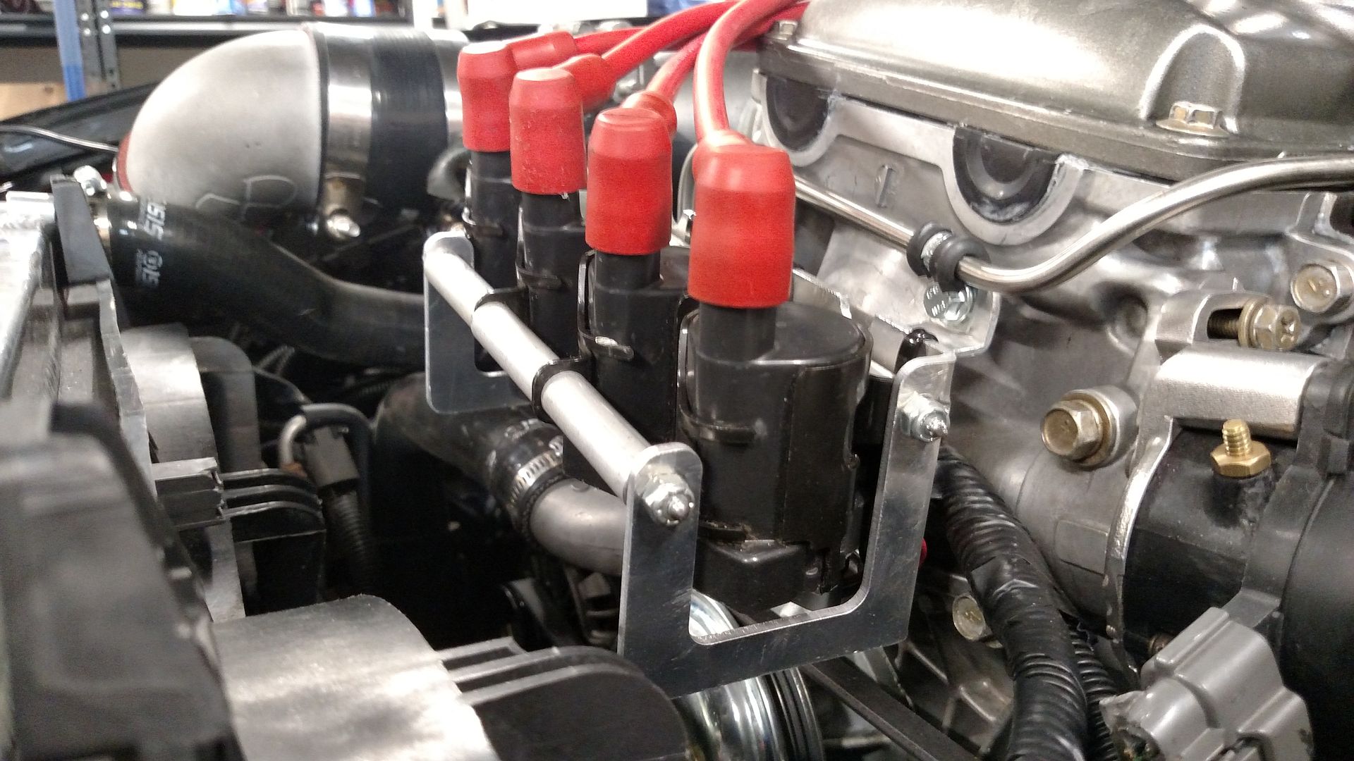

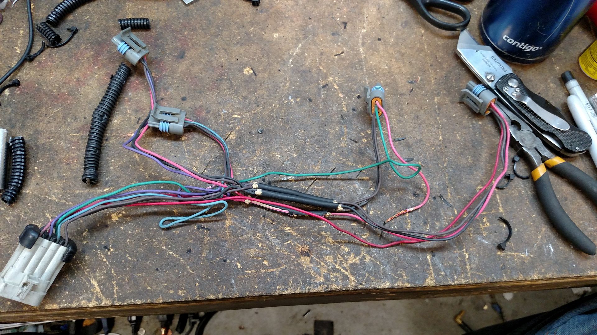

The coil wires as I first installed them were hanging down within half an inch of the water pump pulley. That made me nervous. I decided to cut some holes in my bracket so that I could run the wires behind it with just the plugs and a tiny bit of wire showing below the bracket.
I tried bundling the overly long wires together to avoid cutting up the sub harness, but it was just too bulky and there isn't much space behind the bracket to fit wires. So I hacked up and resoldered everything to be exactly the right length. This will make it much easier to install everything, especially because of better access to those lower two bolts.

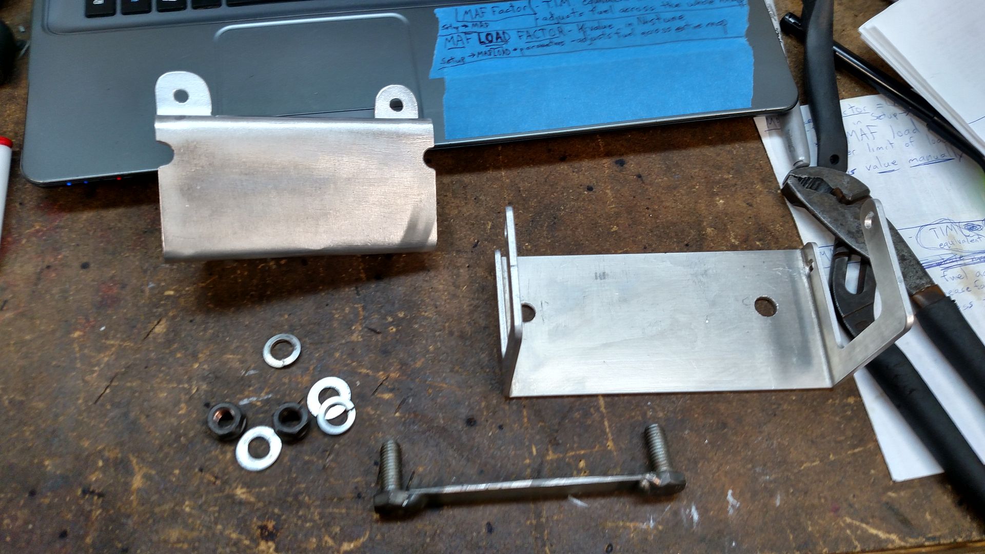

Post by adamky » Thu Mar 23, 2017 1:45 am
These are the last pics of the coils, I swear! After a lot of tweaking and test-fitting, I'm done with this and ready to move on to the next issue, which is figuring out why I don't have working A/C anymore.
As for the Nismotronic, I've got the car idling very well. I'm really blown away by all of the features this setup has to offer. For example, there are 5 or 6 adjustable parameters just for the TPS sensor. I spent well over an hour just playing with the settings until I had it smoothly going from 0-100% through the full sweep.

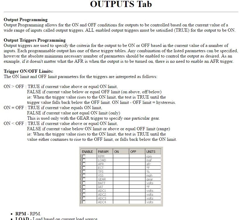

But this is not how the A/C was meant to operate. In the Nismotronic software, there are pre-defined variables that shut the compressor down if RPM is over 5000, if TPS is over 70%, and if temp is over 230*. If I bypass these things, that can't be good for the life of my A/C system if something were to go wrong. I wish there was another solution, but this may be all I have.
As for controlling the fans, apparently this is only possible on FWD ECUs, which I don't have. BUT, there is another possible solution. There are two programmable generic outputs that you can set to control a switched ground signal. (Big thanks to OnTheChip for that info on the output signal). These outputs utilize unused ECU pins and I have 3 options that I could use. There are parameters that you can set up to control exactly what conditions will trigger the output, including engine coolant temperature. So, I believe that I should be able to control a fan this way. However, I have tried programming several different outputs to trigger at certain temps and I am not having any luck so far. Getting the fans to work is what I need to get back on the road.
My buddy who is just a wiz with anything electronic is supposed to give me a hand tomorrow. Hopefully he'll see something I don't and we can at least get the fan control working, and I guess I'll leave the A/C jerry-rigged (unless I can figure out another solution).
I e-mailed John@j-k-tuning.com with some questions about this but haven't heard back yet. Hopefully he'll get back to me soon.
Here's a page from the manual that shows the programmable output conditions. It will be pretty cool if I can get it to work because I can program other variables, such as vehicle speed, to define when the fans come on. For example, I imagine the fans don't do a whole lot of good if you're going anywhere above 55 mph, so I can have them shut off when the speed exceeds that.
