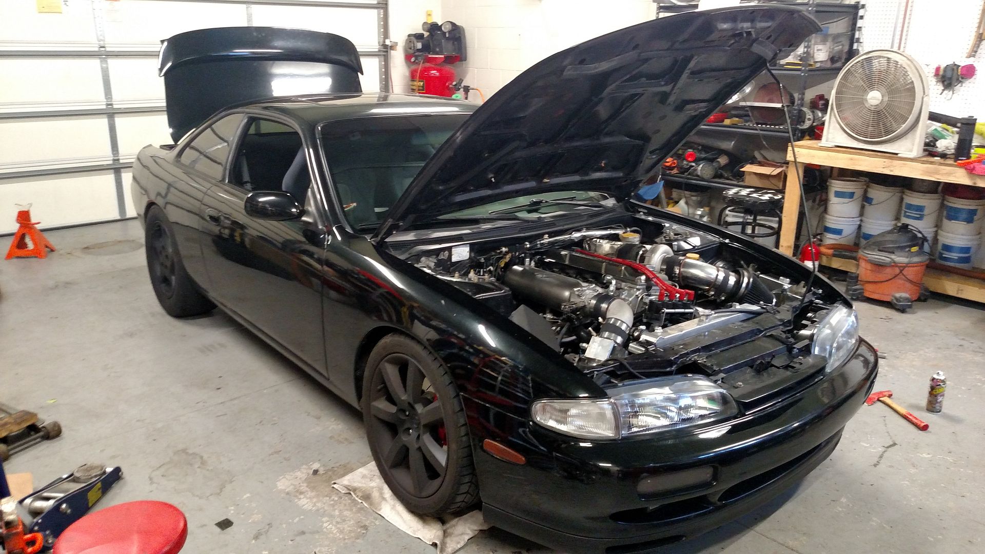

Had to fix a small oil leak and a small fuel leak today. Everything is good to go now. IAT is installed and working. I was able to get my speed density set up on a toggle switch so I can instantly switch from one to the other. Did some tinkering and got the car idling on @ ~14.7:1 AFRs. But that's as far as I went with it.
I did a little testing of anti-lag launch control for the first time in a while and got a few good/violent pops that made the turbo spool up hard, which in-turn made me :D
A little later, I was trying to record a video of it to see if I got any flames out the back. I mounted my knock-off GoPro to the bumper. Tried to get a video but there wasn't much backfire/popping (@ launch) and it didn't​ build but a few psi of boost. But, I did catch a glimpse of the elusive fireball on a full-throttle 2-3 shift (with flat-shift enabled). Image
I know this makes me a ricer in some folks eyes, but I do not care. Fireballs are cool. They've always been cool. They always will be cool. END. OF. STORY.
Also, I didn't do anything special to make it shoot fire between shifts. That's just what happened because my car is awesome 8)

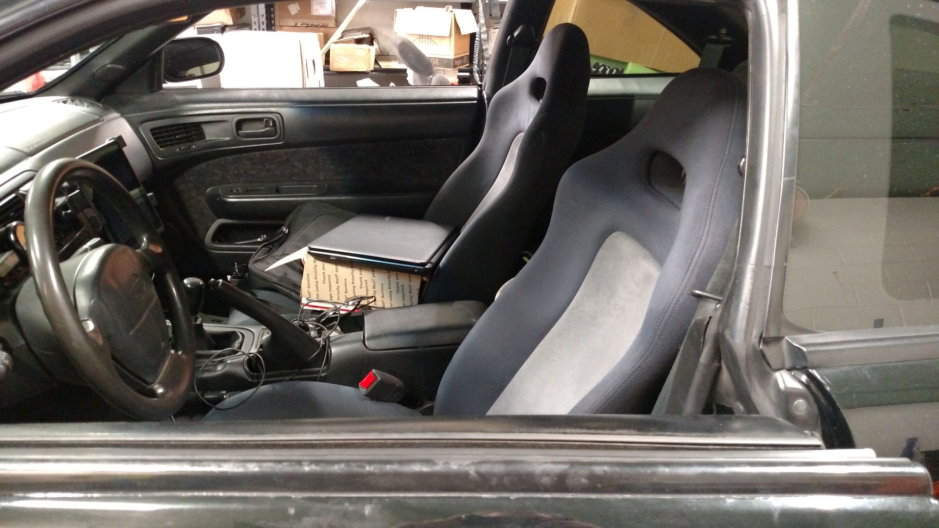

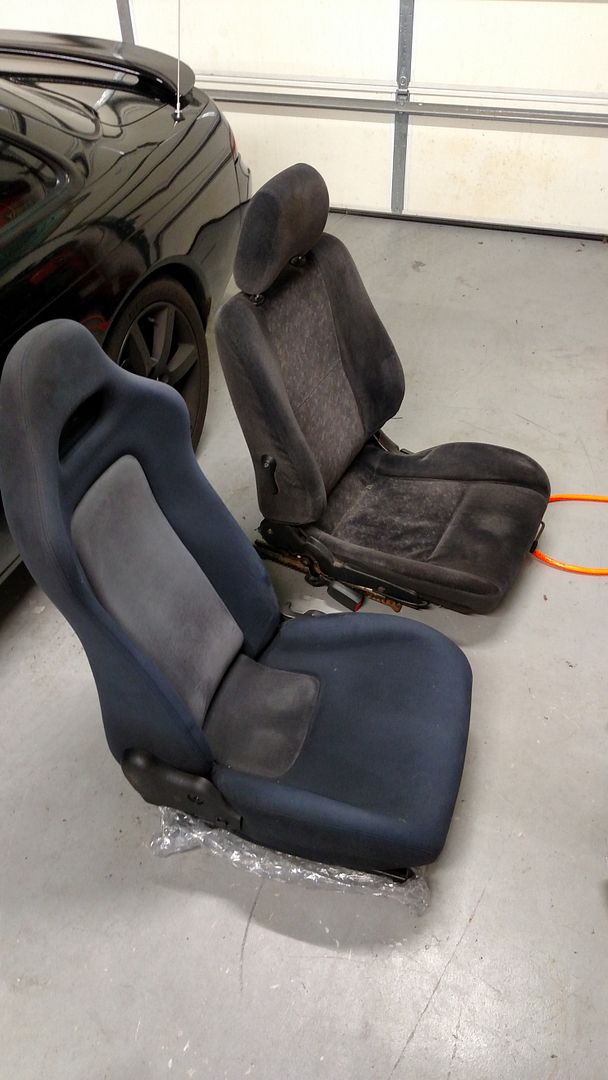

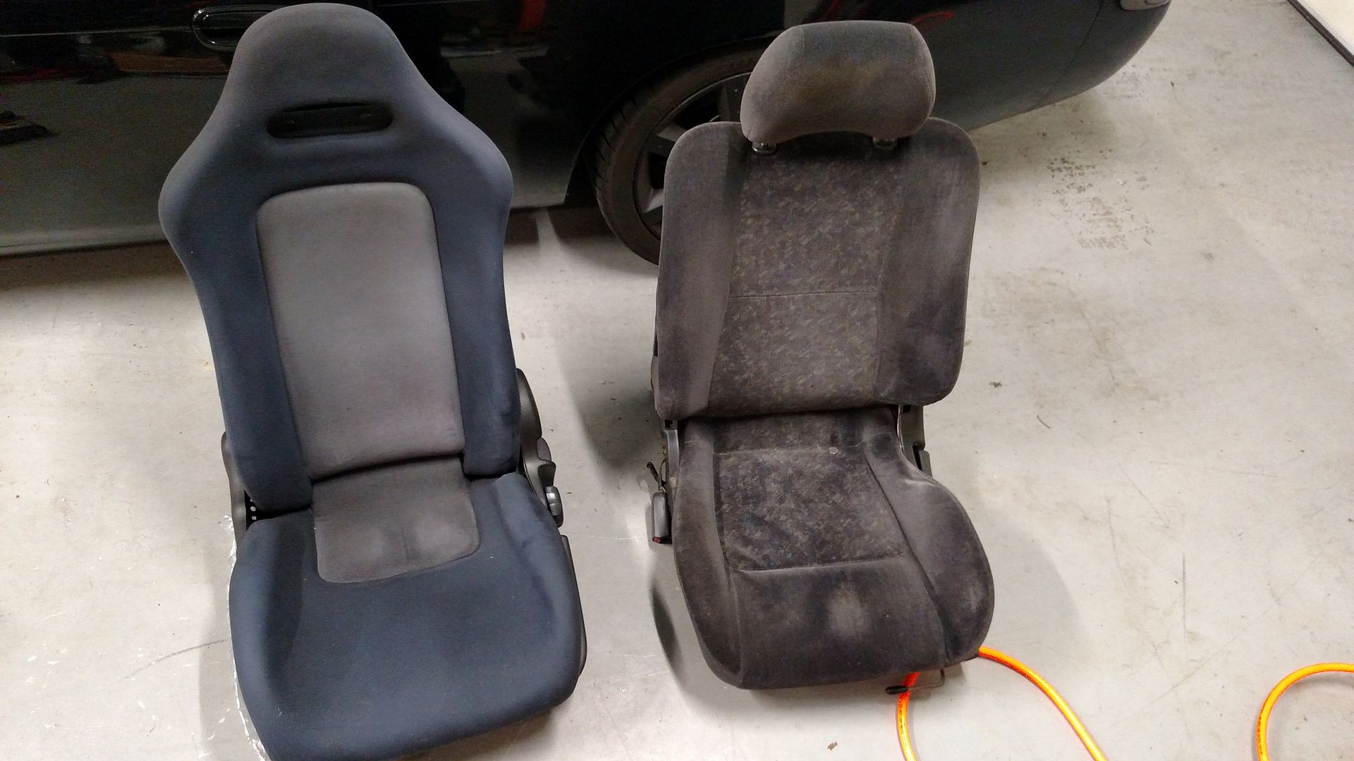

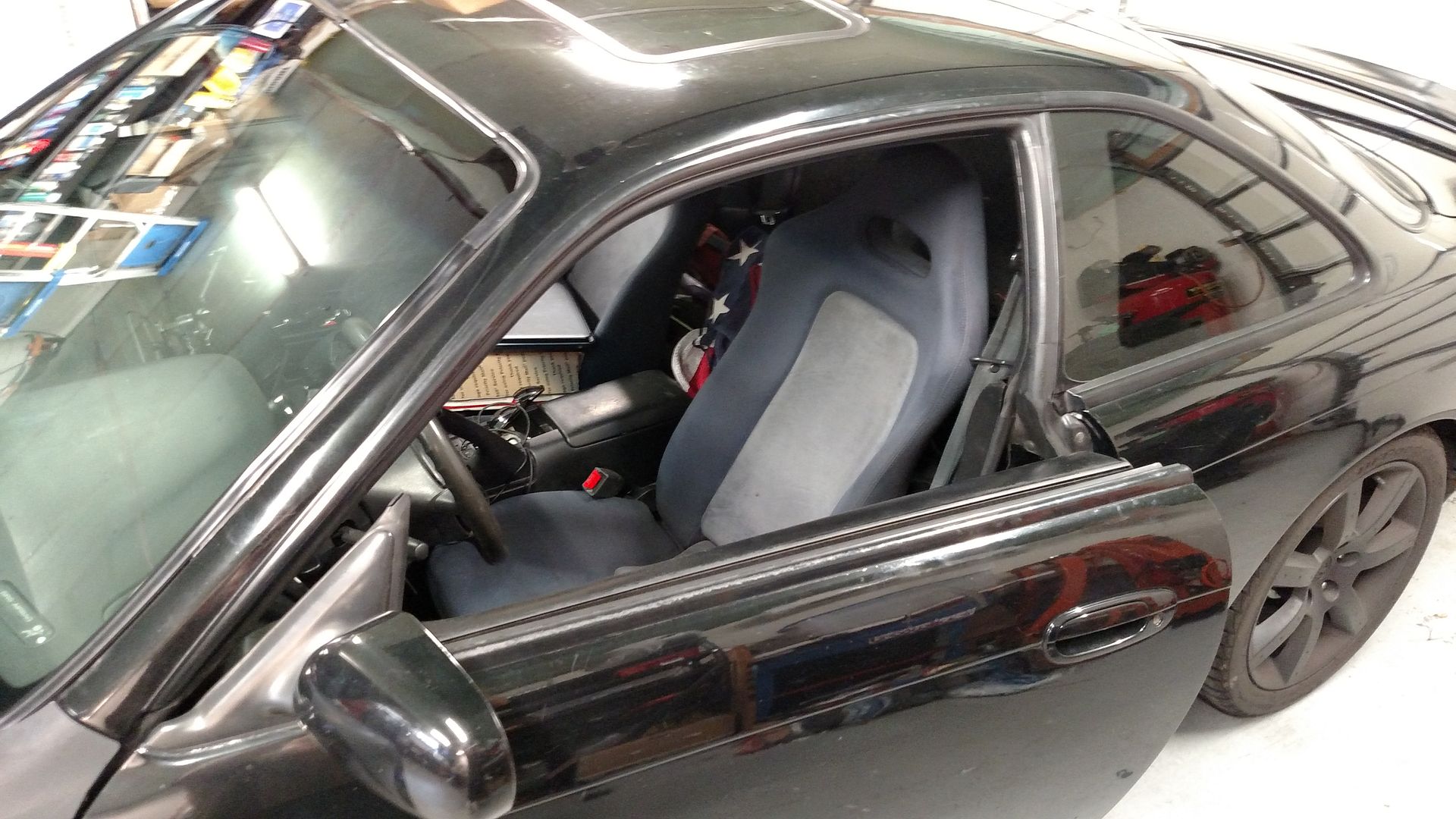

As I've mentioned many times over the years, I have fairly regular issues with back pain. And I recently realized that my driver's seat is way past worn and just not giving any real support... well, anywhere. The back of the seat actually sits crooked so I couldn't sit straight upright if I wanted to. I blame my many years of driving with a "gangsta lean".
So, for health reasons.... I had to remove​ the stock seats and upgrade to R32 GTR seats. This picture shows my "new" seat on the left, and my broken down, dirty, POS factory seat on the right.
Installed

Post by superDorifto » Wed May 31, 2017 8:05 pm
that is almost a required mod...your poor back.

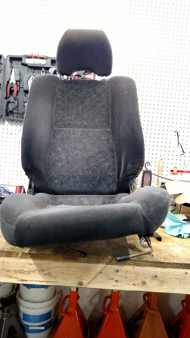

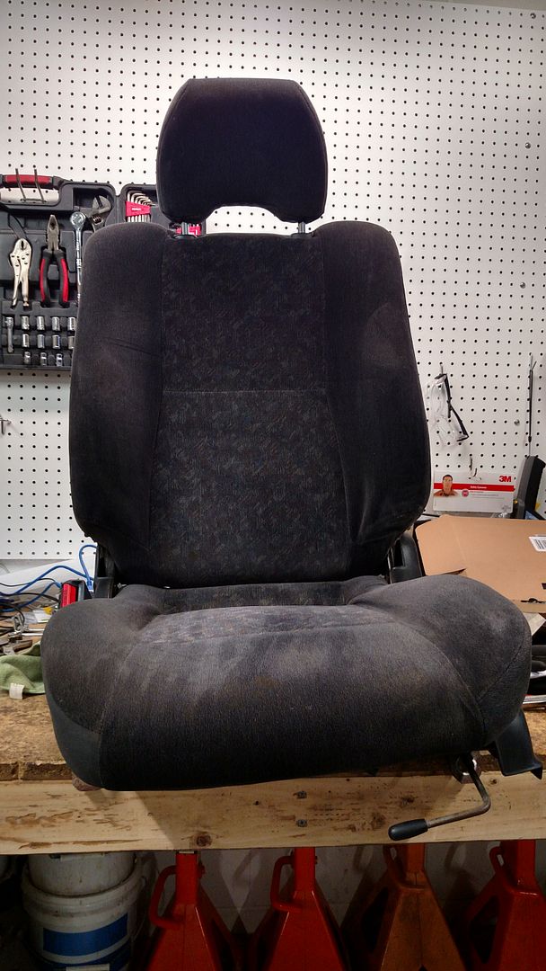

You have no idea. I actually tried to "fix" it a while back by shortening the lateral springs under the cushion. It made a tiny improvement, but just wasn't enough.
Before:
After:

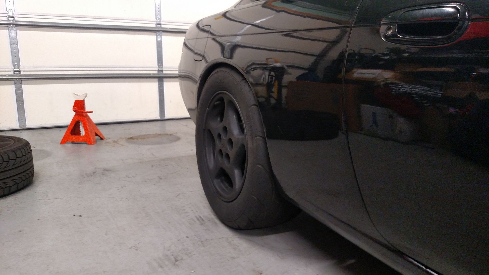

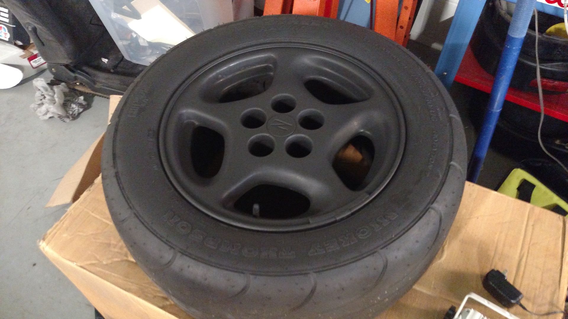

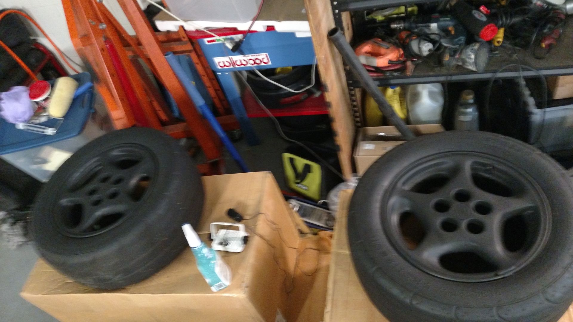

Well, the weather changed for the better. Test and tune night at the track is tomorrow and there's no rain expected, so I'm going for it. I have no helmet and no safety equipment, so I won't be surprised if I only get a pass or two in before they shut me down.
Kill mode engaged:
I spent about an hour or so street tuning on the DRs. Awesome grip. Even without heating them up, they held 20 psi in 2nd gear without any spinning. I'm very excited to see what it will do. I don't expect to get more than a run or two in, so I plan on going HAM on the first pass!
Another note, it's funny how getting traction can actually make the car feel slower!
