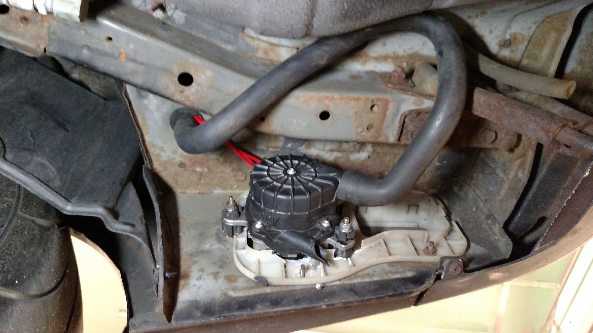

I haven't posted updates in forever, but I installed an electric vacuum pump and it works pretty well. I'm controlling it with Nismotronic. So, I was able to set conditions and be very specific about it. Under WOT, I no longer deplete my vacuum tank. As soon as it hits 3-4 inHg, the ECU kicks the pump on and maintains 3 inHg for as long as it's running.
It's just a simple brushed motor. Here's a pic showing where I installed it. It just dumps straight down and back. It's connected to the tank with a one-way valve, which stays shut until the pump is activated.

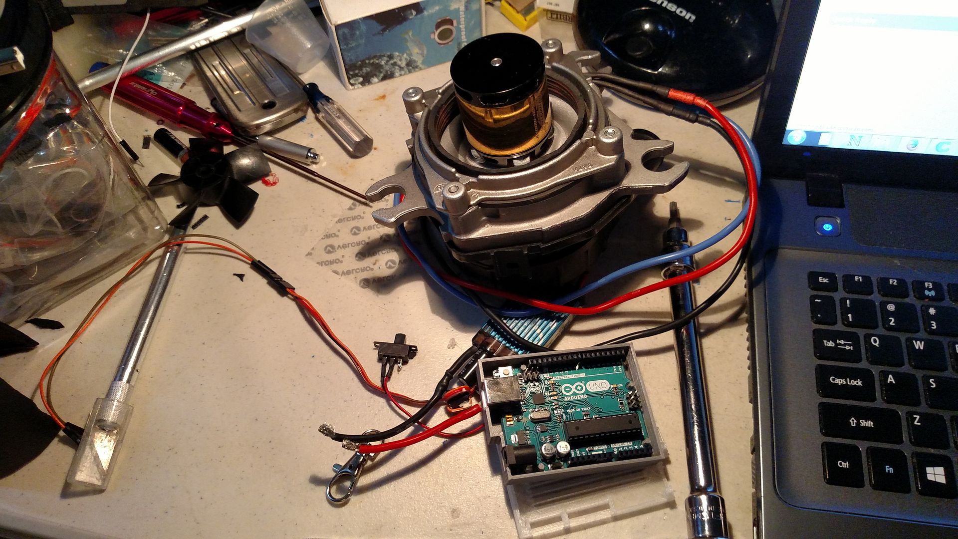

I have been working on a brushless upgrade that will pull 6-8 inHg on my bench. I'm controlling it with an Arduino Uno. But, I'm still working on the programming for it and haven't touched it in months. Eventually though, it will be done. Here are some pics of it so far..

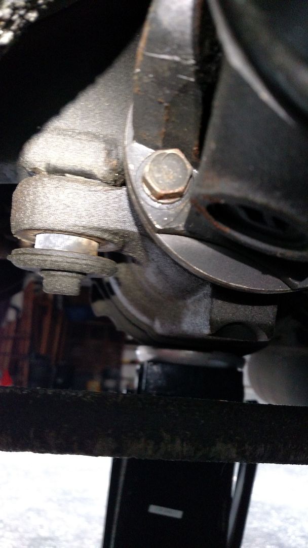

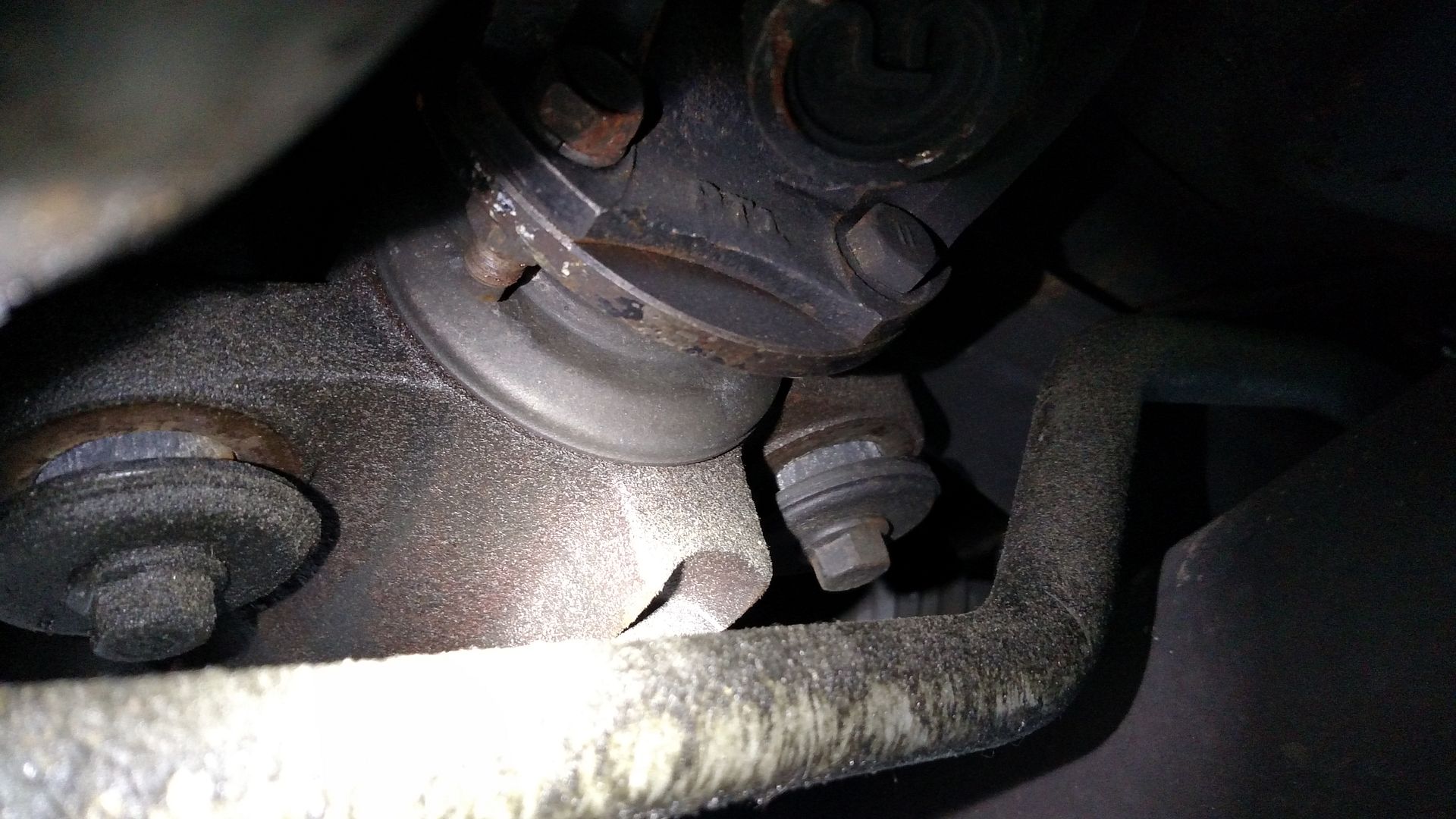

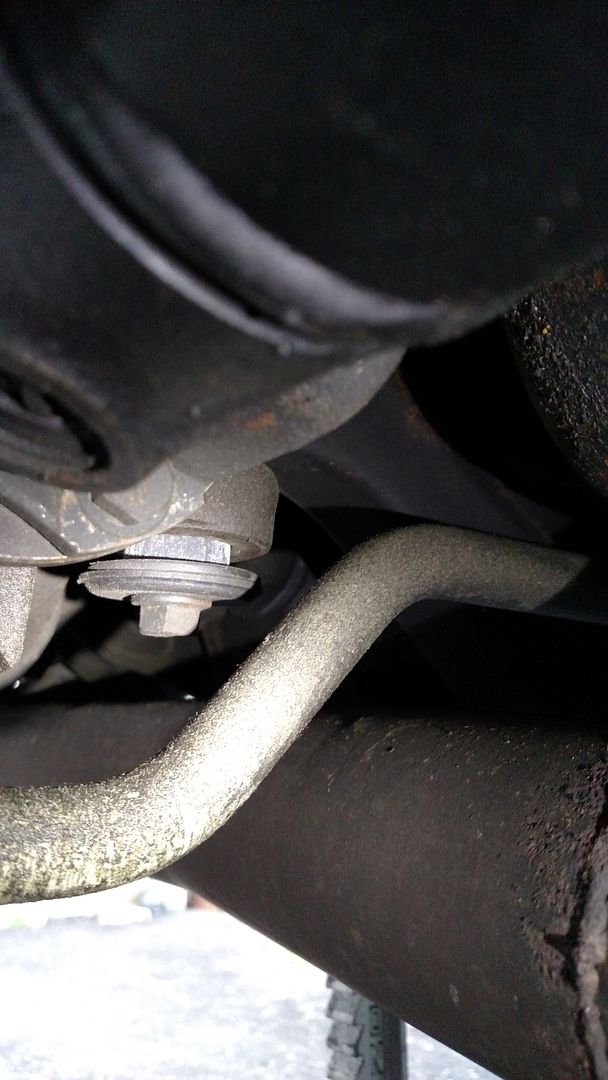

In other news, I may have an idea where that insane drivetrain clunk has been coming from.
I knew the Energy Suspension diff bushings for this car were a sh!tty design, but WTF?? They completely disentegrated..

by adamky
Clunk no more...

I actually gave up on the Arduino programming. It was way overcomplicated for what I need.
However, just yesterday, I realized that I can hack a cheap servo tester to control the brushless motor. I simply have to remove the potentiometer from the board and use resistors and a relay to get the controller to change the motor speed at the flip of a switch. I just tested it a minute ago by simply bridging 2 of the potentiometer pins and the motor spun up to full throttle.
