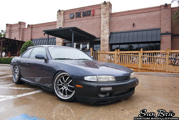

Post by picsbypenny » Fri Oct 12, 2012 2:26 pm
Thanks for all your help so far man! Maybe we can meet up at a track up in Oklahoma, after I get my new clutch.
pic the day after I put the wheels on...
