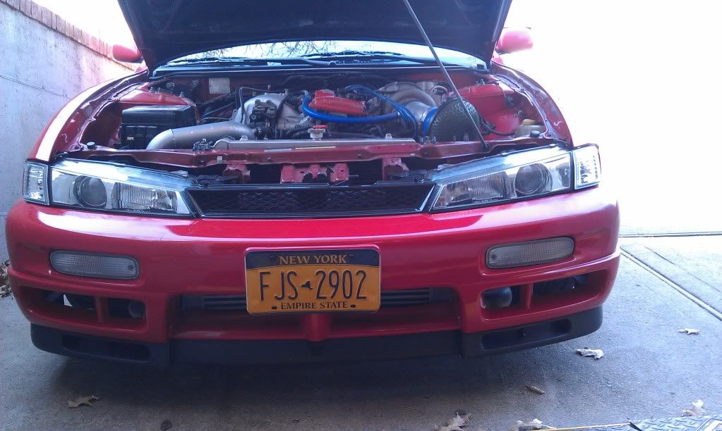

everyone meet Renee
goal for this build : modern day race car in 90 era car.
first set of mods are:
kouki tail lights
fortune auto 500 coilovers
rear multi link arms
re-barrel rims.

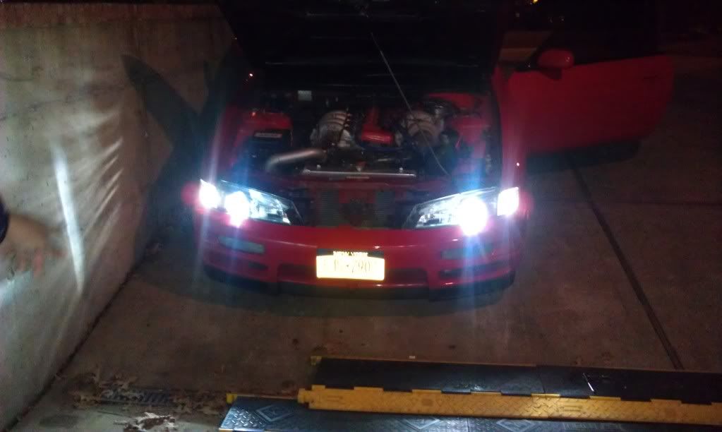

so i did ricer things.. i finally got around to installing my hids
also my head light housing was fading so i baked them open and swapped out the housing to nice shiny ones i had laying around..

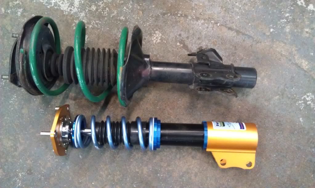

update coils are in!
i will go lower once i re lip my rims and get the fenders pulled..

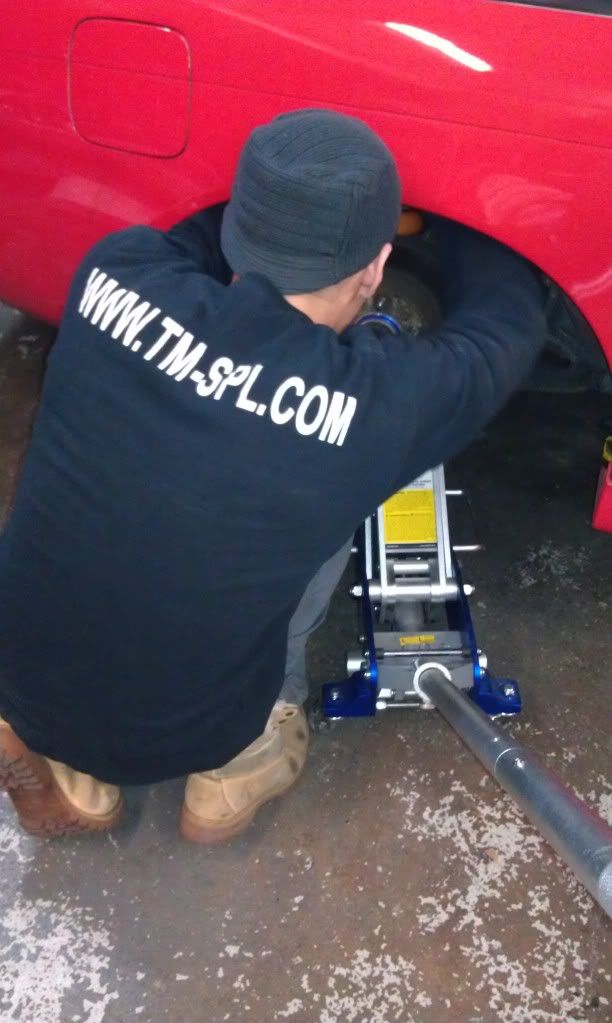

pics of install done @ TARMAC SPL - thanks D!
old vs new
D putting in work
also did pbm ruca
all done!

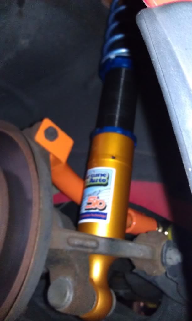

driving impressions-
Dampening was set 18 clicks form soft all around. I did the full stiff -> full soft as recommended before final adjustment of Damper.
Living in NYC and having experience in a s14 with harsh coils I was nervous in the beginning.. My first impression when driving down the block away from the shop was “wow these feel almost like the tien springs/stock strut combo” they felt more firm and responsive. Taking some dips on the road at fairly low speeds and the car remained stable, it wasn’t bouncy at all. The coils rebounded pretty quickly at local driving speeds ~15-30pmh. Compared to other coilovers they would get pretty bouncy at those speeds on wavy pavement. The joints/cracks in the road I didn’t notice them! That was a huge huge surprise to me. I was so happy that the coils rode so comfortable on local streets. I did purposely go over a few pot holes to see how harsh it was compared to the spring and struts combo. To my surprise it wasn’t that bad. It wasn’t as forgiving as a spring and strut but it didn’t make my back hurt over the bump either.. But needless to say I will be avoiding all pot holes..
On to Highway impressions-
My commute from the shop to my home is around 30miles, nyc high ways are unforgiving, pot holes, uneven pavement, cracks, un level areas that look and feel like some one put a speed bump on the high way for no apparent reason -__-
Cursing around 60mph the car is super responsive, lane change and weaving left to right is super responsive, as soon as I turn the wheel the car moves. It doesn’t lean it just goes with out delay. The ride isn’t bouncy at all. Its not to firm as in low speed testing, it rebounds nicely over uneven pavement. Driving around 60-70mph I didn’t feel the joints in the high way, it felt good not to have the car twitch over every line. I did slightly feel when the asphalt met cement and back to asphalt. But its nothing to complain about, Fortune Auto coilovers are way more forgiving then other coilvovers. The swift springs make the car feel soo composed, honestly it felt stable like my 07 335i on the high way, a nice comfortable ride and handle nicely, its very composed the car isn’t all over the road and it doesn’t tend to pull into the crown of the road like some overly stiff coilovers. The response is crazy, my last s14 had full suspension and arms spl outer tie rods/tension rods/ full rear arms, sub frame bushing ect. And in response this new car feels like this car with just coilovers! Amazing. Fortune auto did a great job with the Digressive valving on this coil.
My only only compliant was that over a big bump on the high way the coilover rebounded pretty hard, but It is expected as they are coilovers.. and the other negative would be on extremely low speed less then 10mph on a wavy piece of road the coils do feel a little bouncy but nothing that is to harsh. Again they are coilover and it’s the nature of them.
Over all im super satisfied with the coilovers and picking Fortune auto, Terry was a big help throughout the whole process of matching spring rate s and taking time to explain to me how the coilovers worked. He predicted them to be just like how they are! The swift springs are amazing defiantly worth the money. Even Damium was surprised at how well these coils rode in comparison to all the other coils hes tired.
I will keep updating this thread as I get more seat time with the coilover and also how it stands up over time. Right now the ride height is 25” from the floor to fender arch. I will be lowering it soo to around 23”. I will give another assessment of the car at that height to compare it at a lower setting. Also I will adjust the dampening to a softer and harder setting to see the difference.
Over all id recommend these coils, its super comfortable, firm and sporty when it needs to be and it fits on the car perfectly.

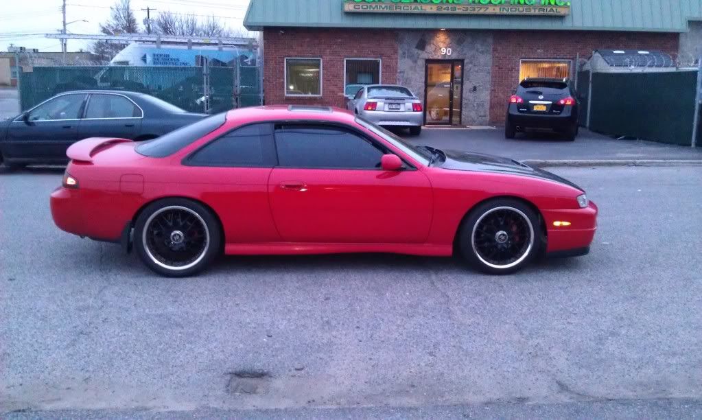

yes i know moar low! getting my fenders pulled and lowering the car another 1" this week and installing my jdm bumper. Should look decent soon.
btw federal ss595 run big, a 235 isnt even stretched on a 9.5 and a 265 no stretch on a 11" wtf?? i guess now i have to go for the meaty look :/
BAM! in yo face!
Ride height achieved..
Big thanks for TARMAC SPL for the fender pull + height
pretty big difference

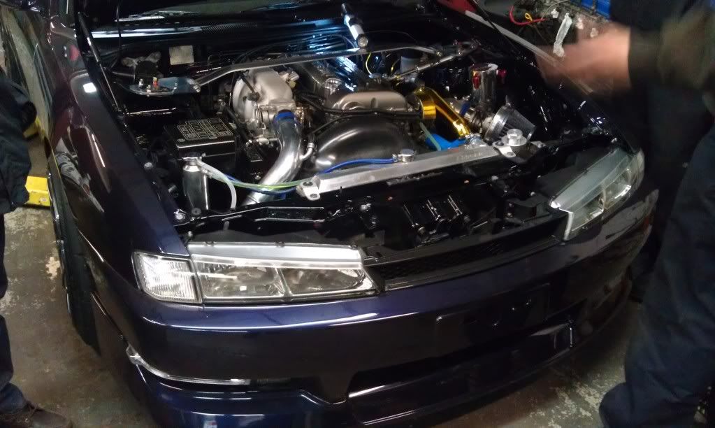

Finally some good progress
went to good ol Tarmac to do some work.. goal today was to fix transmission and exhaust leak.
started off by pulling off the exhaust, i had more leaks then a sinking ship, exhaust was loose in 2 places, down pipe was loose in 2 places, wastegate re-circulation tube was also loose/broken. pulled all that off.
transmission came out no issues tho.. i didnt take much pics but heres one of my twin disk chilling.. its sooo cute
while trying to tighten the wastegate we came to see that all four bolts on my turbo was loose as well.. we proceeded to tighten those as well.
while fixing the exhaust leaks, we decided no more re-circulation open dump ftw. I forgot how good that sounds.. slapped every thing back together and the car runs like a champ and i have reverse! :mysmilie_1725::mysmilie_1528gif:
now since all the hard stuff was done time for the fun stuff ... finally got around to installing my nismo N1 vents
making the whole
test fitting first vent
these things fit soo tight , we had to remover the front bumper so that we can get them to snap into the front bumper..
me and oder comparing aero
all done!
all in all a very productive 15hrs of wrenching

made some progress this weekend,
finally got all the parts back i needed to assemble the turbo side and get the car to the shop.
decided to put all the new parts for my build together just to get a visual on the amount of money i dumped into this build -_-
my not so professional work station
exahust side preped and ready to go
Manifold on, the full race mani was such a breeze to install. it is hands down the best ka-t mani i ever put on. ( i used about 5 different manifolds on other ka-t setups) everything was such easy access , it really makes a difference when buying quality parts
i tried my best not to scratch the nice ceramic coating on the manifold.
As you can see the manifold/wastegate cleared everything well(ac/powersteering lines)only issue was the p.s. resivor line, that will need to be re-done in s.s. since it runs close to the first runner of the manifold.
started to put the turbo on and then i realized that the oil return line didnt reach, i had to pull it off and clock he turbo. this took up alot of my time.
I got it all reassembled and got the downpipe on.
turns out that i dont have the turbo oil feed fitting, i need to order that before i can start the car again, then all i need to do is attach oil/coolant lines, i/c pipe and then its off to Tarmac for fuel system, intake manifold, catch can setup and custom fmic.
getting there..
R.i.p. 97 s14
