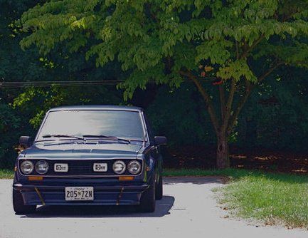

last but not least for now, my dads Datsun 510. The day he wants to sell it I may take it off his hands and make it quick

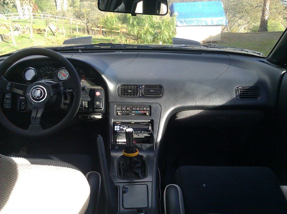

With the start of the new year I bought myself a nice Nardi Steering wheel and raised my boost yesterday. I am now currently running 11psi and oh man did my turbo wake up. I finally got the feeling my car is fast. After class tonight Ill upload a picture of my interior.

Current interior poor cracked dash
On the drive home from class today I stopped at a light, and my car almost went poop on me. Would barely hold idle at 450rpms and seemed to struggle and would be rich between shifts, also would bounce from rich to lean on the wideband after letting off the throttle on the highway. Get to investigate that after class tomorrow, should be lots of fun.
