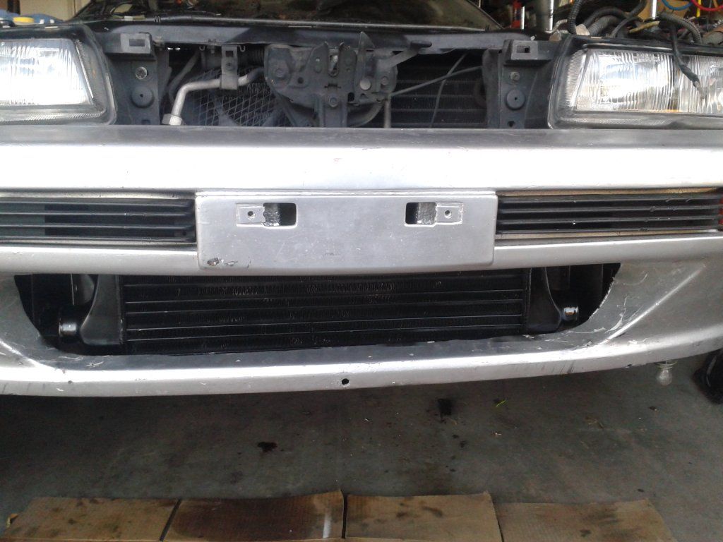

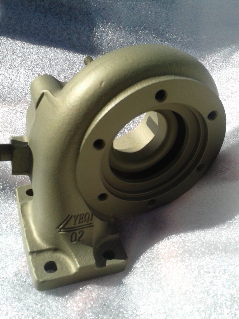

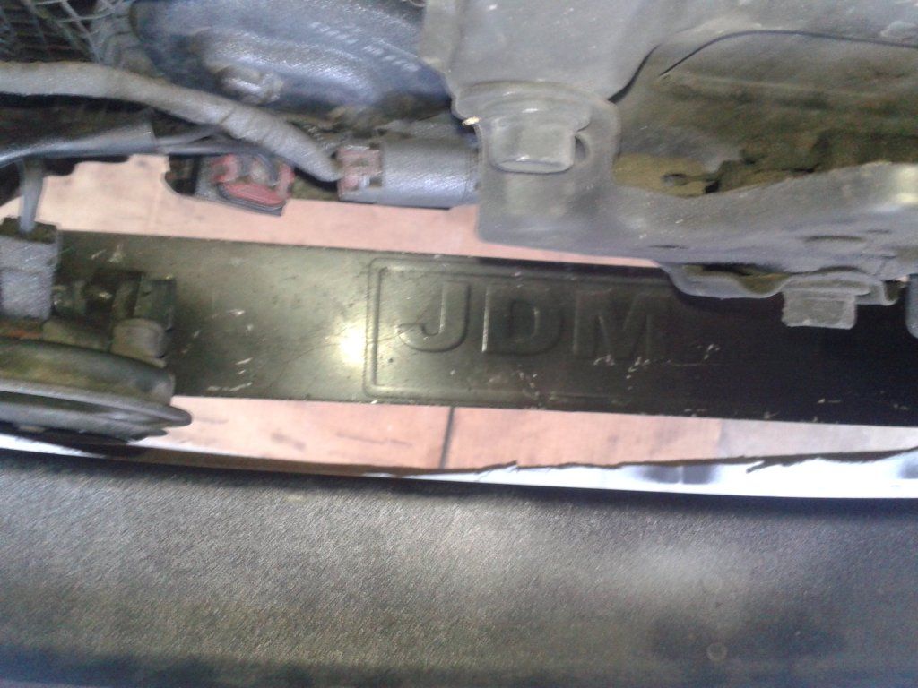

Took the turbo exhaust housing to get powder coated at Ram Pro Line, here are pics of ic installed. Sorry no step by step pics was pretty easy tho. Trimmed the bumper support and the headlight brackets, also used "L" brackets for the top need to see what I will use for the bottom. Pretty sturdy with just the top brackets, let me know if anyone needs more pics.
oh yeah did decide to paint it black too :)

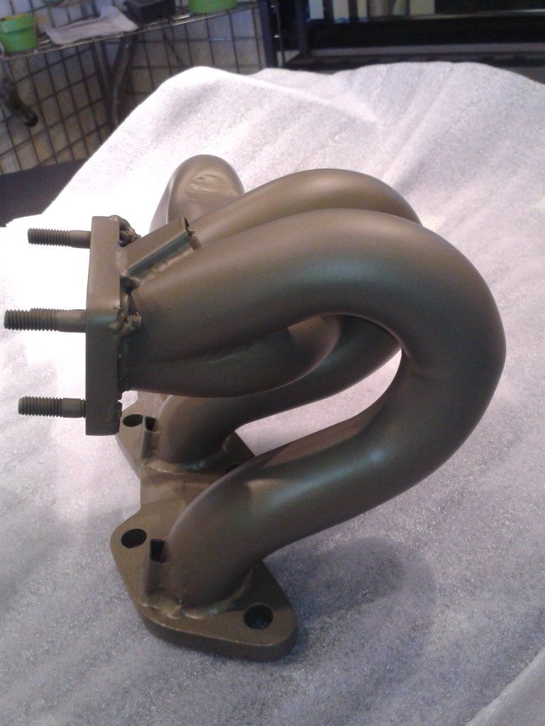

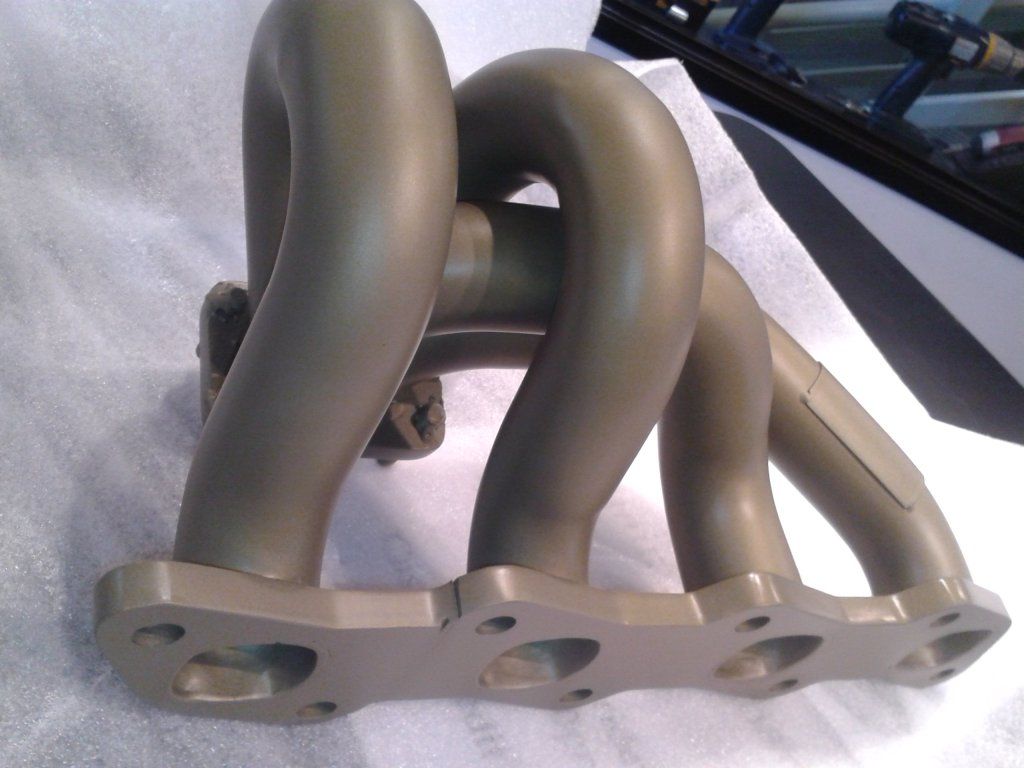

Yes, so I just picked up my manifold and turbo housing they look great cant wait to throw it on along with the clutch and did change up my oil feed. Also did some wiring for my e-fans and a couple of broken dried up wires in the engine harness, anyone ever have problems with the solder coming off the wiring with excessive heat in the engine bay?
exhaust housing
manifold

looks good! ceramic coating?

@ hpi yea ceramic coated

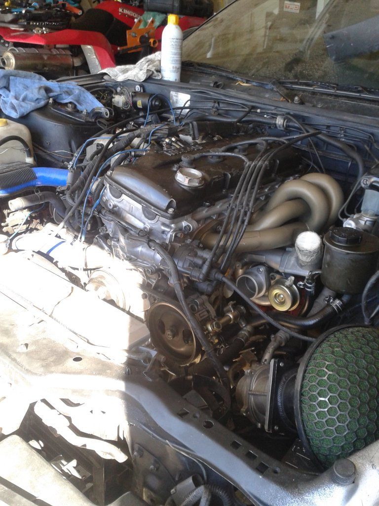

mounted my manifold and turbo:)
also re-did the oil feed line
cant wait :))))) heres a teaser of the downpipe
just need to get heat wrap on the oil feed drain and coolant lines.

Isn't the 02 sensor extremely close to the turbo/heat ? I'm just going by what I've read, not flaming or anything ! Sweet build, keep the updates coming please :)
I love that copper/bronze tone on the mani/DP
signals13
Posts: 463
Joined: Thu Sep 09, 2010 5:45 pm
Location: Las Vegas
Re: finally building my ka :-)
Post by signals13 » Tue Oct 01, 2013 10:36 pm
MidwestJeff wrote:Isn't the 02 sensor extremely close to the turbo/heat ? I'm just going by what I've read, not flaming or anything ! Sweet build, keep the updates coming please :)
I'm not too sure that's how it was when I bought it. I could always heat wrap it or move it further down. Thanks the color is called "piston grey" yeah I'm actually going to update again right now lol.

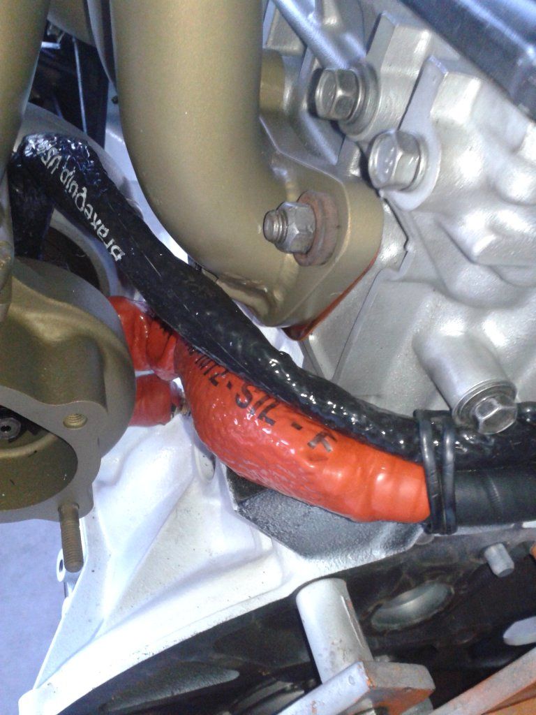

So I'm very excited things keep getting better and better, closer and closer just tying up loose ends and motor is going in soon. On to the pics :)

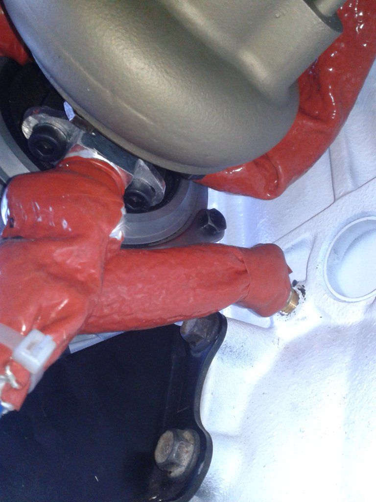

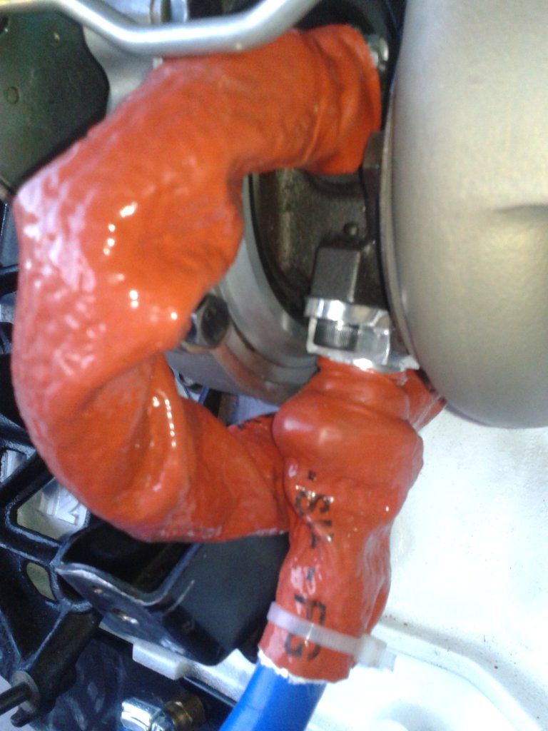

Coolant return and oil feed line wrapped with heat wrap from "All Hose"
Coolant feed and oil drain wrapped and ready.
Under side pic of coolant feed and oil drain wrapped.

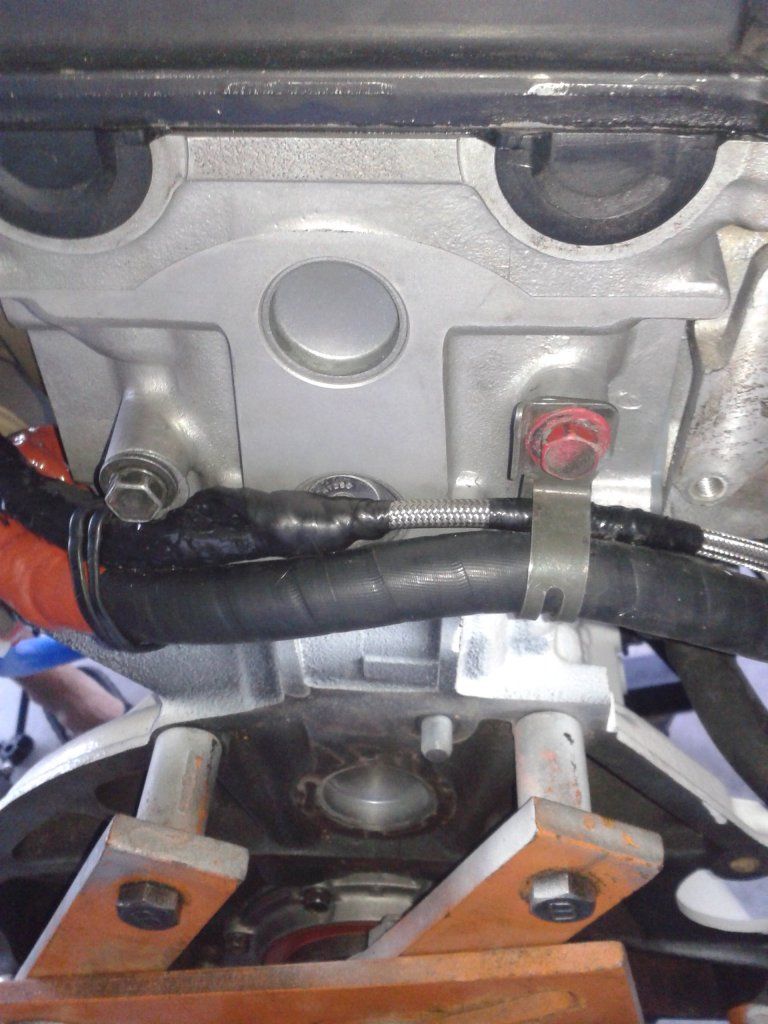

Here's the coolant return and oil feed line nicely tucked behind the head never mind the red bolt lol :)

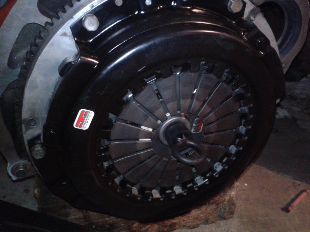

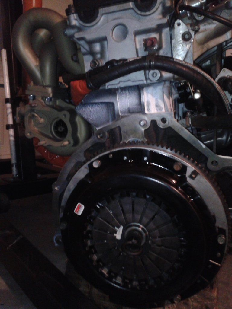

And finally the clutch is on!!!! :D
I will continue to update thanks for watching everyone and for commenting. All advice is taken into consideration let me know if you guys have any questions and concerns it helps me out a lot.

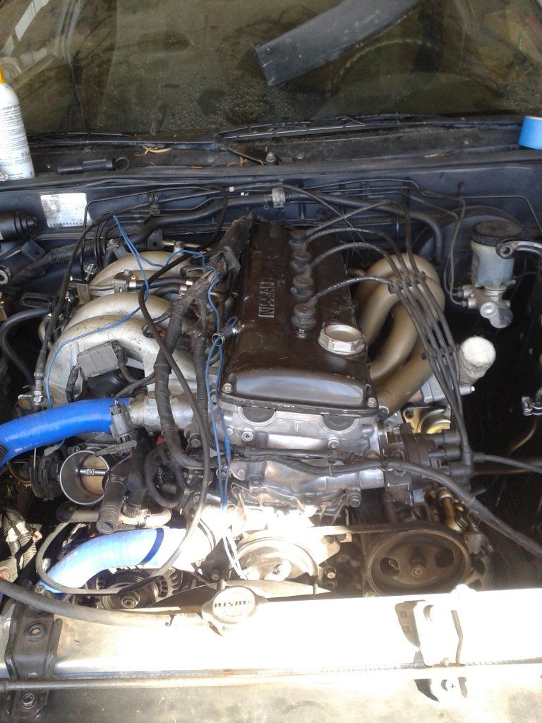

Post by signals13 » Sun Oct 06, 2013 8:57 pm
Sorry for the late pics guys here ya go!! :)
SR20 Pfft!!! Who needs that lol!!
So whats left?? We'll IC piping, exhaust install, vlsd install, fuel pump install, some wiring, coolant lines, and boost and a/f ratio gauge's to be installed, pretty sure I'm missing something thanks for looking.
P.S. A buddy of mine recently got a s13 with SR and he let me drive it can't wait to see how my coupe feels when its running :)

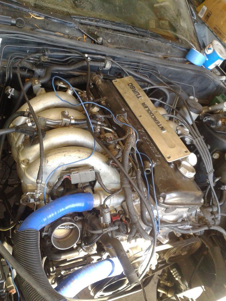

Been doing pretty good, wired up my e-fan, boost gauge, and air fuel gauge. Need to install downpipe, and cat-back next.

Progress has been slow, downpipe and cat-back exhaust is all bolted up along with j30 vlsd. Car is on all 4's now and waiting for radiator install, ic piping, turbo timer install, and fluids, then I can start it :)
