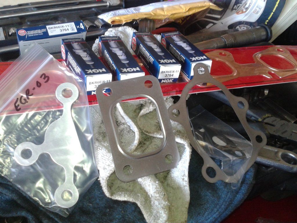

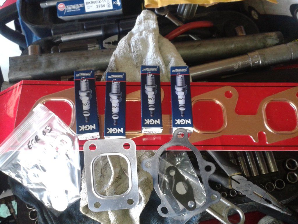

Update: 9/2/13
I received a bunch of parts that where ordered still waiting on more but its all going steady cant wait to finish her up sooooo excited

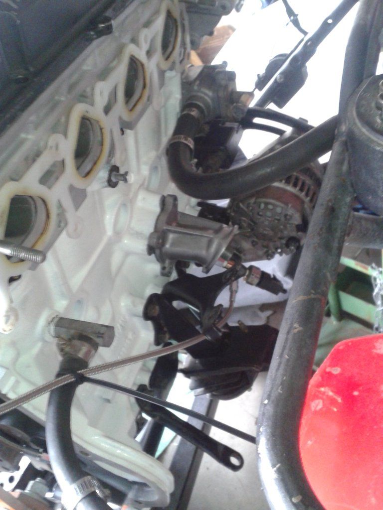

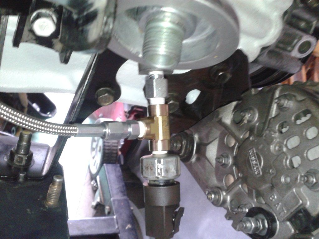

Oil feed setup
power steering on and water feed ready

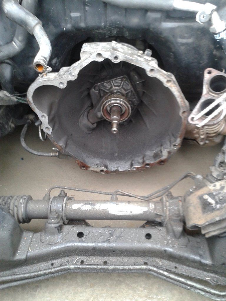

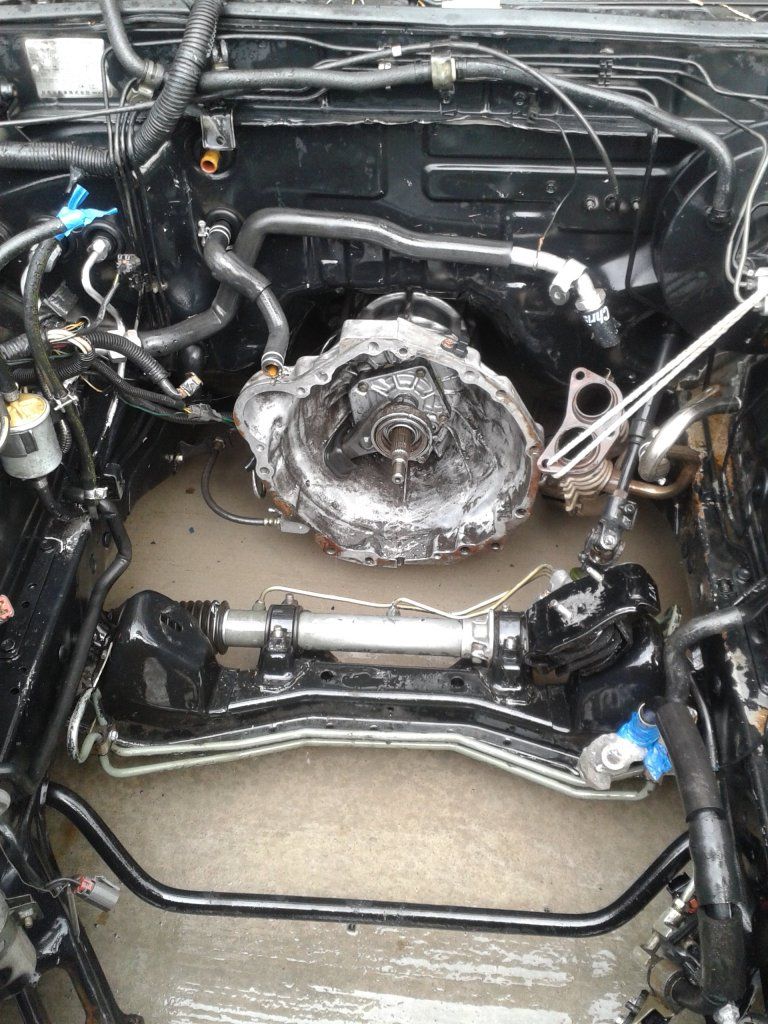

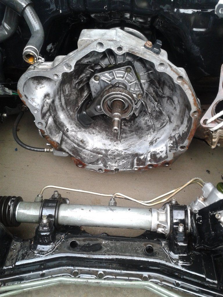

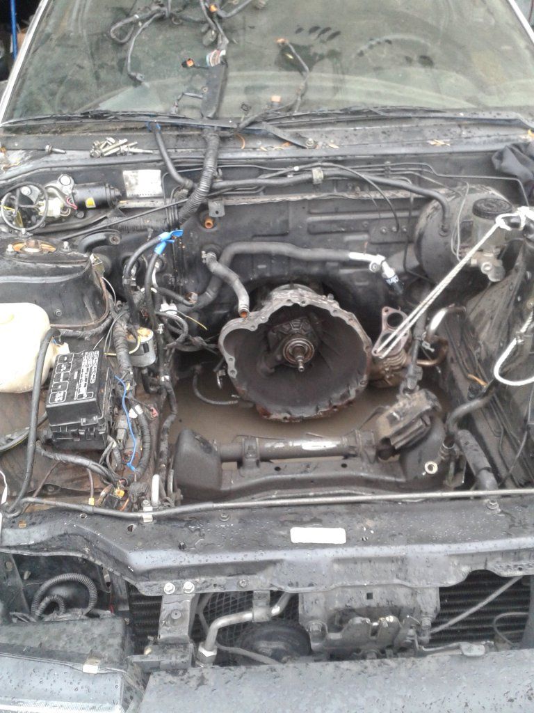

Cleaned my engine bay and transmission the best I could with an electric pressure washer
Before:
After:
I love how clean the power steering rack came out just need to get the car on a lift to pressure wash underneath, oh I also installed Energy Suspension power steering rack bushings thanks for watching guys.
Before:
After:

The oil feed is too long. The vibration in the KA will eventually crack it.
FWIW,
Mike
FWIW,
Mike

Are you talking about the t-fitting? Or the stainless line? What should I do?
Re: finally building my ka :-)
the whole thing is too long(not the line) and it will eventually crack. I did the same thing back in 97 when I first turboed my KA. I ended up removing the plug on the oil filter housing and re-tapped it for the turbo feed.

Thanks for the heads up I'll definitely change that around.
If you want to keep the oil pressure switch, look into a Honda oil feed adapter. I have been using one for years and it is a much bigger piece that resists cracking. plus if you have to go back to na you can just plug off the turbo feed port.
