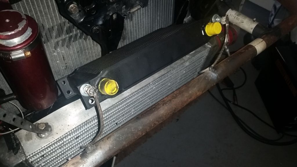

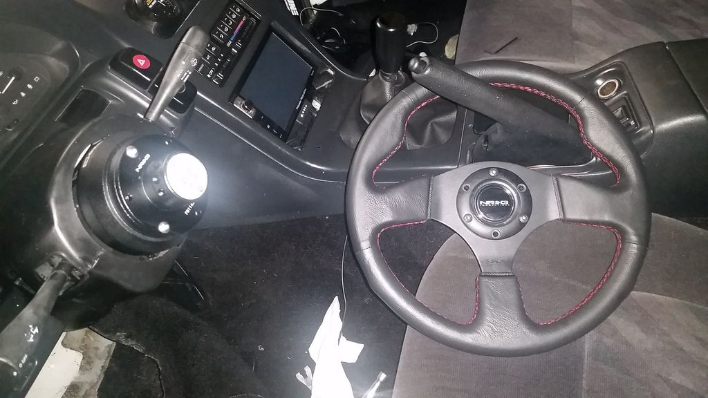

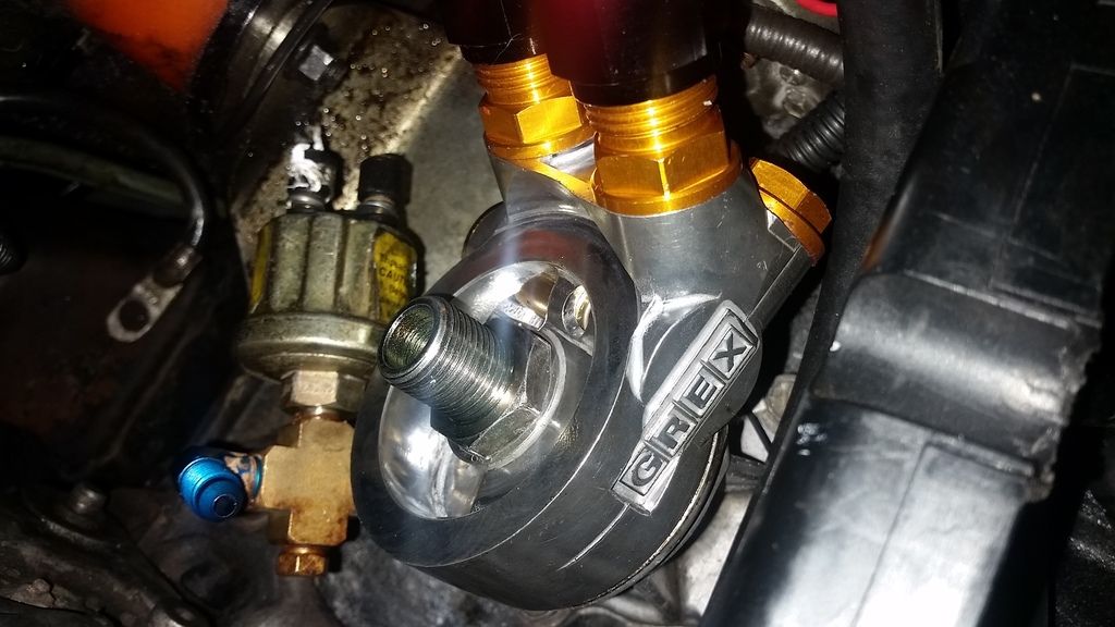

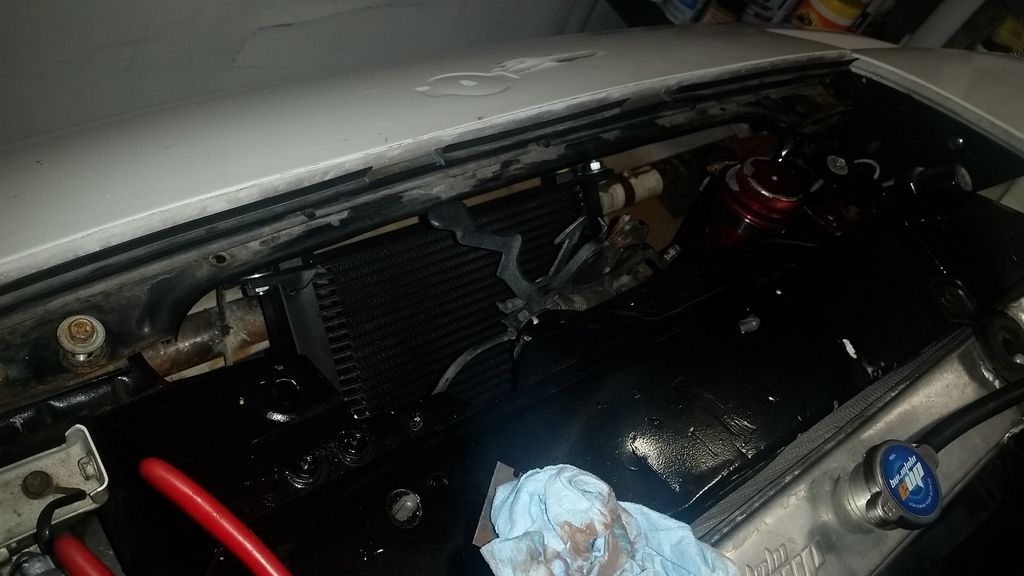

About two weeks around I made one run at the drag strip with my measly Cheap-O 225 street tires. I ran a 13.4 at 113, that was at 14ish PSI. I ran a second time and turned up my controller because I knew I would have to make up the few milli-seconds of the line, it spiked to about 18 psi in first and I could grab second fast enough LOL. It was fun, but that next morning my exhaust gasket blew and I found one of the bolts on my exhaust manifold was missing. I am attributing it to the spike to 18psi. So I have started a small over haul I purchased:
NGK Spark Plug Wires
Oil Cooler
Greddy Thermostat sandwich adapter
ISIS Steering Bushing
NRG Quick Release and steering wheel

Since I have had the car the Water Temps of the motor have been at about 200* This is in 100 degree weather or 60-70 degree weather. I thought that adding the oil cooler may change it abit but it didnt.
Over the weekend I put in a ISIS colder Thermostat and this has seemed to alleviate my issues. She warms to 160 and during highway driving temps went to 180*. My oil pressure is still the same, but I want it higher it is about 12-14 psi at idle, I am wanting it to go to 20 psi. I have some 15w-50 by Driven I want to try but for now I am running Rotella 5w-40.
