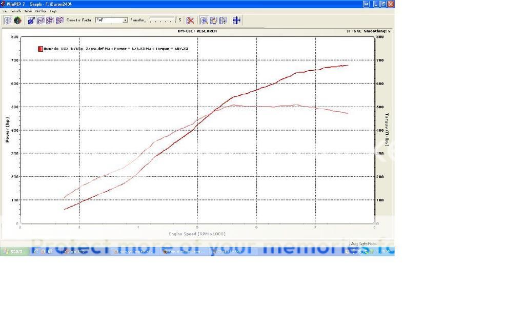

Its amazing what an intake manifold and high compression can do.... 684hp @ 33 psi with stock intake and over the counter Weisco pistons. I had a few bugs so had to cut the tuning short but stopped here for now.

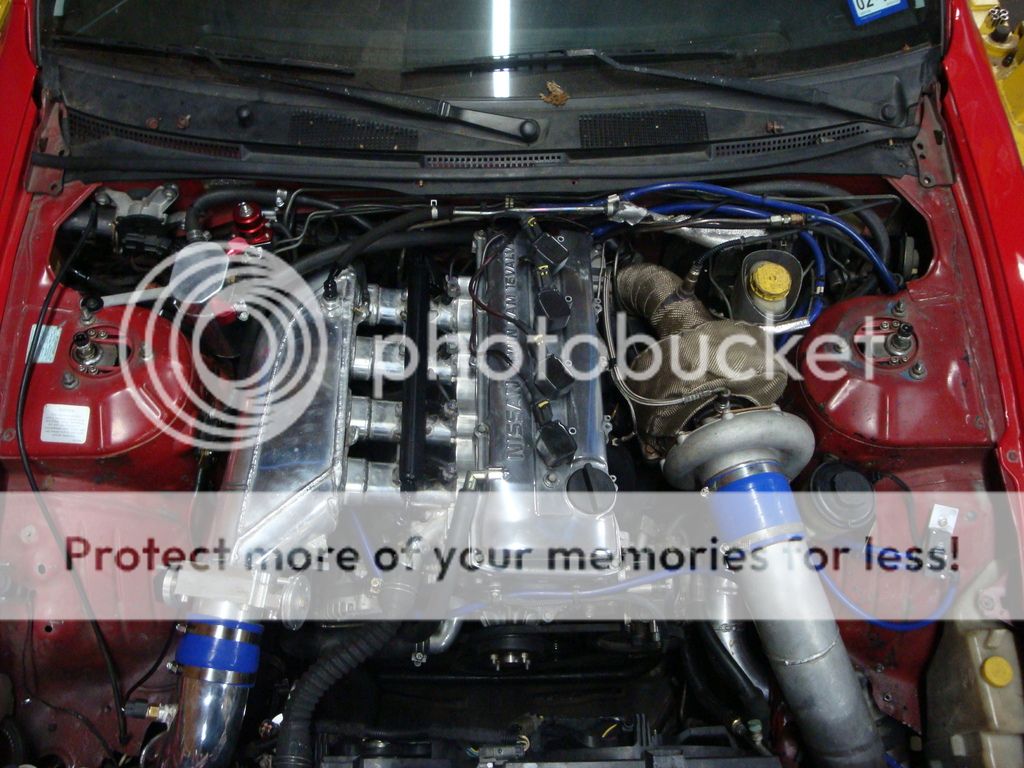

Here are some Engine Bay pics finished. My TPS sensor is reversed and to reverse the signal to the computer I switched the polarity by changing the power and ground signals and it worked however the voltage value constantly is changing which would make you logically think the tps is physically moving but it honestly doesn't seem like it is. I have also lock tight the throttle plate stopper but it still changes. I have also done a sweep slowly to make sure the TPS is working properly and it does sweep evenly. This is also the 2nd TPS because I thought it was a bad Tps but same thing. Is there a nissan tps that work reverse without having to be modified?

Looking good, brother. I had the same issue with the TPS sensor on that same throttle body. I also tried reversing it and it didn't work correctly. My solution was to break out the Dremel, make a little hole, and then mount it "upside down"...
It has worked perfectly like that for over 5 years. I think I looked at the possibility of taking apart the throttle body and reversing everything and it either seemed like too much work.... or possibly there was another issue that I saw with doing that. It's been so long that I really don't remember the exact reason. It was either laziness or something... more... technical...?!? :cool:
