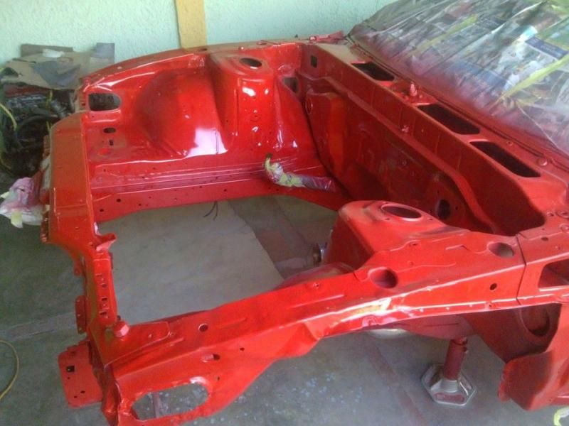

This is the paint job that I did to the engine bay

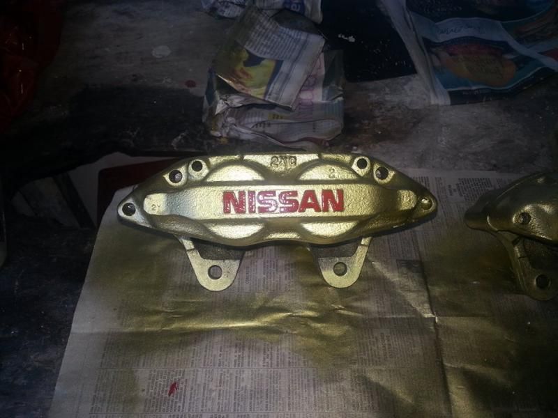

Brake swap in progress
Painting Front Calipers

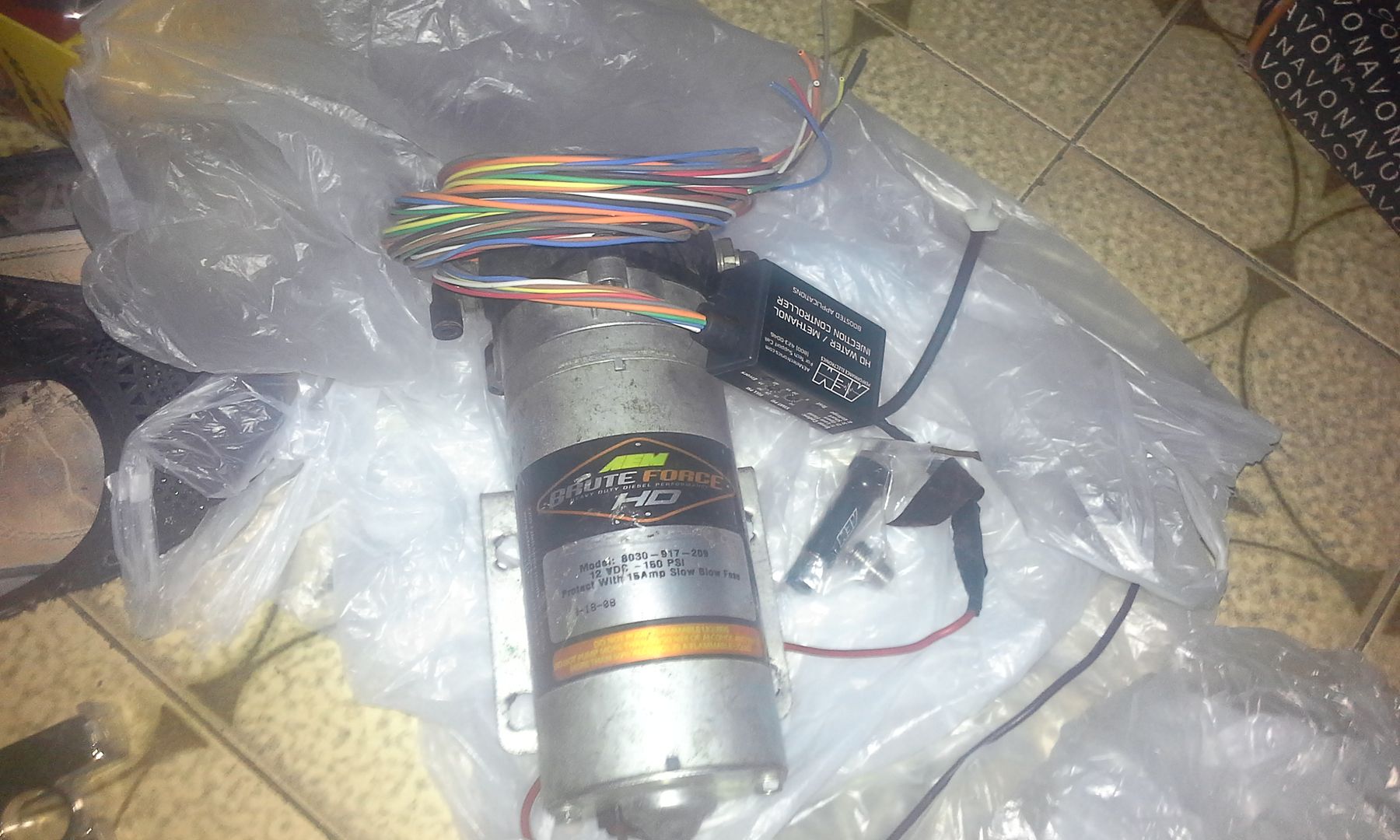

Found a good deal on a used Heave Duty Methanol injection kit

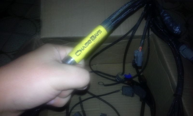

Post by 240sx-venezuela » Thu Jan 21, 2016 8:48 am
Had a great oportunity to buy an used Chasebays wiring harness very cheap, 150$ from a very good friend, he installed this wiring and his car didn´t run because the tps comes wired for universal type, but the technician didn´t know that, after changing all sensors, the tech guy maybe (**** guy) said that he didn´t know were the problem was, then my friend toke the car to another technician and bought a Wiring Specialties and it runs fine, the the tech guy saw were the problem was and intalled the wires correctly and problem solved.
I must say this wiring is awesome, its very light compared to stock, weight less than half the stock does.

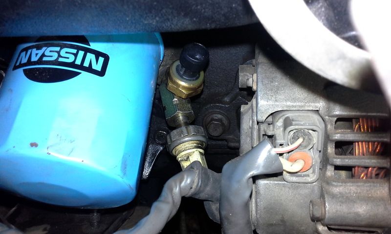

Post by 240Life » Thu Jan 28, 2016 9:44 am
Now correct me if I'm wrong but you have the stock pressure sensor on the end and an aftermarket on the side? Where do you plumb in your feed line?

Post by 240sx-venezuela » Thu Jan 28, 2016 9:36 pm
240Life wrote:Now correct me if I'm wrong but you have the stock pressure sensor on the end and an aftermarket on the side? Where do you plumb in your feed line?
Josh

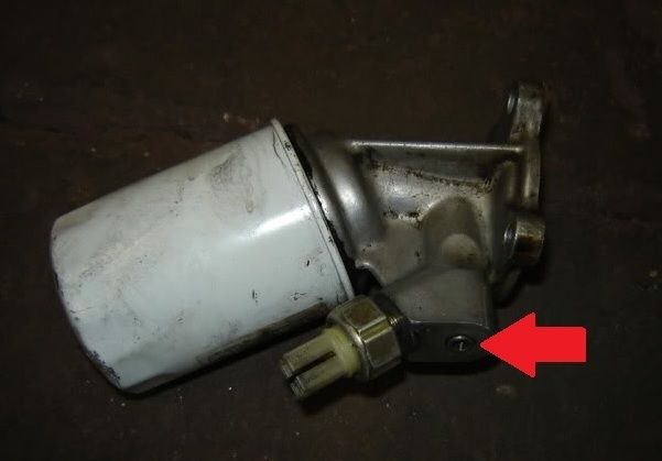

You are right, aem oil pressure sensor on the side and stock on the end, just in case, sometimes its easier to see a no pressure light on than seeing numbers and decide if its low or not.
For the oil feed I've removed an insert nut that is placed in the oil filter block, then threated to 10mm, putted an AN3 fitting with a braided steel clutch line wich is AN3 too, Ill post some pics for best explanation

Post by Cute240sxGuy » Thu Jan 28, 2016 11:47 pm
Josh
This one here correct?

Post by 240sx-venezuela » Fri Jan 29, 2016 7:15 am
Thats the right one
