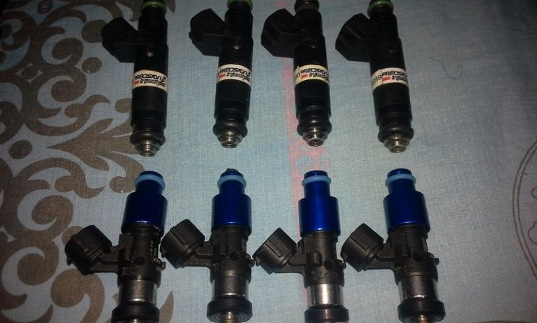

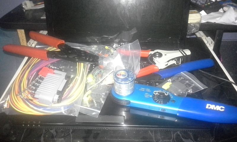

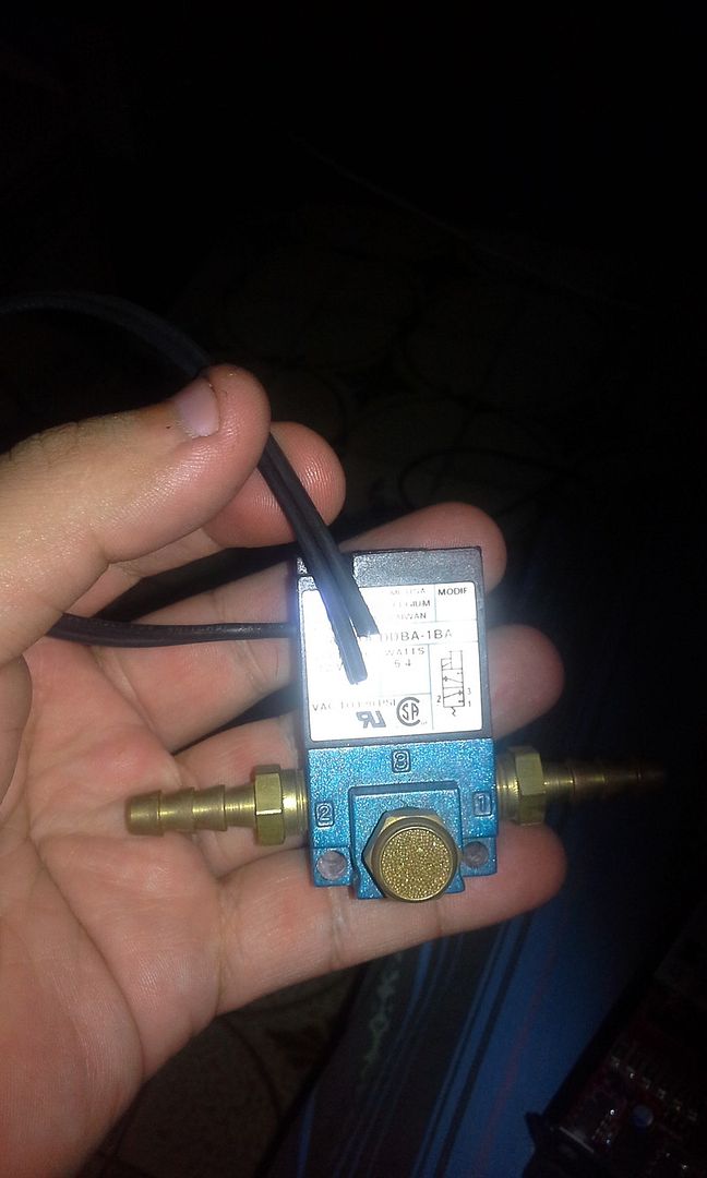

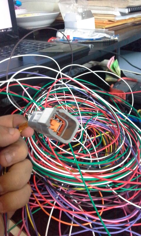

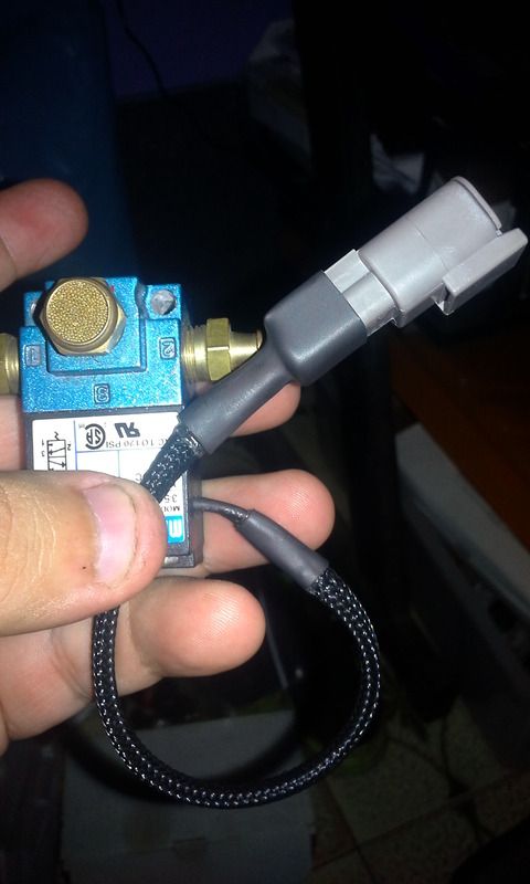

Back again, some free time to post LoL, I´m putting some things together to complete my chasebays wiring, to test it in my car and then buy some good material to upgrade it, and maybe fabricate some more wirings to sell them :D , since the wiring I bought doesnt have the boost solenoid and coilpacks portion I have decided to fabricate it.
Some progress so far
Old precision turbo injectors and new Bosch Motorsport 2200cc injectors

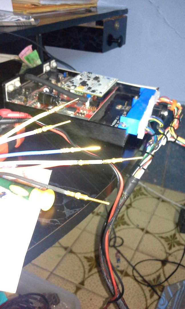

Installing a Dual Vr Board to avoid any noise in the MSPNP with Vr sensor.
Some tools :D

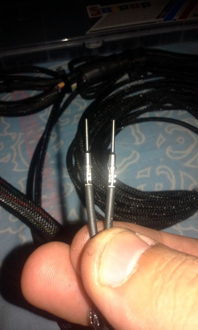

Post by adamky » Sun Mar 27, 2016 7:09 pm
Nice work. I love the nylon braid over the wires. Gives it a very professional look.

Post by 240sx-venezuela » Mon Mar 28, 2016 10:45 am
adamky wrote:Nice work. I love the nylon braid over the wires. Gives it a very professional look.

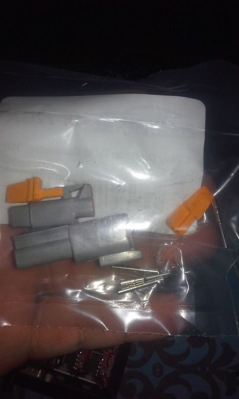

Thanks man, that will be temporary, because I can´t wait to get my car running :D , I will be using Raychem DR-25 Shrink tubing and Raychem Atum for the terminations wich are for a real durable wiring.

Some improvements to the PNP2 to get a better signal from VR crank sensor

Long time without posting, tested the vr sensor setup with the pnp2 and dual vr board 2.1a which is working great, I'm happy with the results, will switch to full sequential injection soon and upload some videos
