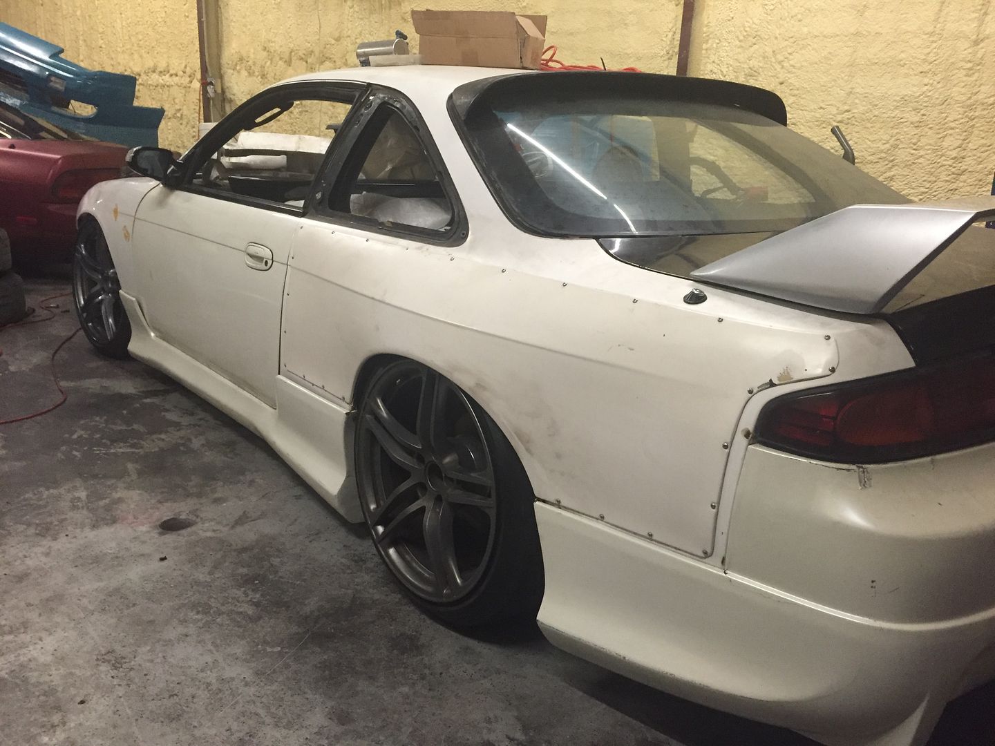

Car came to me 4 lug on suspension that I had to give back to the importer. This was fine since I had some stance coilovers, cusco arms, and some Audi R8 wheels just waiting to go on something. Called my friends at Executive8 for some 5 lug parts and he happened to have some Silvia 26mm brakes at his shop that would be perfect for my car. I automatically knew that I was going to use my built KA from my other S14 for this car since my other car has a 2J waiting for me to install it.
Oh yeah I got all this to build with my said GF, then we broke up.
So I was like ***** it. I build it when I want and how I want since I already got all of the **** for it.
So current mod list
KA24DE:
-twisted motion 3076
-.20 over
-wisecos/eagle rods
-264/264 cams
-MS2 PNP
-740cc injectors
-greddy type s
-greddy FMIC
-TiAL F38
Wheel/Suspension:
-Audi 19X8.5 19X11 R8 Wheels
-Stance Coilovers
-Cusco Front Tension Rods
-Cusco Rear Upper Control Arms
-Cusco Rear Traction Links
-Cusco Rear Toe Links
Exterior:
-Random 90's Aero
-eBay Roof Wing
-K's Wing
So current mod list
KA24DE:
-.20 over
-wisecos/eagle rods
-264/264 cams
-MS2 PNP
-740cc injectors
-greddy type s
-greddy FMIC
-TiAL F38
Wheel/Suspension:
-Stance Coilovers
Exterior:
-Random 90's Aero
-eBay Roof Wing
-K's Wing

Had to get my mind off some things, so I tore down the KA to freshen it up. Also got started on the cage. Its gonna be reallly shady, but it just needs to pass inspection for pro am lol.
Re: KA-T Silvia S L I D E Thingy
Can't wait to see it done!
Wow those audi wheels look great! Remind me of AVS model 5's
