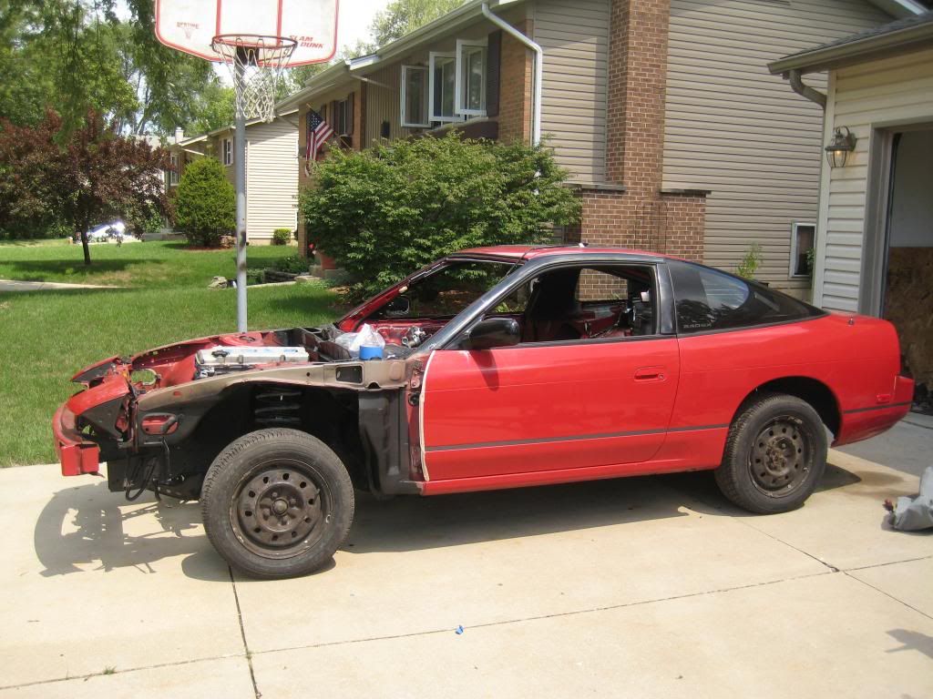

Post by s14boy » Fri Nov 09, 2012 11:44 pm

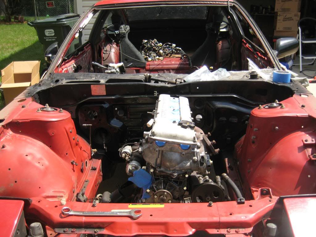

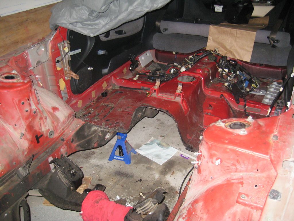

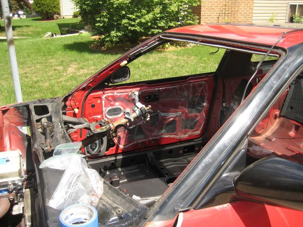

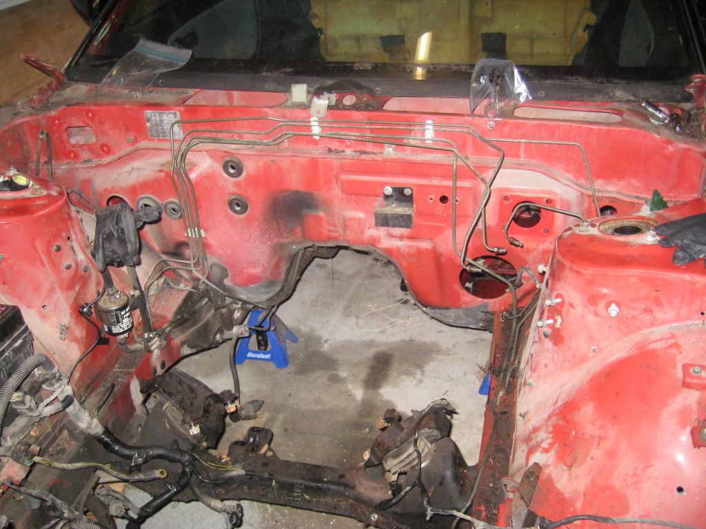

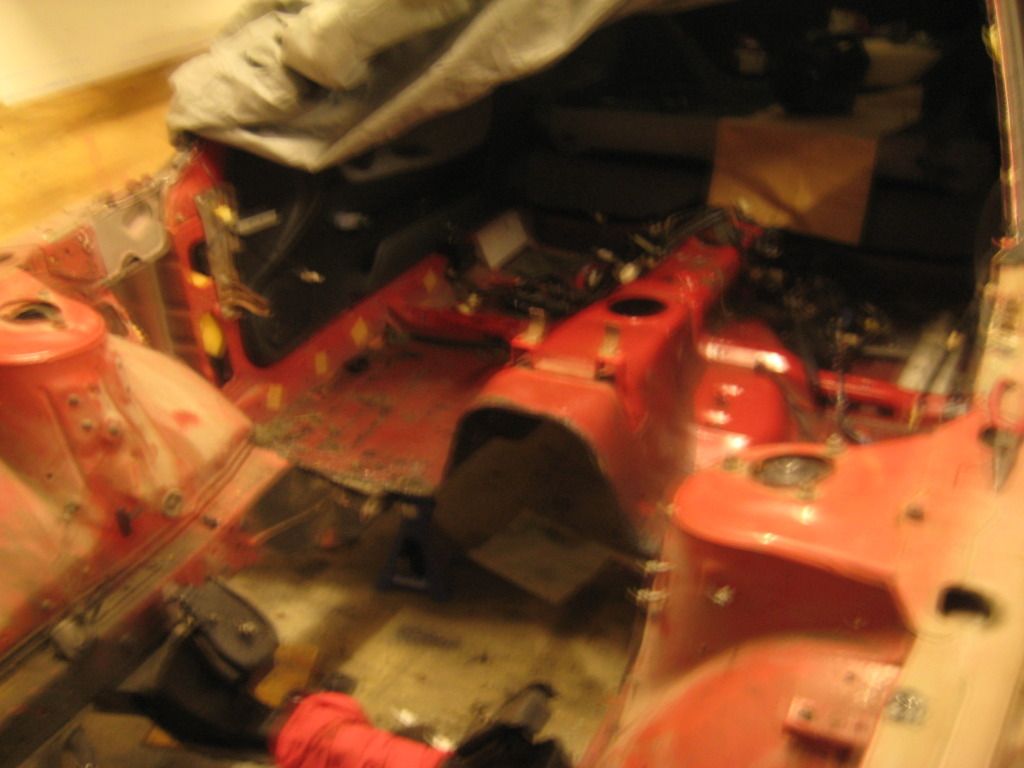

thanks guys i wish ka-t had the multiquote function like zilvia. or maybe it does and im just not on here enough. but i finished the welding im off at school right now so i cant get pictures but ill post what i have. first time welding so it was interesting and i did blow holes it that thing a few times. that was very frustrating but i jst left it and came back later when i want pissed at it lol. picture time. and it should be running the 16-25 when im home for thanks giving :)
how its sitting right now. i wana drive it so bad
yep good old ka! :)

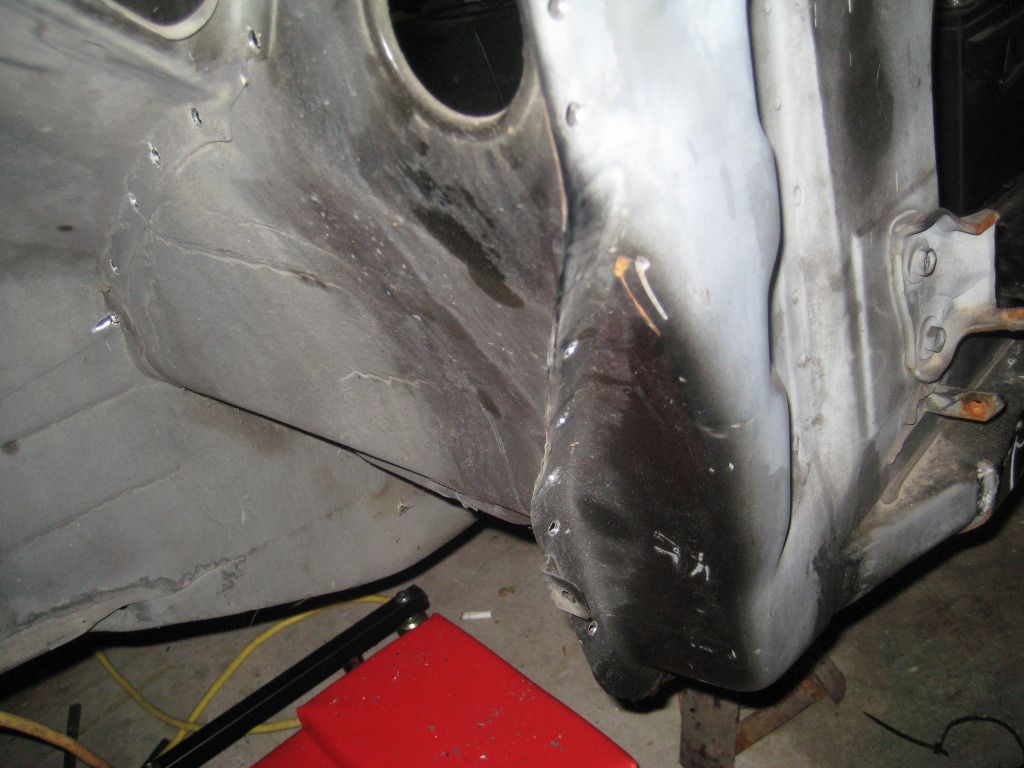

and does any one have advise for that ***** dent in the fire wall gutter. guy i bought it from "forgot to tell me about it" i was pissed lol. but you dont notice it really but i deffinatly am gona fix it and would like your thoughts.
thanks guys!

Post by s13halfs15 » Sun Nov 11, 2012 6:39 pm
s14boy
Posts: 46
Joined: Mon Feb 13, 2012 11:26 pm
Post by s14boy » Mon Nov 12, 2012 2:55 pm
ill give that a try in about a month when im on winter break and let every one know. its just a very odd spot and has any one tried pushing with that tool instead of pulling. in essence it should work as long as you keep it straight.
