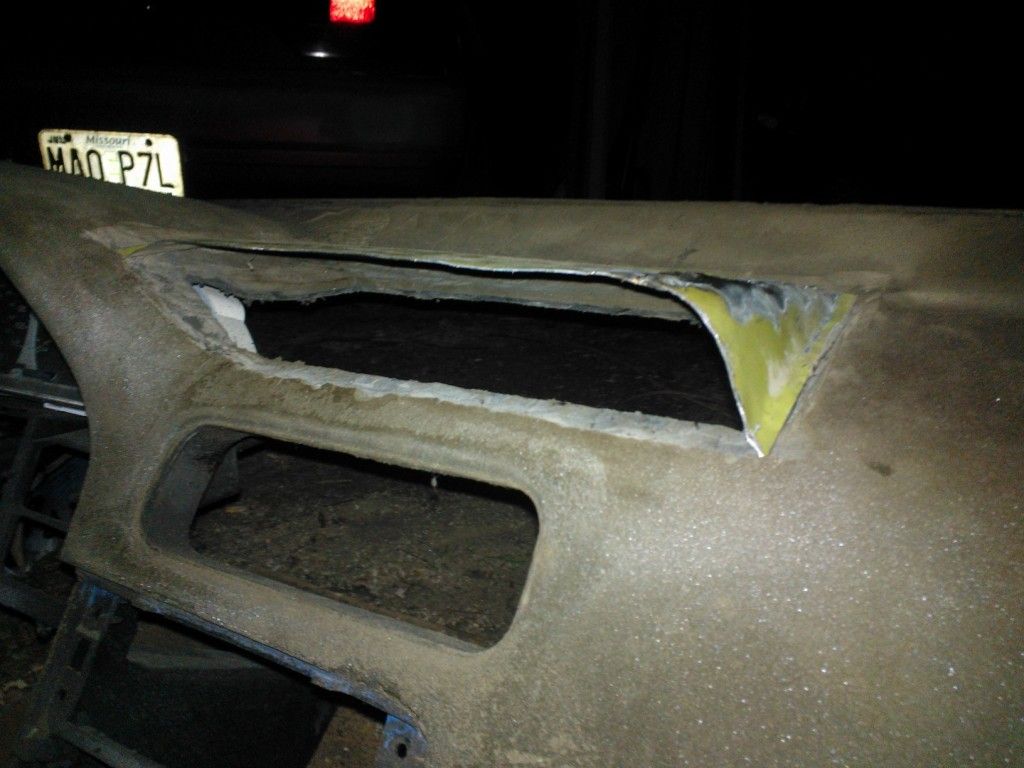

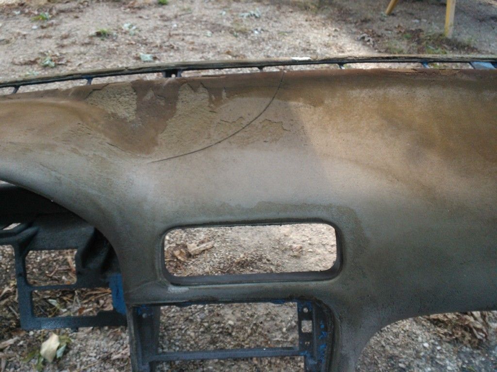

I pulled this dash out of the white car that i was doing work on and the guy had sadly molested it. it was originally black and he painted it blue and white.... since there was no fixing the damage that was already done i decided to fab gauge cluster and then im going to carbo fill the seems and then Slicksand the whole thing and finish it. after all this work im going to have a fabric place wrap it.
btw i chose to go with metal b/c i can bend it to make it fit a bit easier than other material and plus the metal that is use to fab this up is off of another 240sx thats junk lol

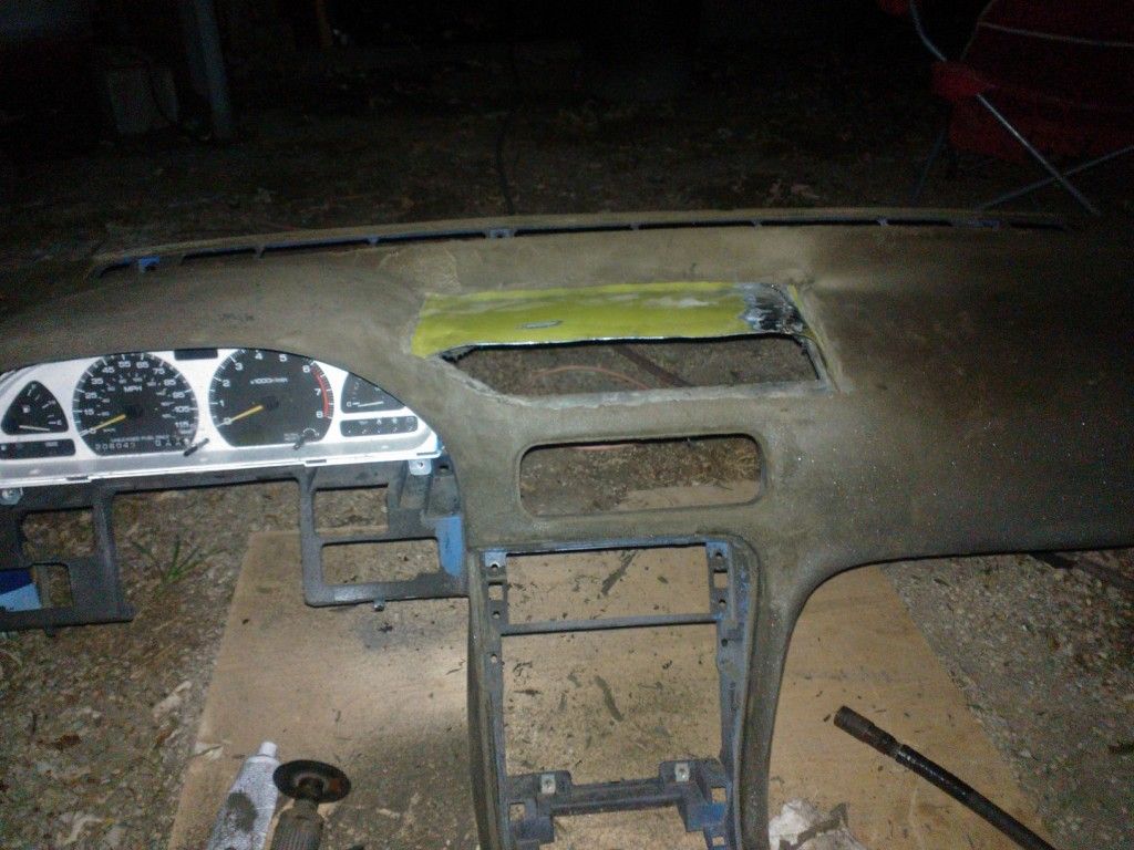

Post by 500hpKA240sx » Thu Aug 30, 2012 1:48 pm
sorry for i have not updated in a few days im waiting on some gauges so i can clean the holes up and have a perfect fit and then ill mount it down so hopfully by the end of the weekend ill have it almost done.

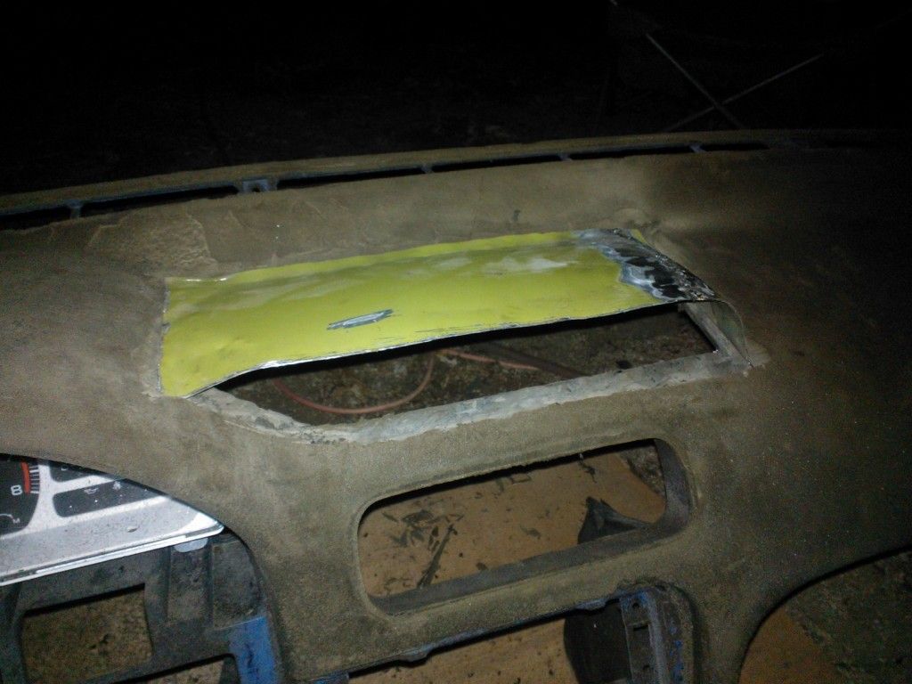

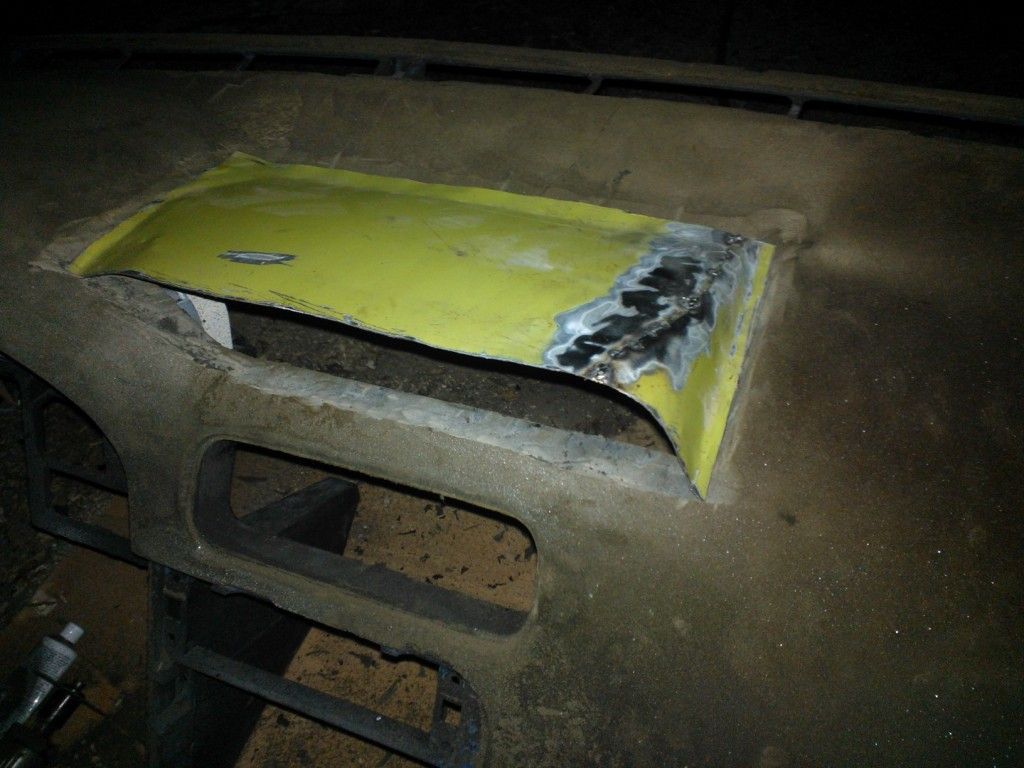

Post by 500hpKA240sx » Wed Sep 05, 2012 3:24 pm
i got it pop riveted in and then i glassed it then carbo-filled it. so now i just have to smooth it out and if it wont cost me an arm and a leg ill have it wrapped...

Post by 500hpKA240sx » Mon Oct 29, 2012 2:44 pm
Super Coupe wrote:My only concern is the body filler cracking over time from the vibrations and flexing.
its not a light weight filler its SEM's Kevlar filled filler and its glasses over top it wont crack.

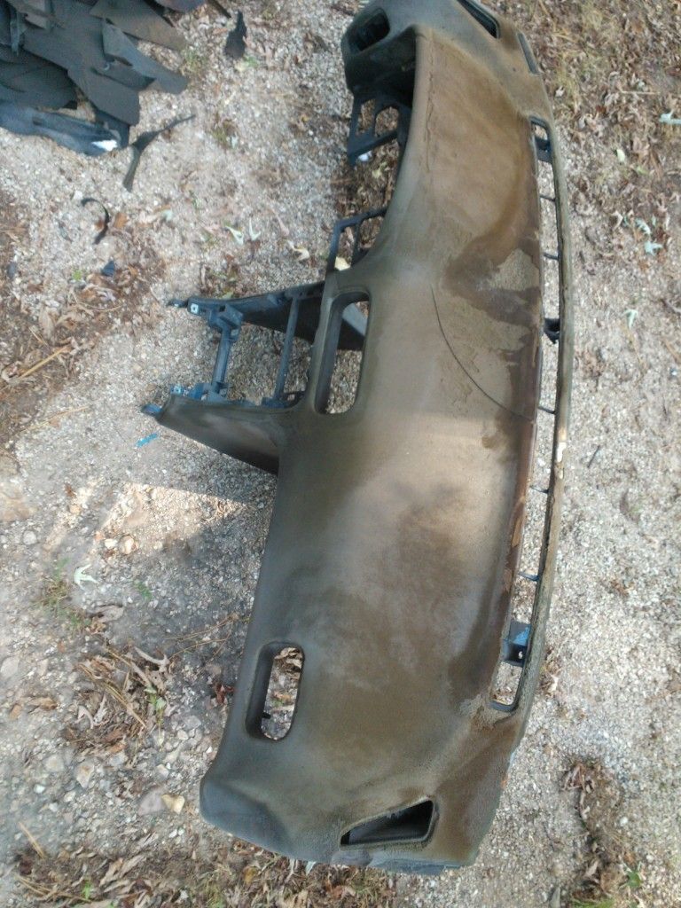

Post by 500hpKA240sx » Tue Jan 28, 2014 8:22 am
the pics are not out of order? this is where it sits.. my car stopped turning over and so i pulled the dash to finish it. where the 3 gauges sits is where the center vent goes. and where they where located I havent cut the holes yet I got a fcukin case of some viral infection in my throat and I went to the ER.......fml. but im back home and it will be finished soon. and it wont go in the car until 100% finished. I have a good job now and I went and bought everything I need to finish it :mrgreen:
