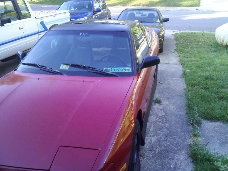

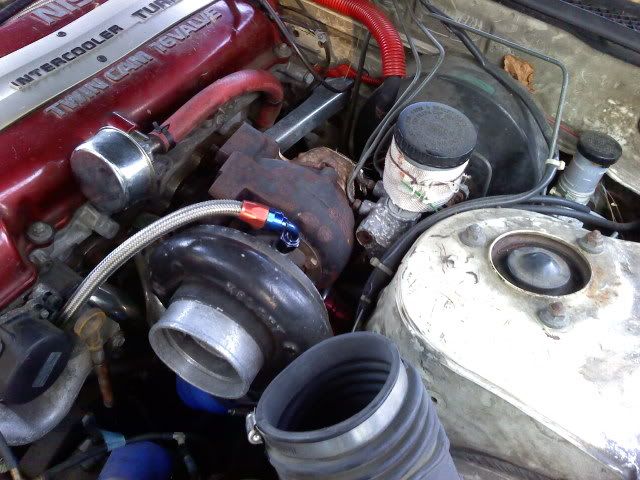

Post by mookhaasa » Wed Sep 07, 2011 4:58 pm
*Update.
I got the Red hatchling running pretty good, I think I might throw it back to the Auto ECU.
Also in the mean time I found an HX35 with its wastegate already welded up and a nice sized wastegate.
Here is a pic of it on a NAPZ24 motor I had on the floor.
Here is the same turbo on its former set-up, resting nicely on the BMC.
And the red Hatchling as is
Red 1989 240sx. Rb20det
