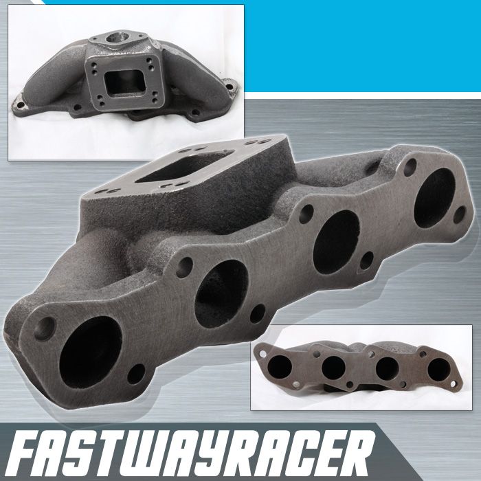

I use that fastway log mani, emusa dp, emusa midpipe, emusa straightpipe, ebay cat back. Fit PERFECTLY.
Ill get pics up once I bolt everthing back together, but this is all I found
