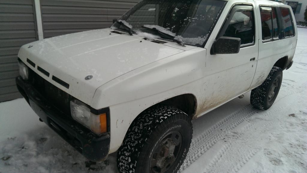

as i said i would post my update here, my 8 day permit on the truck just ended. it ran strong but im having a surface prep issue with a head gasket. coolant is in the oil and compression is good. but the oil pressure light is on, im pretty upset about it but i need to bear down and solve the problem. she runs, sounds, and looks good otherwise. on with the photo's
click to browse photobucket and view full size.

since the pics i hooked up the vc hardlines in the front and coolant overflow. many little things to mess with but im not worried about anymore. i would like to go vg33e and prepare that engine outside of the truck with more attention to detail, and without being rushed to fix my dd, for a weekend swap. i bumbed rides to work for over a month before i could afford to get this thing to where it is
