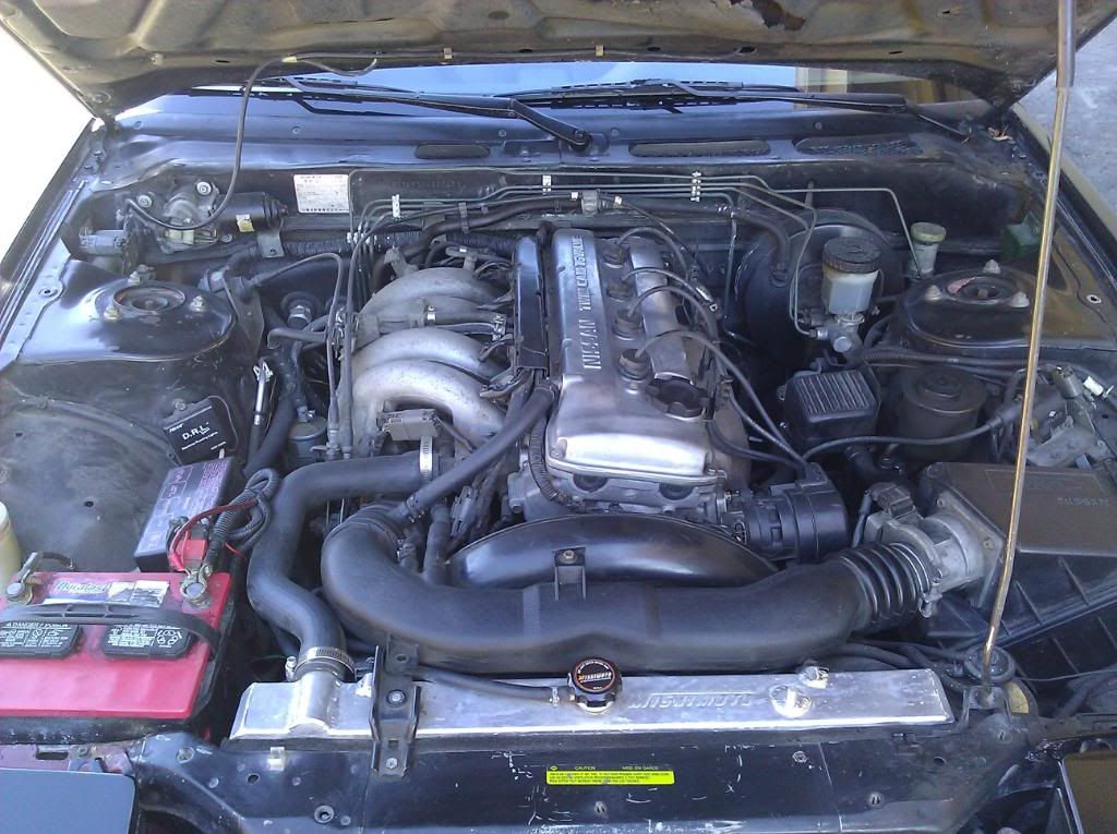

So long story short, in 2010 my engine bay looked like
After putting some miles on the car I started to find all the bugs with it. The car didnt have a thermostat, So I installed one then my car started to get too hot. Turns out my lower radiator hose wasnt getting warm at all so I replaced it and all was good. The previous owner also rigged the pop-up headlight motors in a sketchy way and the driver motor burned out. So I replaced that too.
Now, my engine bay looks like

Post by mmmS13 » Tue Feb 05, 2013 9:07 pm
Current interior poor cracked dash :?
On the drive home from class today I stopped at a light, and my car almost went poop on me. Would barely hold idle at 450rpms and seemed to struggle and would be rich between shifts, also would bounce from rich to lean on the wideband after letting off the throttle on the highway. Get to investigate that after class tomorrow, should be lots of fun.

Post by mmmS13 » Wed Feb 06, 2013 6:07 pm
Its just a simple tube I got from a hardware store. It has some flex but its pretty stiff
ATL240 hopefully that helps :D

Post by ATL240 » Wed Feb 06, 2013 6:46 pm
Thanks for picture! I'm gonna have to get that inlet welded on to the intake. Fun stuff. ehh

Post by LPime001 » Mon Feb 11, 2013 3:56 pm
mmmS13 wrote: On the drive home from class today I stopped at a light, and my car almost went poop on me. Would barely hold idle at 450rpms and seemed to struggle and would be rich between shifts, also would bounce from rich to lean on the wideband after letting off the throttle on the highway. Get to investigate that after class tomorrow, should be lots of fun.
Sup buddy,
Just saw your newest street kill. I guess you resolved your idle and fuel issue.
What was the problem?

Post by mmmS13 » Mon Feb 11, 2013 4:28 pm
LPime001 wrote:
Sup buddy,
Thanks man, I found a vacuum leak :p Idle is still a little sketchy but ill bump it up soon and all should be good.

Post by ATL240 » Mon Feb 11, 2013 4:49 pm
Has your idle always been like that since you boosted? Mine acts like it wants to turn off ever since I got an enthalpy tune. My wideband reads lean on idle so that could be it( not getting enough gas). I think you and I have the same exact tune: 810cc DW, Z32, t3/t4

Post by mmmS13 » Mon Feb 11, 2013 6:01 pm
I think my idle has been like that since NA, although it wasnt as bad until I went turbo. Like I couldnt stop in neutral from 40 mph ever since I bought the car.
ATL240 did you delete your egr? I used a block off plate and left the wiring stuff.

Post by ATL240 » Mon Feb 11, 2013 6:23 pm
Yes, and I used a block off plate as well. At first I had it with only the gasket included with the plate but was having boost leaks. So I JB-welded the plate on. No more boost leaks there :)
Removing the EGR properly will not affect idle though. Hmm your stalling issue is weird.
