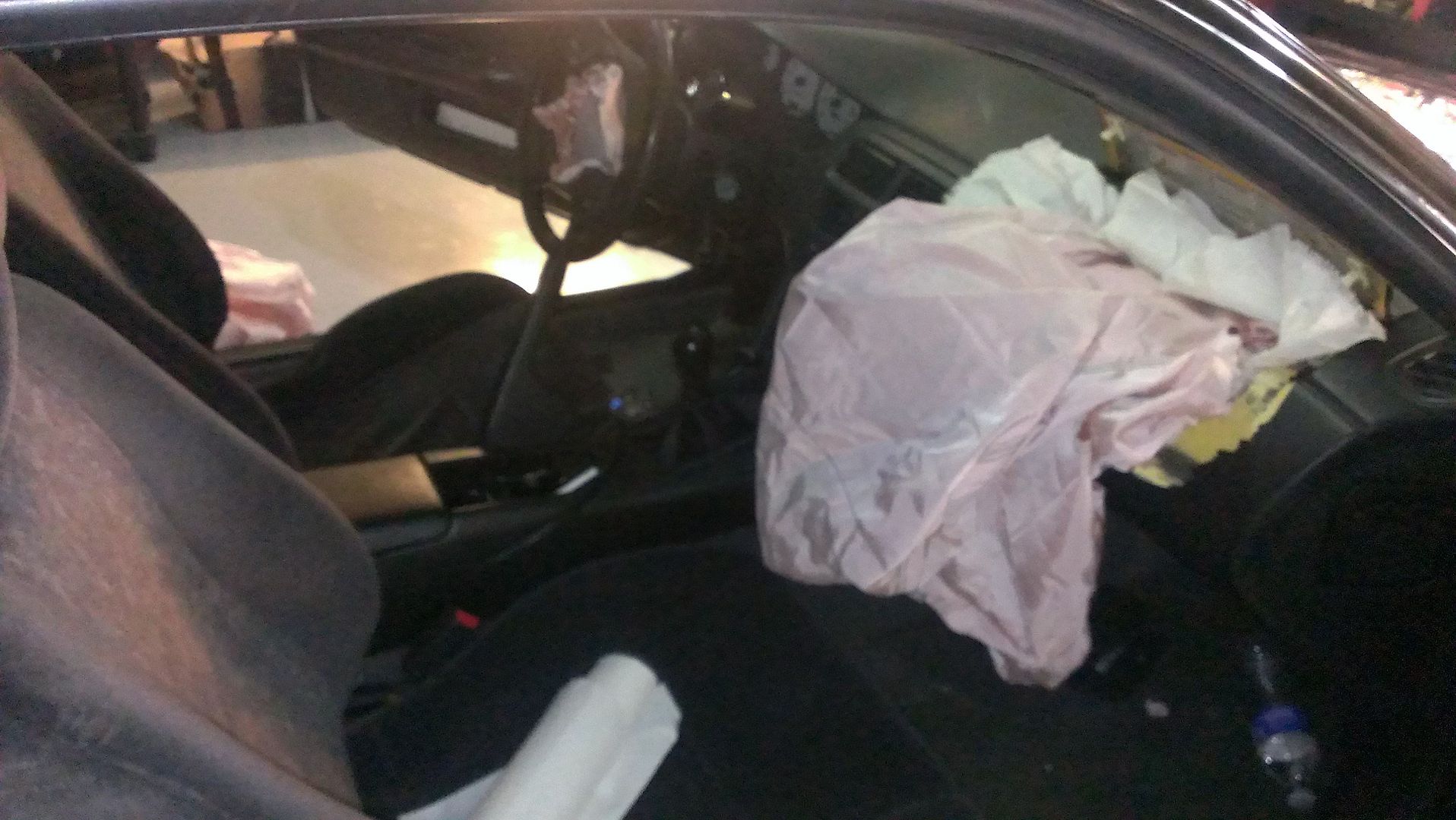

Lesson learned... next time I'll pull the airbag fuse at the track! And next time I'm at the track I'll be running a Z32 trans. It's a strong trans, so the weak point will then be my axles.

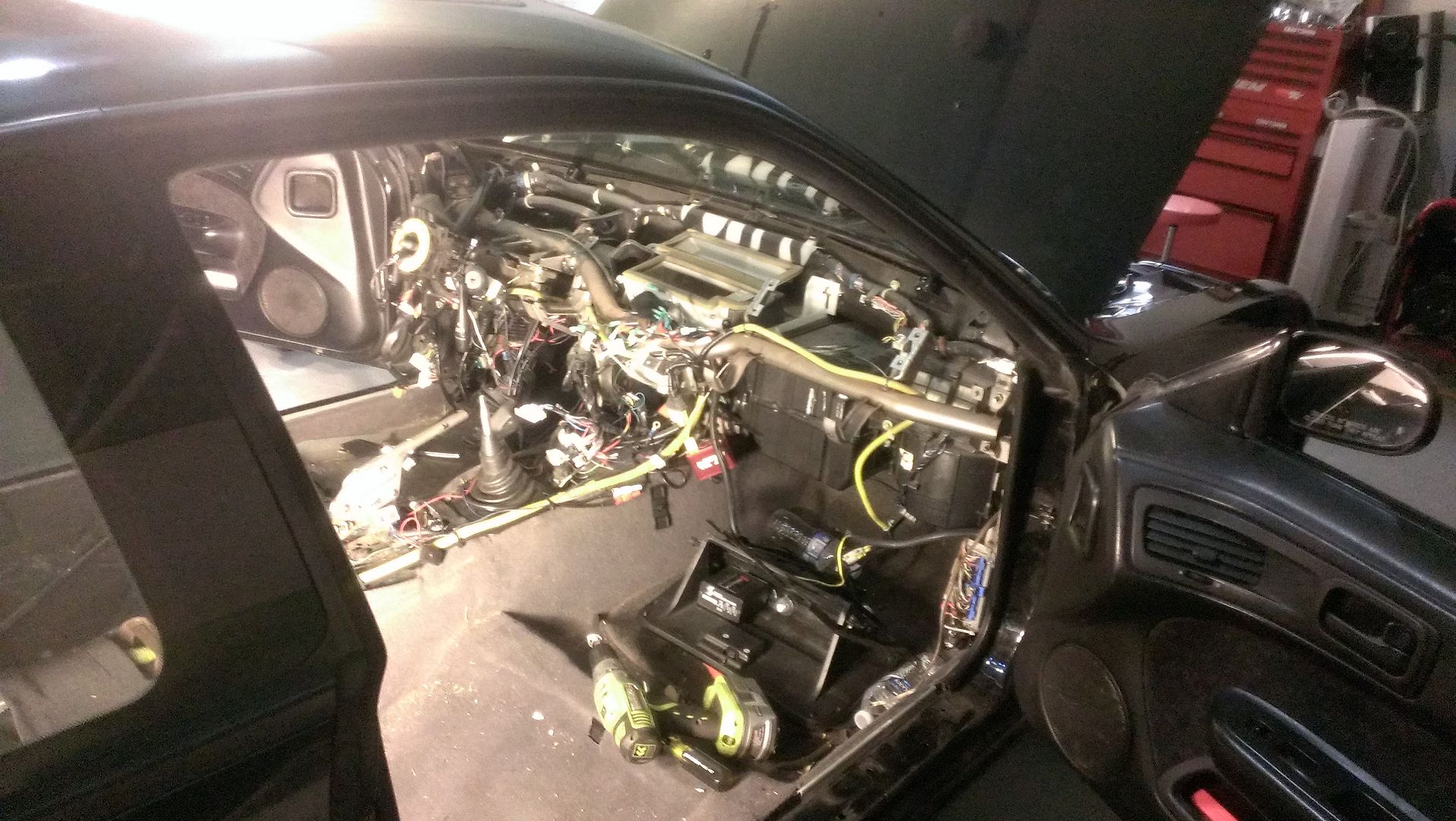

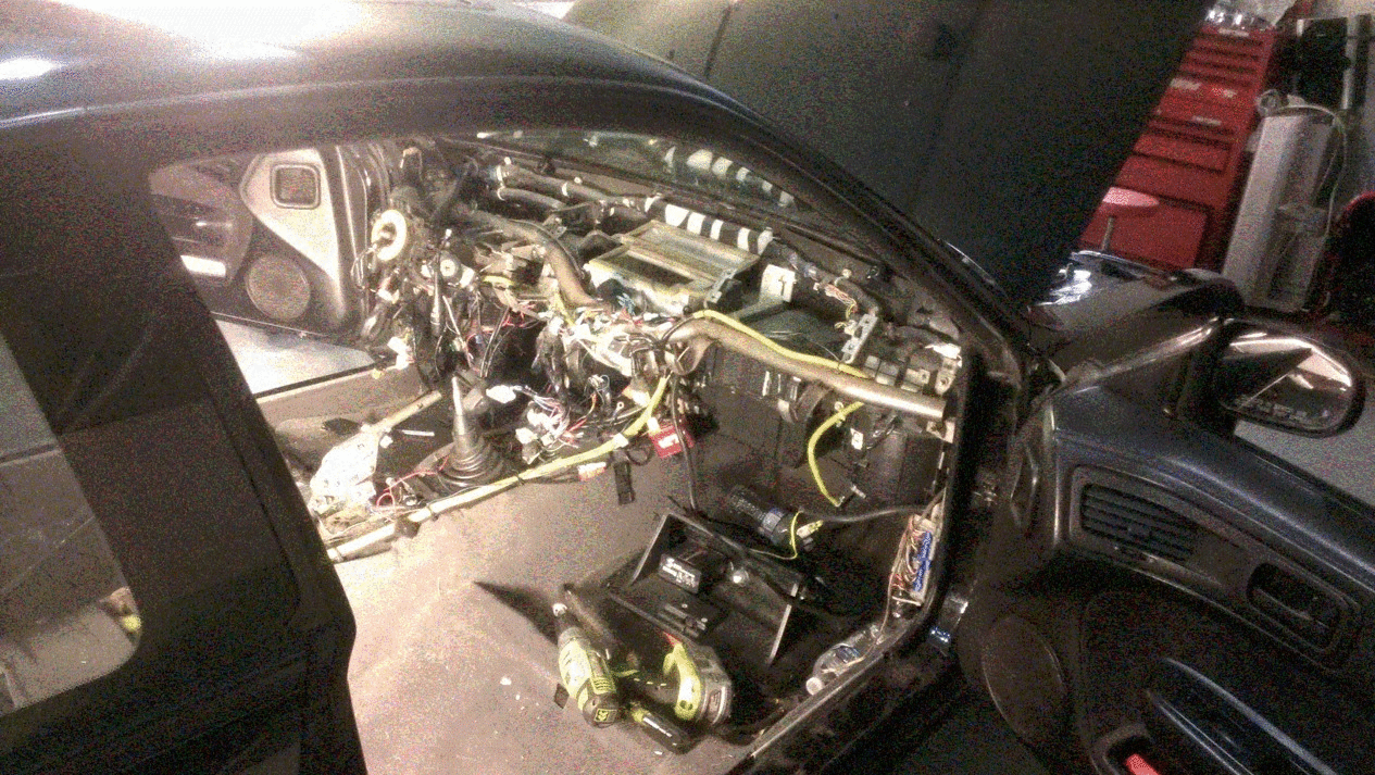

I got the dash almost all the way out today. I just have to remove the steering wheel and it should come right out. I'm supposed to pick up another dash some time next week from a local guy. And another local guy has an S14 steering wheel with intact airbag and also the cruise control switches/buttons. I'm going to put airbags back in and I'll just pull the fuse when I hit the track.

That's good to hear. I got the dash out today. Overall it was much easier than I thought it would be. We'll see how it all goes back together though... I still need to acquire a dash, passenger airbag, and steering wheel/airbag.

So, it turns out that my transmission is fine and I actually have a broken driver side axle. Of course, I realized this AFTER I removed the transmission. So, the stock trans is going back in. No need to replace it when it's still working fine.
I'm kind of surprised that an axle snapping was enough to blow the airbags. The trans output shaft snapping... I could see that blowing the airbags since there's some type of airbag sensor right on the back of the trans tunnel. But the axle... weird.

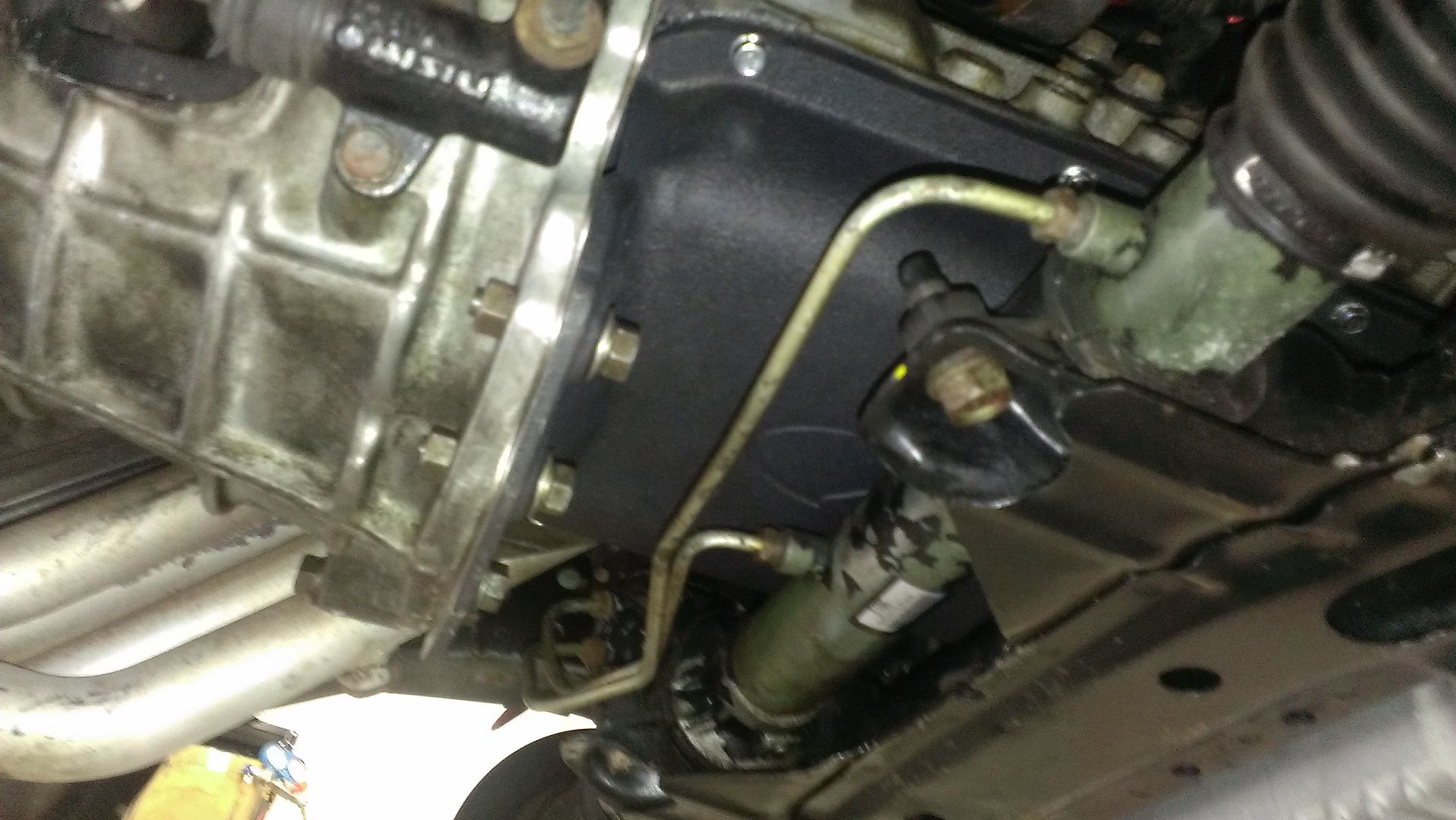

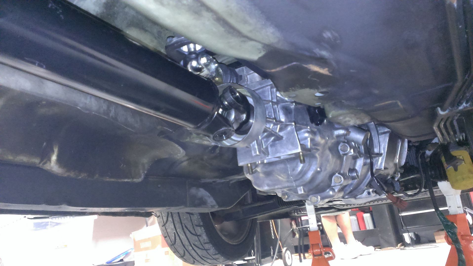

I finally found a dash locally for $400. Really happy about that. While I'm still waiting on parts to start putting everything back together, I went ahead and threw my Xcessive oil pan w/ Isis Sr20 lower pan on the motor, as well as replaced my constantly leaking coolant overflow tank with a new one from Circuit Sports. The new coolant tank looks sooooo much nicer than the old one, and plus it's more tucked over out of the way.

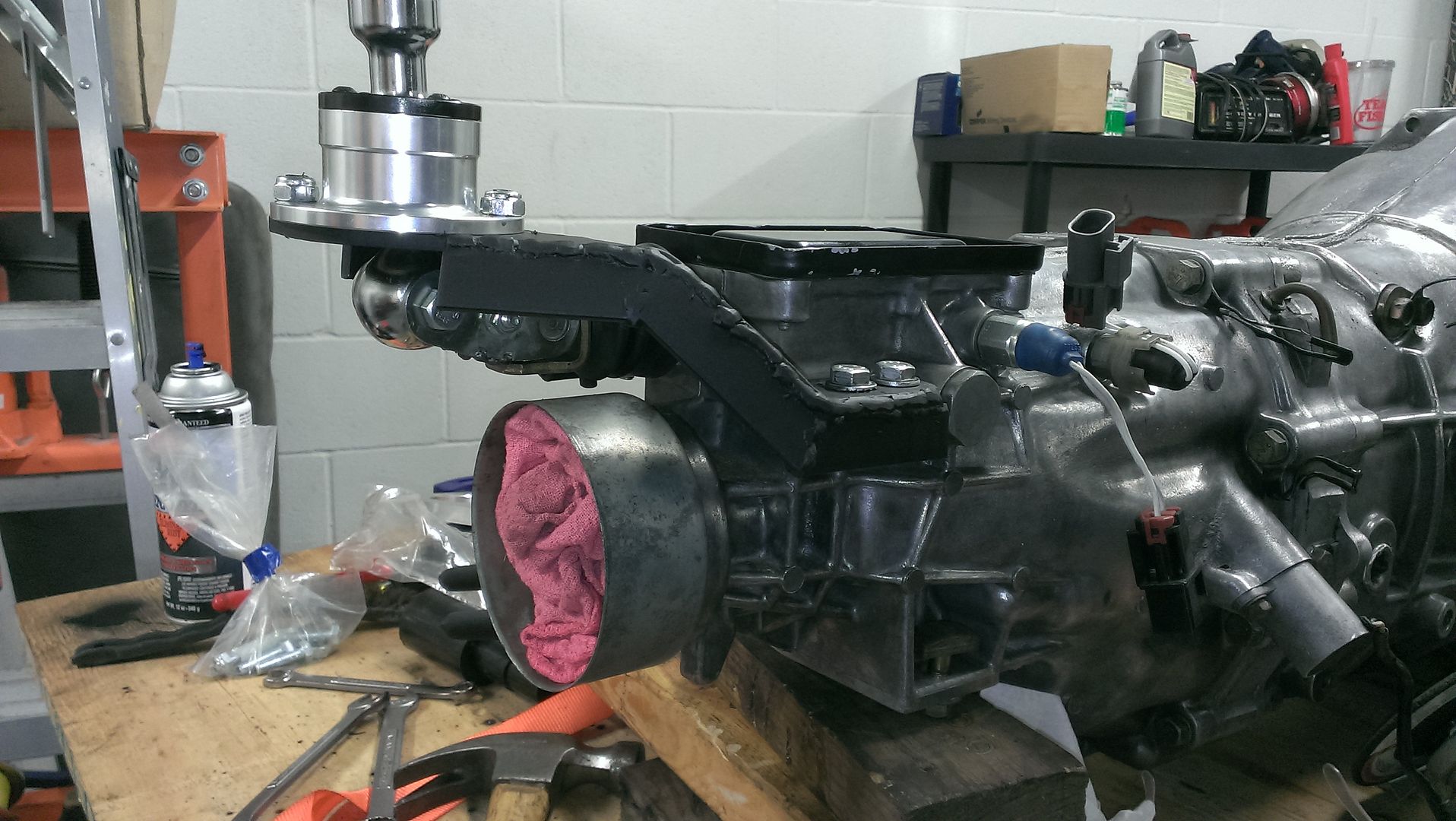

Keep in mind that the trans mount isn't attached in these pictures, so it's all tilted back more than it will be. The only thing that sucked about installing the pan was that I had just installed the transmission for the first time completely by myself with the aid of a trans lift. After removing the stock pan, which was leaking all over the place, I realized that in order to get the Xcessive pan in, I was going to have to remove the transmission again.

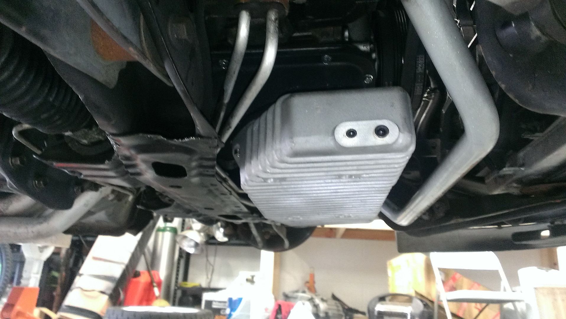

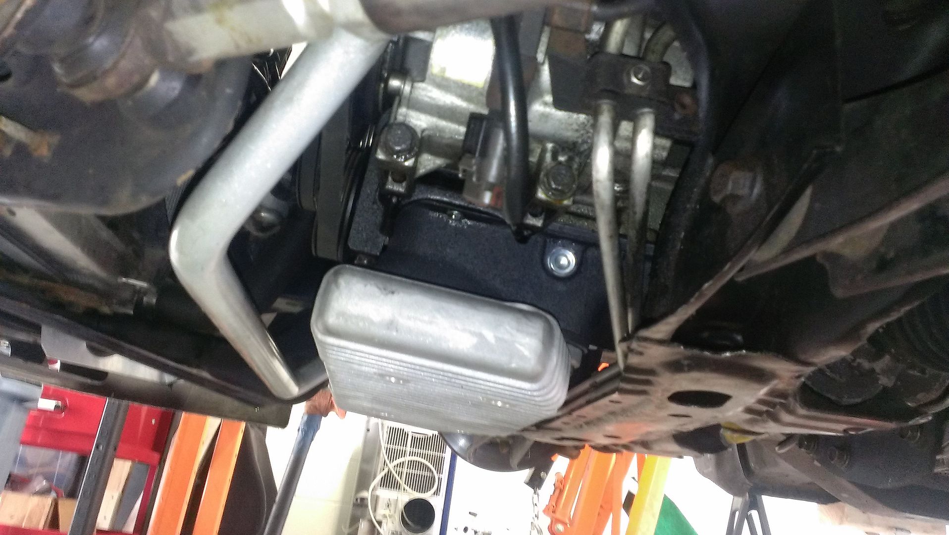

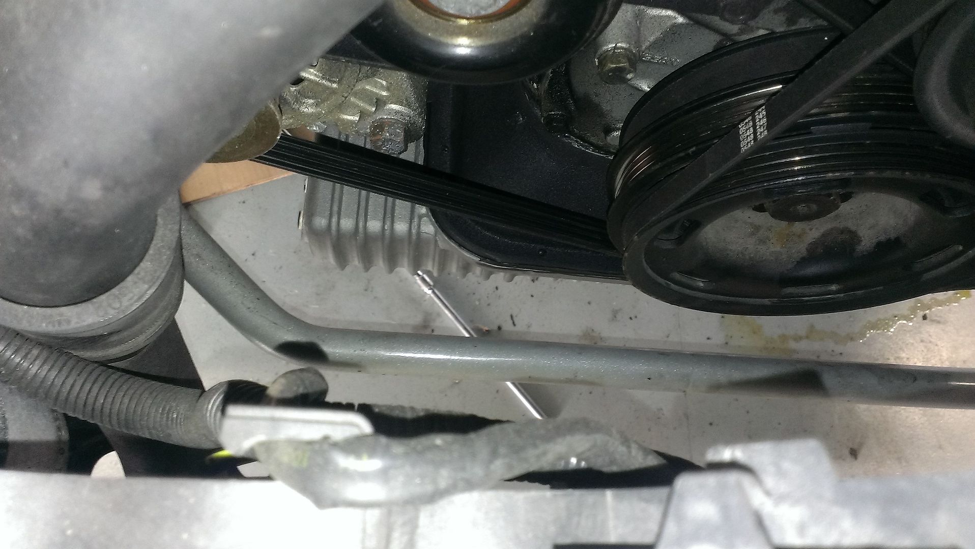

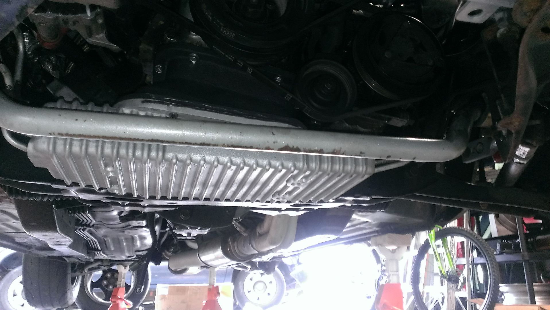

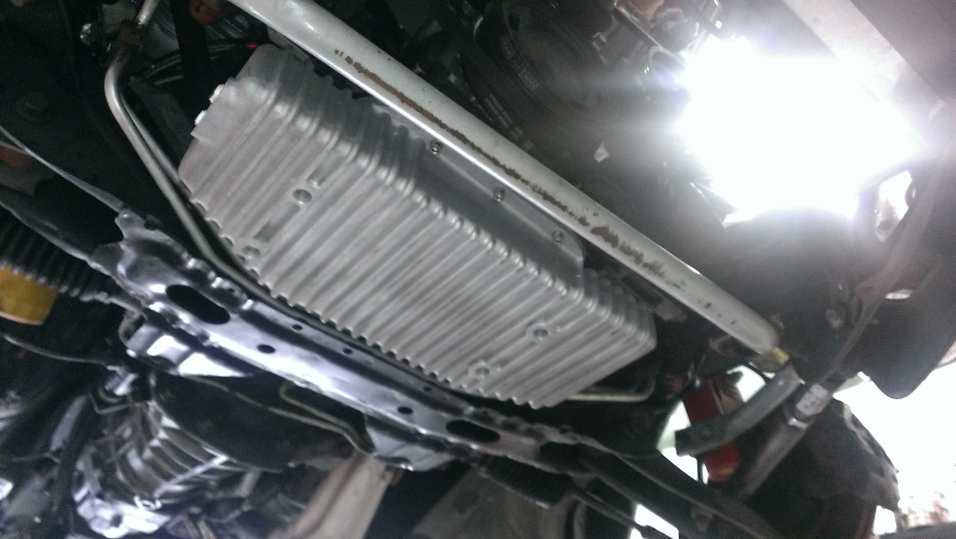

So, I removed the trans again and then installed the Xcessive pan, this time using Permatex Right Stuff gasket maker. It's in a compressed can, and it seems to work very well, forming a very strong and sticky/tacky bond. The fact that it is compressed is also a benefit because it works easily upside down. And the easiest way to do this is to RTV the bottom of the motor, rather than the pan itself. Doing it this way, you don't mess up the RTV during install like putting it on the pan would do. I bet it will be a nightmare if I ever try to remove the pan again, but I'm okay with that because I'm sick of dealing with oil pan leaks. I once again got the trans back in myself, although it did slide off the side of the trans jack at one point when I had to drop it back down, and it almost crushed my face.. oops! That was a wake up call and I was MUCH more careful after that.

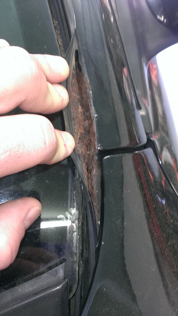

I noticed a few days ago that I was not able to hit full boost anymore. My water/meth activates at 5 psi, and a green LED is on anytime the pump is on. Well, it was just barely trying to come on. It was kinda pulsing, almost as if the boost just wasn't quite enough to fully activate it.
So, I felt down around the back of the supercharger and noticed that I could move the bypass valve lever and it was staying where I moved it to. I knew that wasn't normal. What it should do is spring back in one direction. So, I took off the bypass actuator today and it was obvious that something was wrong when I tried moving the actuator rod. I could just feel that something was broken when I pushed it in. Convinced that I had found my boost problem, I dissected the actuator with a cut off wheel. Sure enough, the spring was broken into 3 pieces.
A new actuator has been ordered. Courtesy parts showed it as out of stock. I'm just hoping it's not back-ordered or anything.
And here's a quick pick of the rust around the window frame:
NO bueno

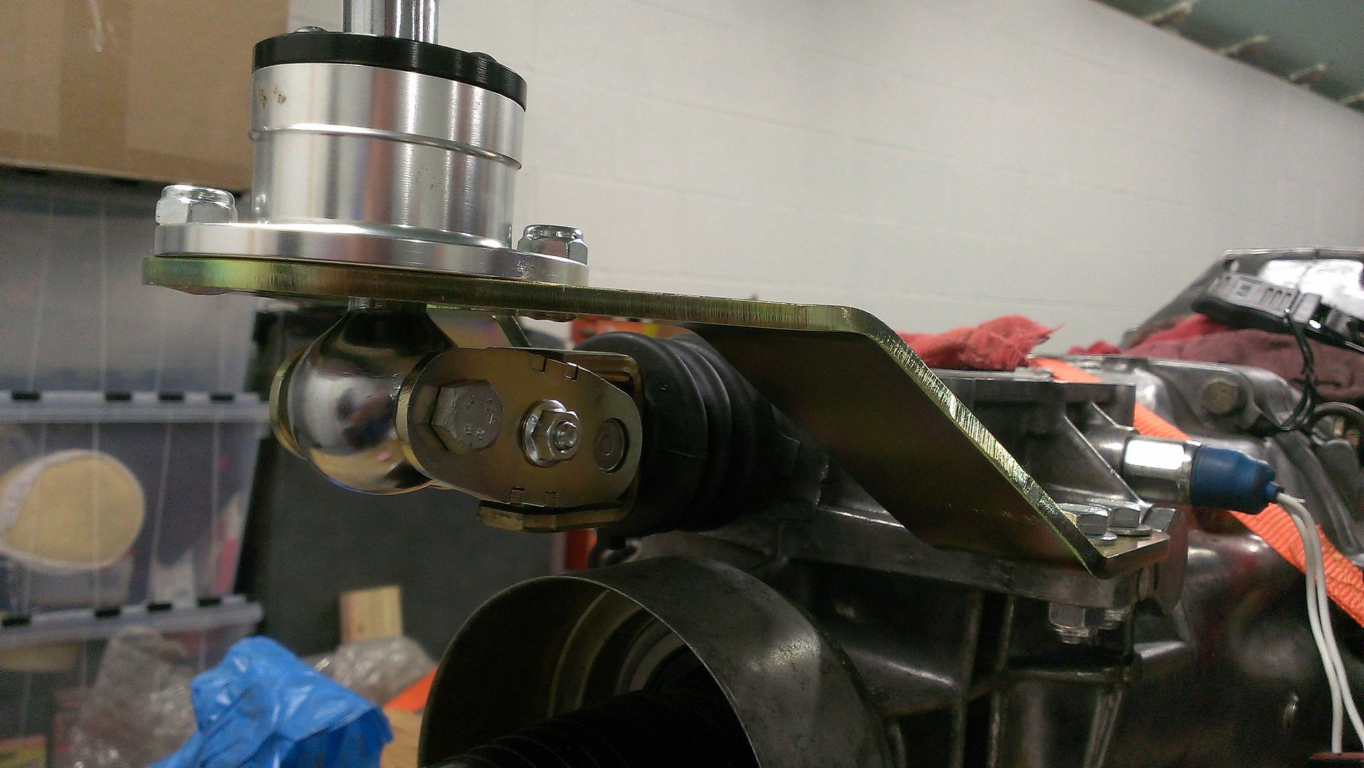

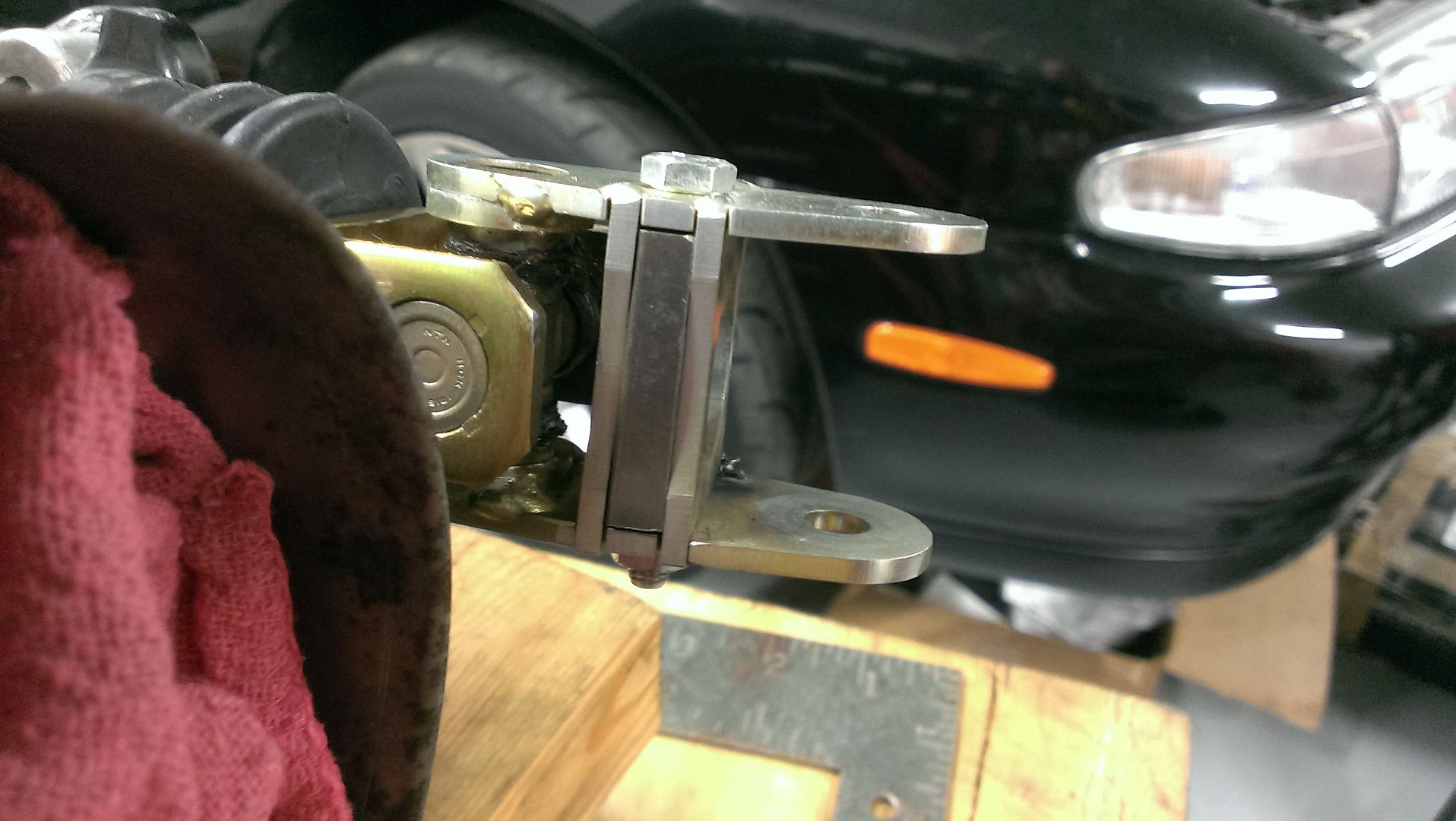

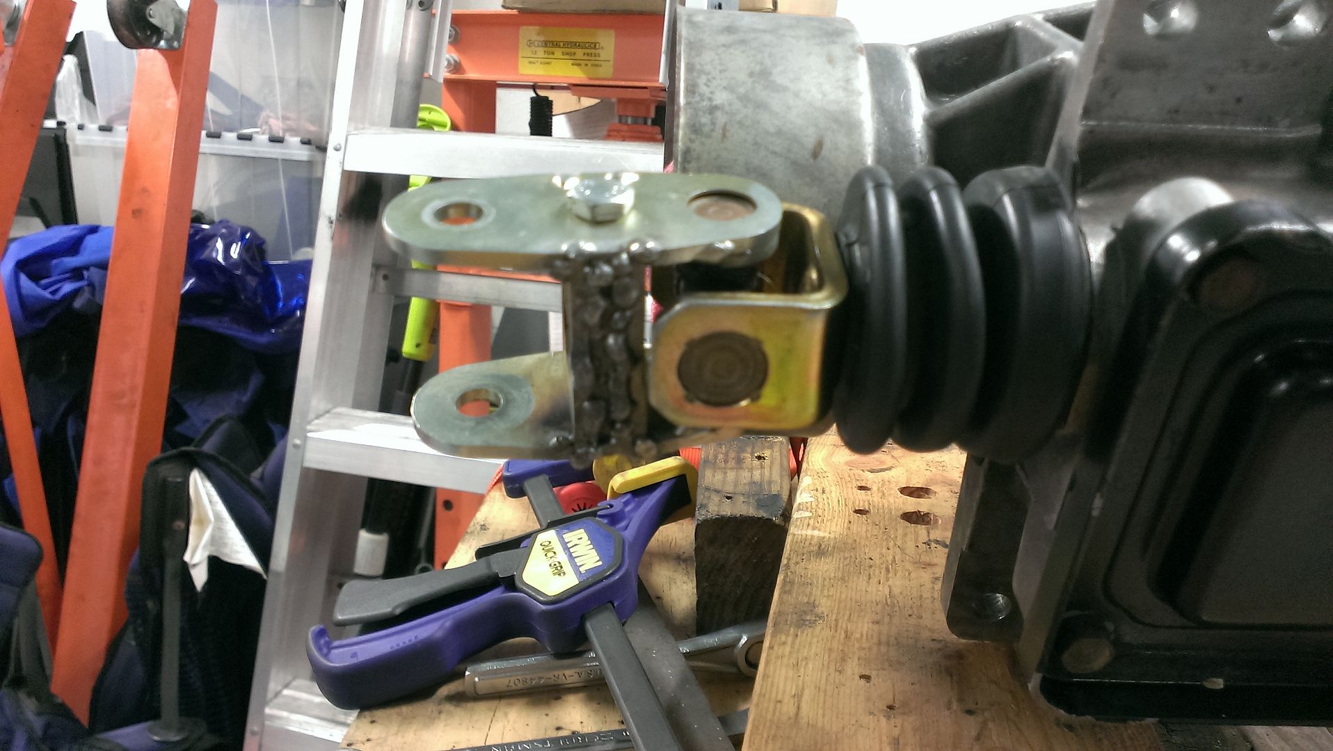

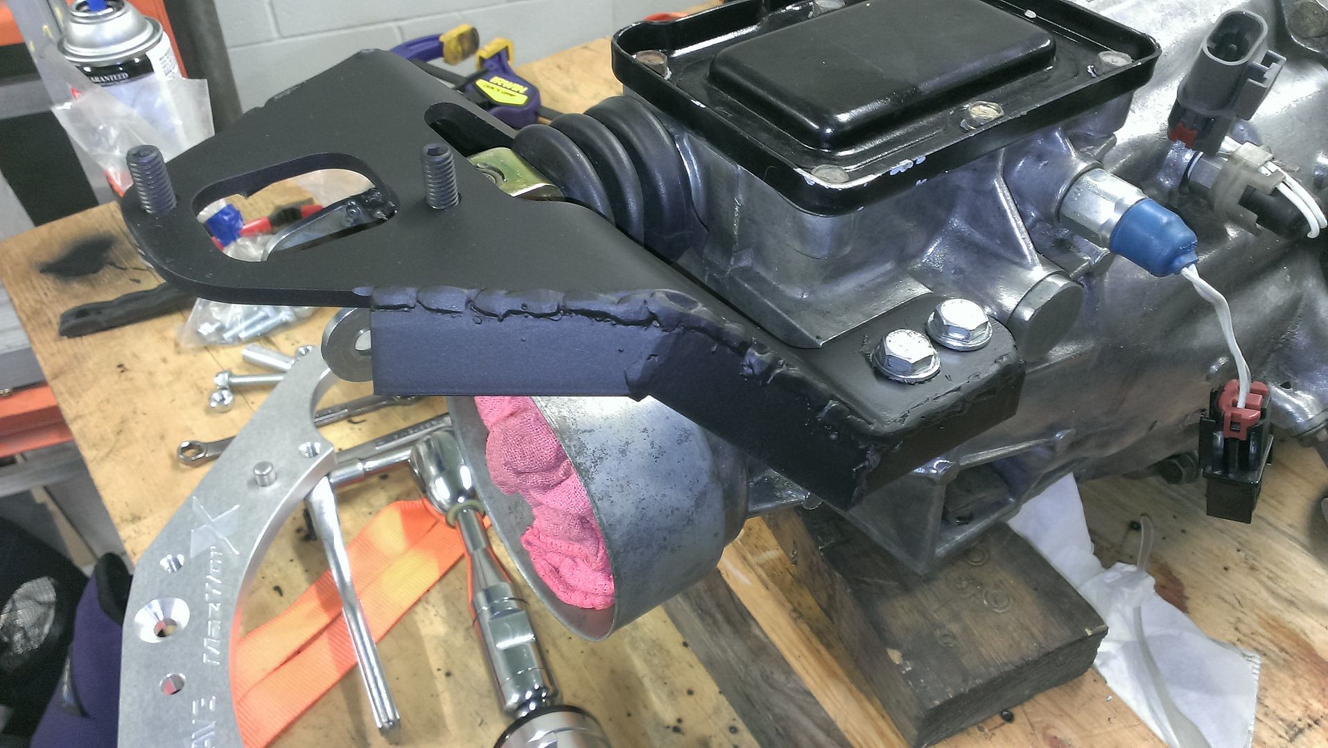

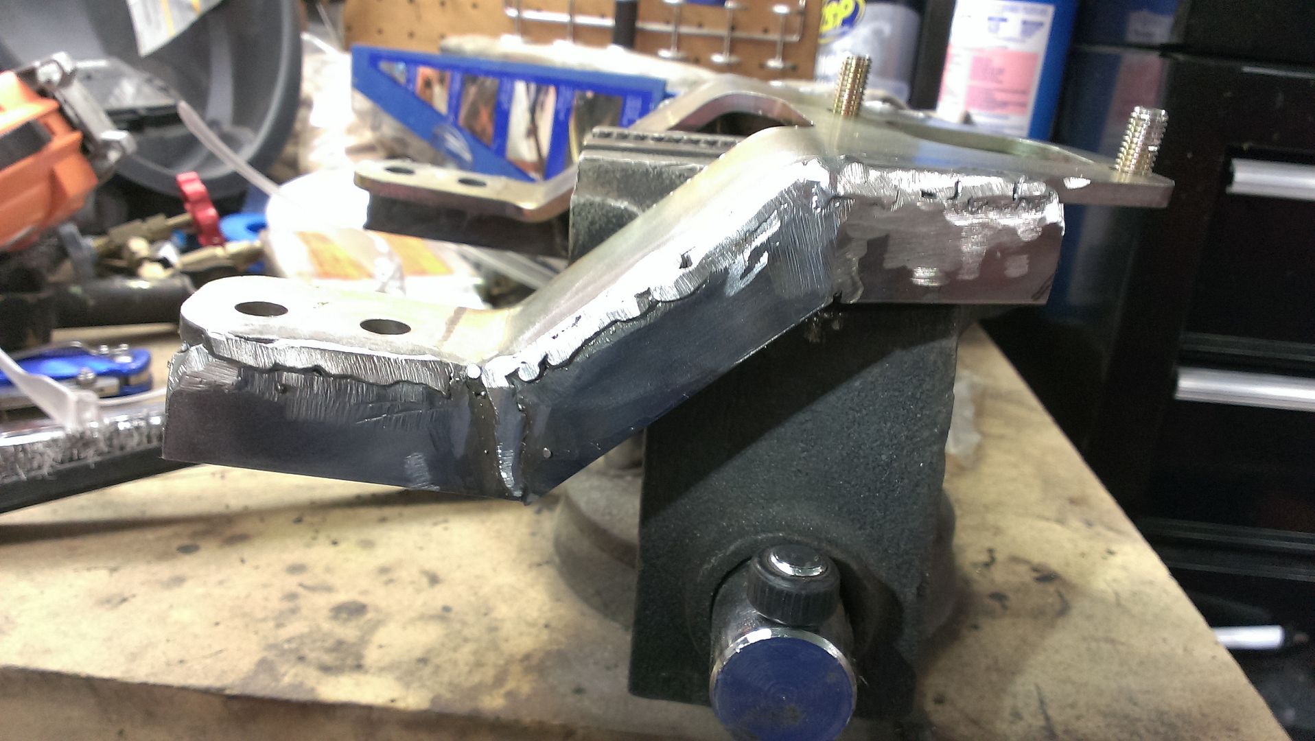

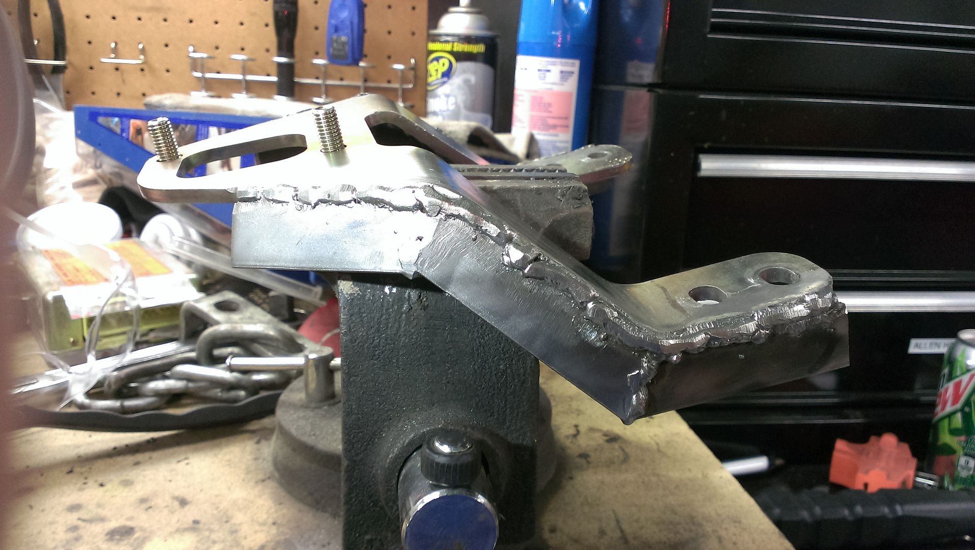

So, here are some pictures of what I did. I got the steel from Lowes. It's fairly thick, but I can't remember the exact thickness off the top of my head. I believe it was 3/16" thick. I used my buddy's MIG welder to do this, which works decent. The welds are ugly, but I actually got decent penetration, so it's very strong.
Before (lots of up and down flex)
After
I also modified the little bracket that connects the shifter to the striker rod. Someone in another thread had mentioned that it was also rather flimsy and got bent/twisted up. So, I cut a small piece to fit in both the top and bottom, and used spot welds to try and prevent overheating the bearing assembly. I'd do one tack weld, and then cool the whole thing off with a soaking wet rag. Then I'd do another tack, cool it off with the rag, etc. It's not pretty, but again, the penetration is good and it's a whole lot stronger now.
And the finished product with everything installed:
The entire assembly is now very strong with zero flex. Shifting through the gears feels so much better/smoother now. Like butta'

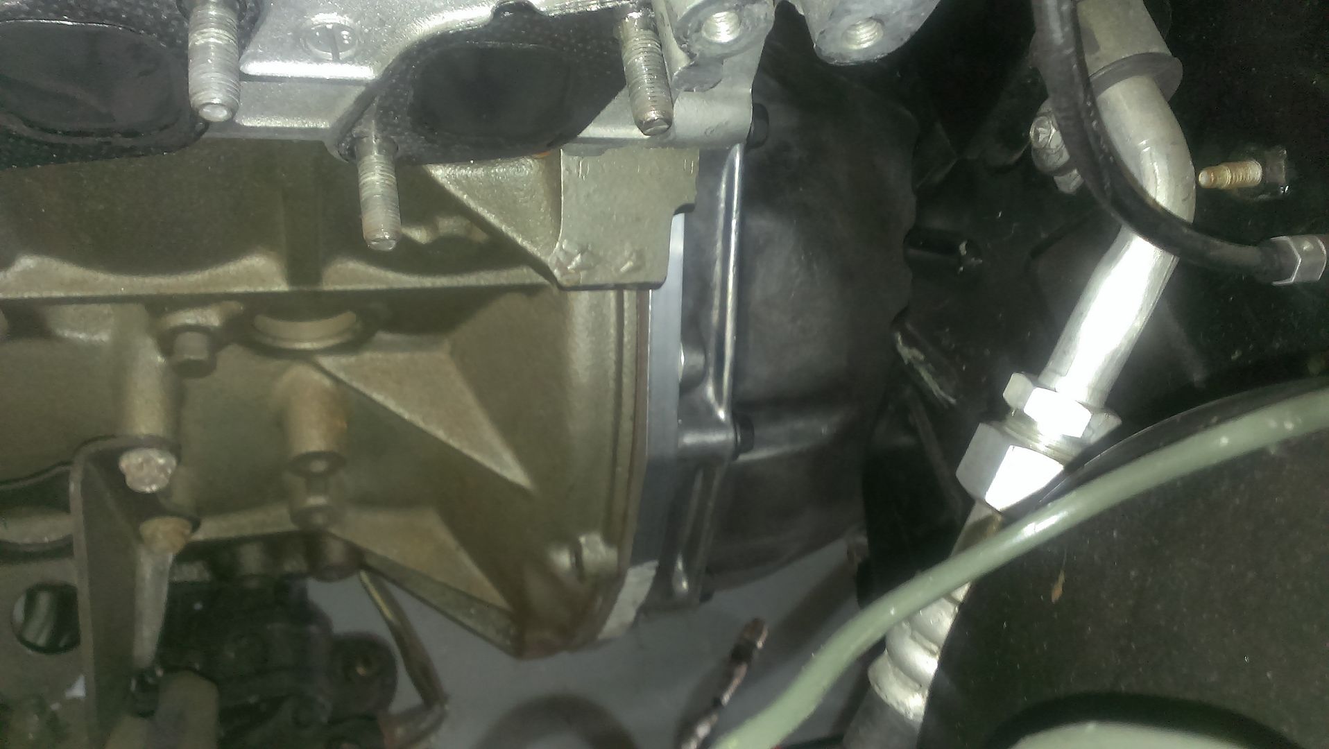

The only problem now is that my header is in the way of the Trans adapter bracket and trans. I tried doing some minor grinding to see if I could make it fit, but I was going to have to take off a lot to get it to fit. I didn't feel comfortable removing a lot of material from the bracket because it could compromise the strength of it. So, I decided to just buy a different header and be done with it. I bought the OBX 4-2-1 header off of ebay. It should give me a lot more room.
After

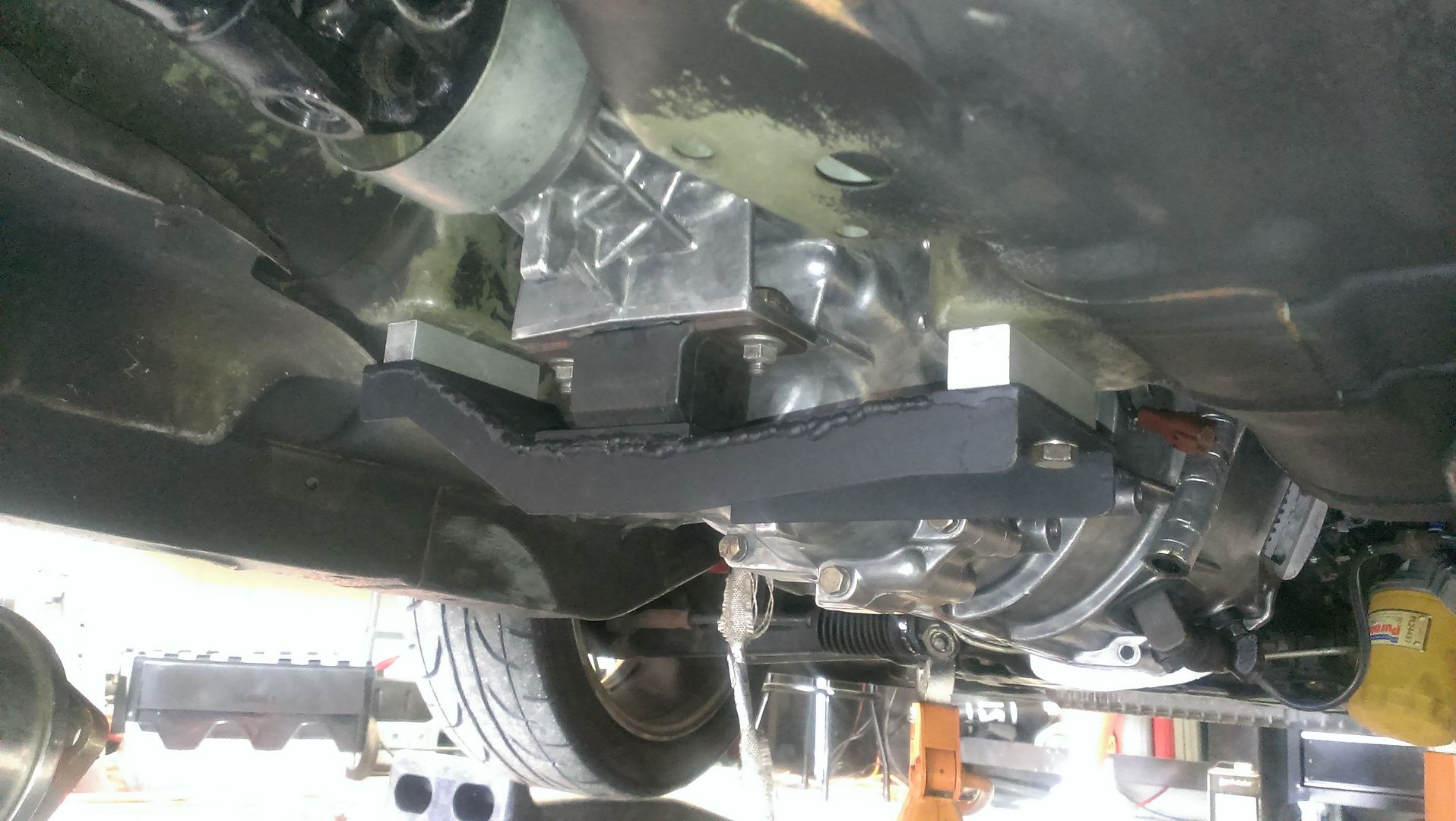

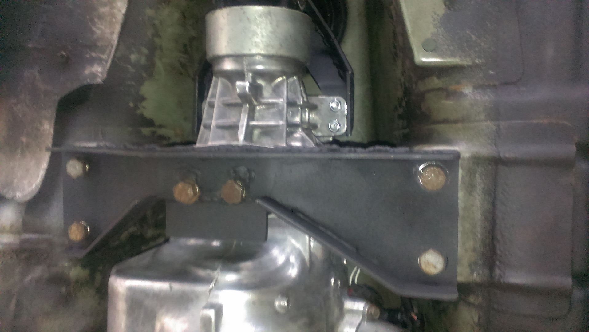

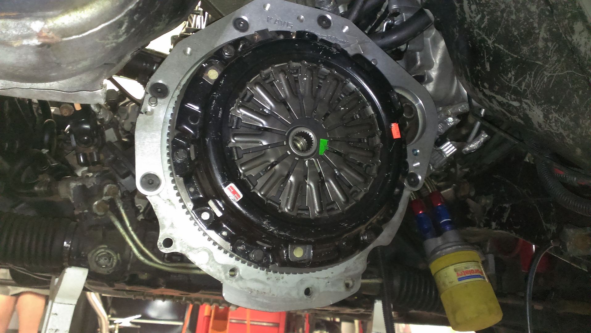

Finally got the trans in. Once we loosened the motor mount bolts and tilted the motor back with the hoist, the trans actually slid in very easily using a Harbor Freight trans jack. It actually went in easier than the stock trans did. Pictured is the Competition Clutch "White Bunny" 6-puck clutch setup. It uses a heavy steel flywheel and the setup is rated for 500+ whp.

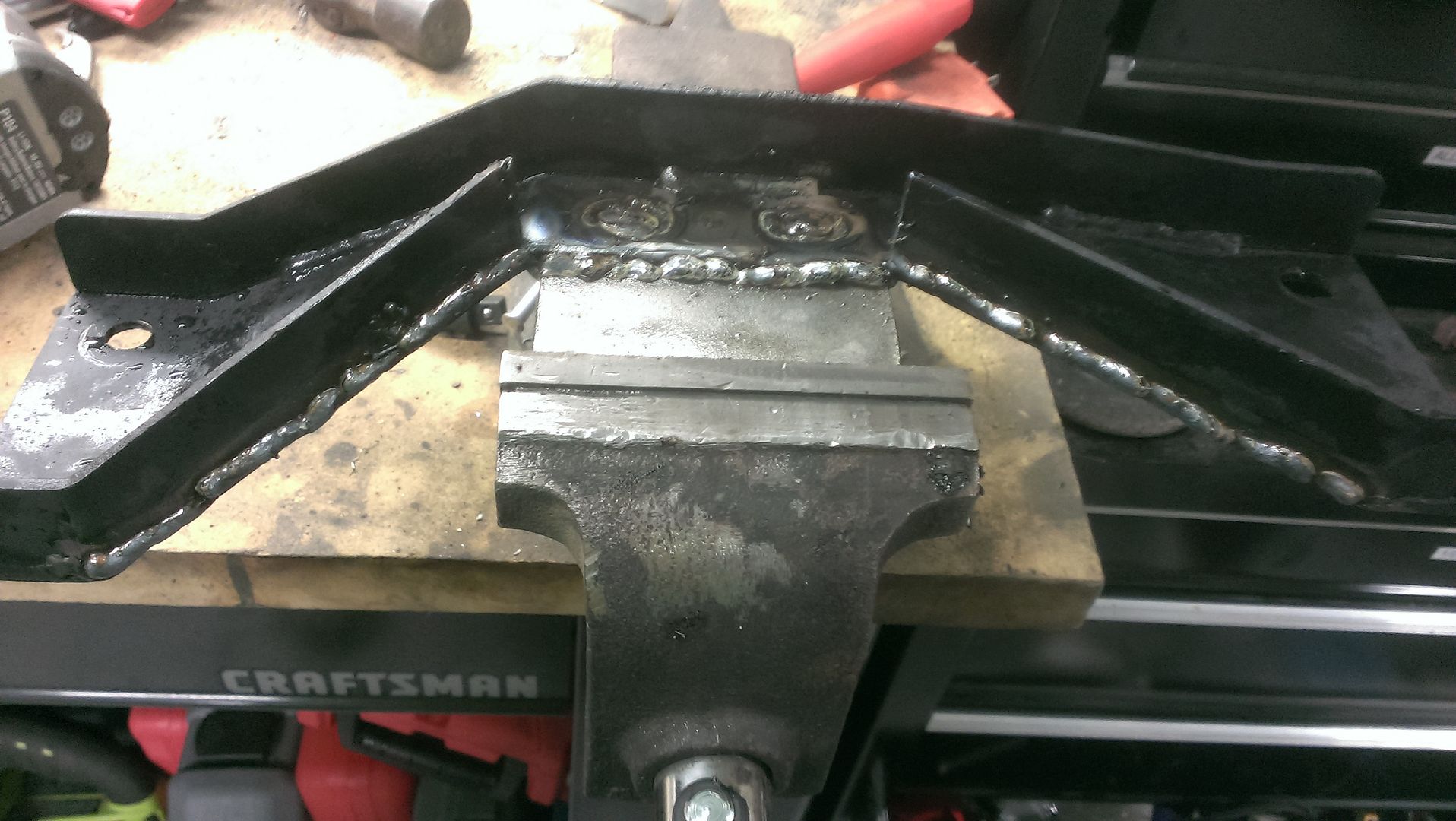

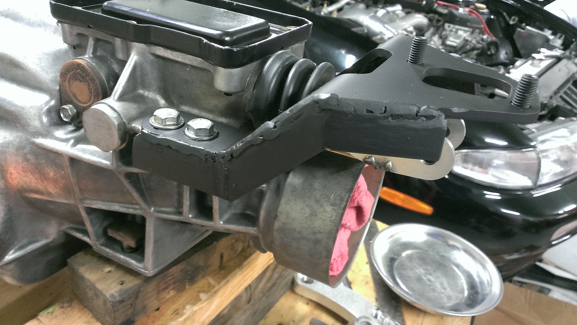

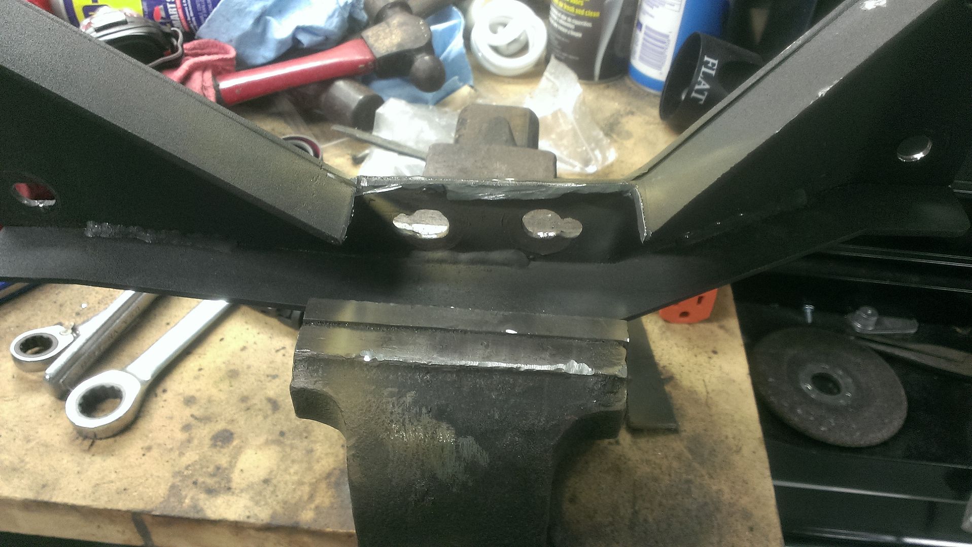

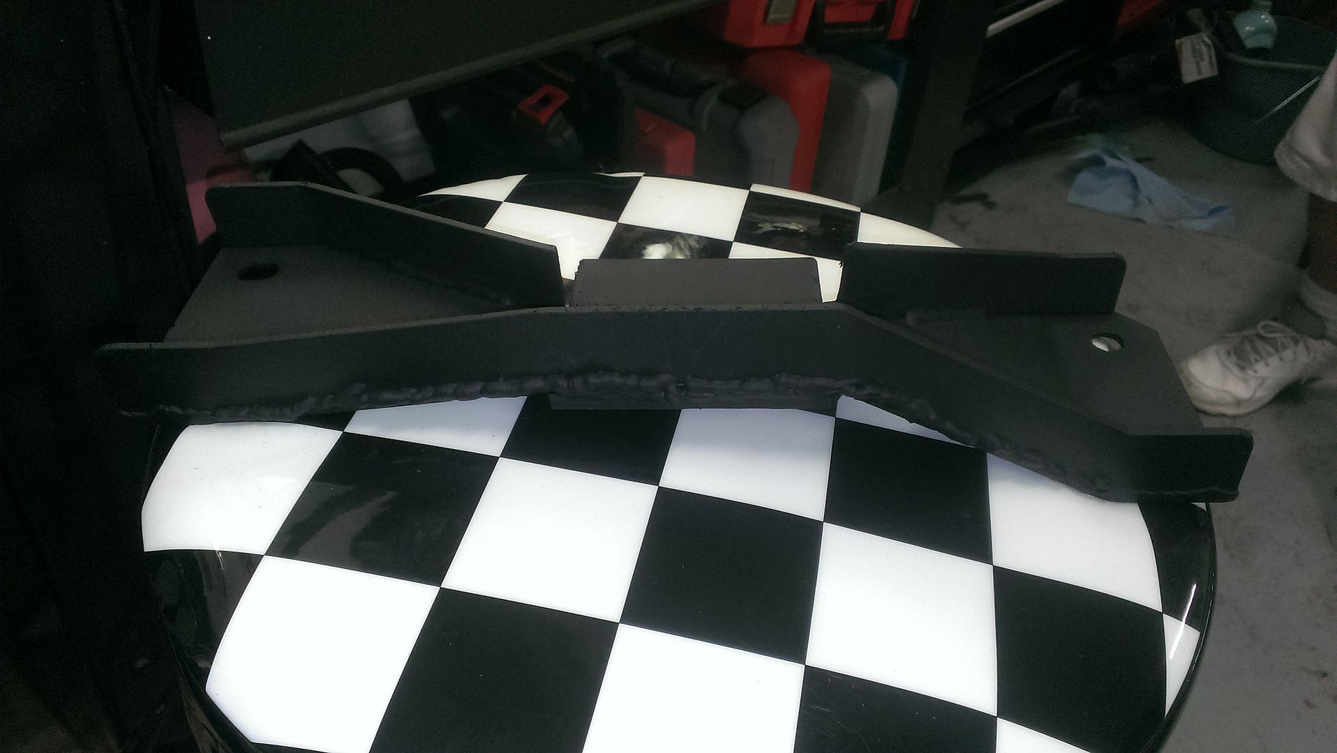

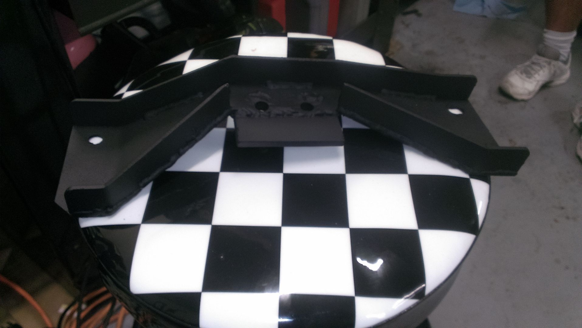

Now, as for the trans cross member, it did not fit well at all. After bolting it to the JGS trans mount, the cross member holes were about 3/8" too for forward. I tried everything I could to make it work, but it simply wouldn't line up. So, rather than call Mazworx and start the process of figuring out what was wrong, I simply whipped out the the 4.5" cut-off wheel and started making adjustments. Using a 3/16" thick square of steel that I bought from Lowes, I welded it in place and re-drilled my holes where I needed them to be.
Also, since I was taking away some of the strength of the mount by cutting off the piece that I did, I went ahead and completely welded the front and rear. Mazworx only had welds in a few locations, and I figured this would help with the strength of it.
Everything mounted up, including the new 4-2-1 OBX header (which also had to be modified because it had the exhaust sitting way too low).

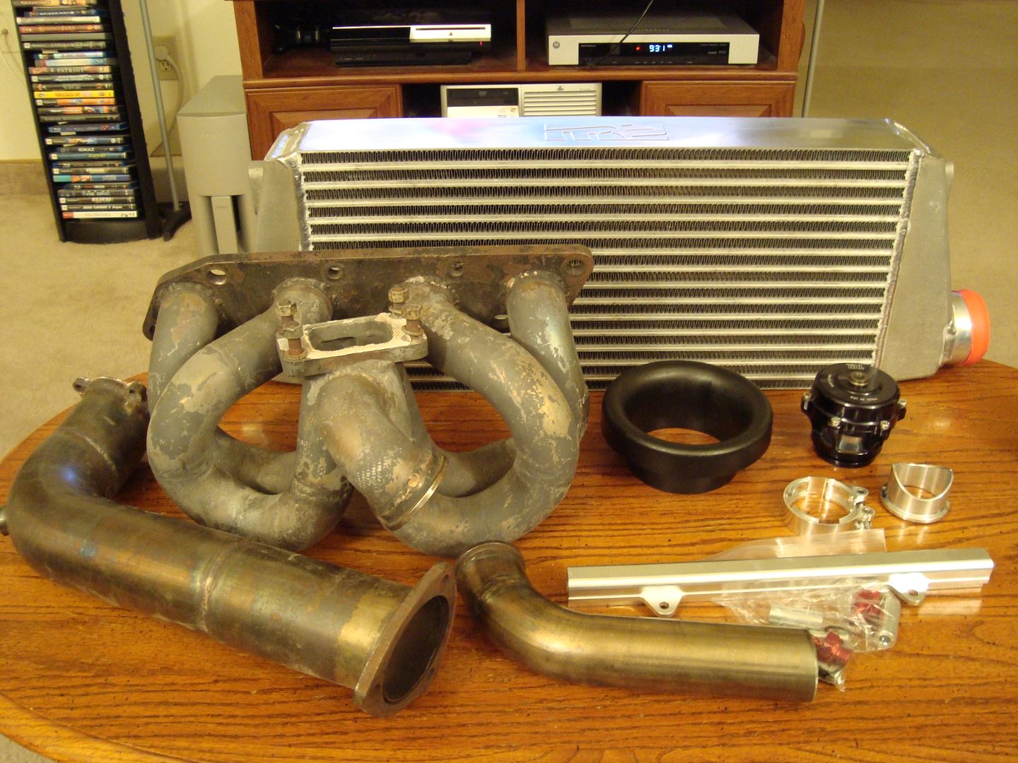

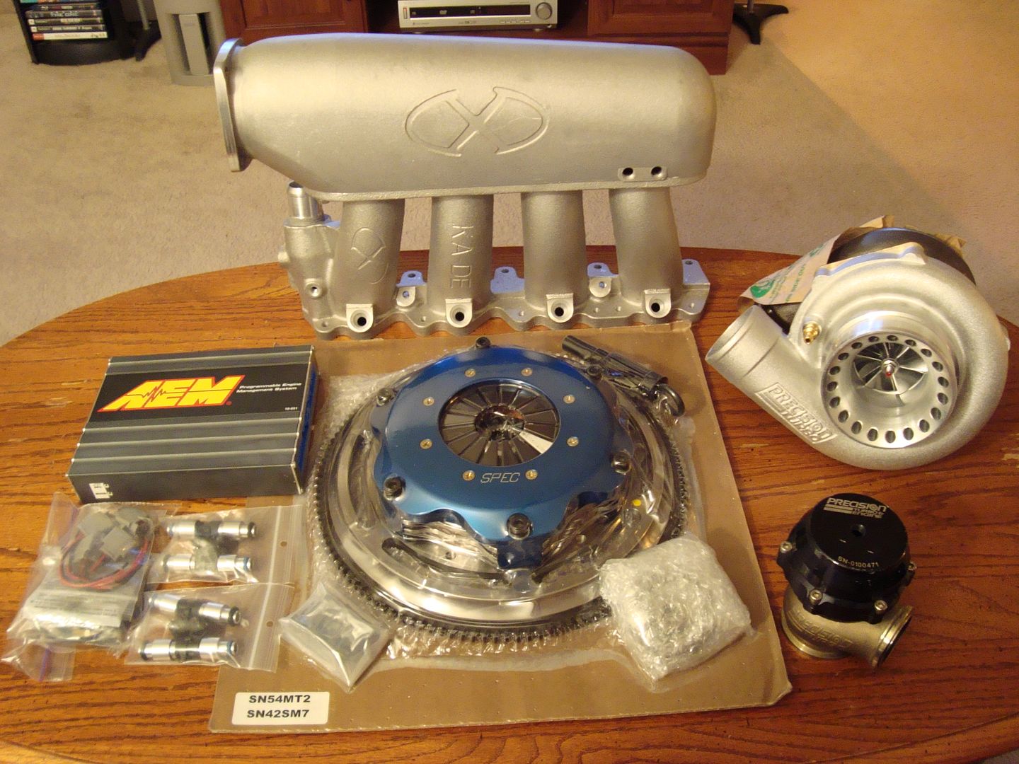

I think the time has come to kick this supercharger to the curb. And then...
***IGNORE THE SPEC TWIN DISC AS IT WAS SOLD***
I'm currently unemployed and should probably put all this stuff up for sale, but f*ck it... life is short and I'll be damned if I'm going to sell all of this turbo stuff without ever having installed it on my car and experiencing the sweet sound of that turbo at 20+ psi. Time to do work!!!
Here's the build list:
Wiseco 9:1 CR (.020" over)
Eagle rods
ARP mains and rod bolts
11mm ARP CA625+ head studs (time serts in block)
Cosworth head gasket
BC standard size valves and new bronze valve guides
BC dual valve springs and titanium retainers
JWT S1 cams and cam gears
*no porting on the head, just a 3 angle valve job
Equal length manifold
3" downpipe
PT5857 DBB
Precision 46mm wasegate
Tial 50mm Q BOV
Xcessive Mfg. Short runner intake manifold
Q45 throttle body
Kenne Bell Boost-a-spark
Magnecor 8.5mm wires
Nistune S13 ECU w/ homemade conversion harness
Nismo 740cc injectors
Nismo FPR
Z32 MAF
Aeromotive A340 stealth fuel pump
Z32 trans (Mazworx kit)
S15 HLSD
RB20 flywheel
ACT 350Z clutch kit - Xtreme pressure plate with full faced organic disk

3" downpipe
PT5857 DBB
Tial 50mm Q BOV
Q45 throttle body
Nismo FPR
Z32 MAF
S15 HLSD
RB20 flywheel
Possible future upgrades that I also have
AEM EMS
ID2000 top feeds
LS2 truck coils
Powerhouse Racing billet fuel hat
OBX fuel rail
-8 AN stainless braided PTFE feed and return lines
Walbro 485 pump. One to start, but I can easily add a second if needed

I'm trying to decide what to do with my fuel setup and would appreciate some input from you guys. There are 3 options that I'm contemplating:
1. I could leave the fuel setup as-is and just run my Aero340 and 740cc side feeds. I'll probably up my fuel pressure to 60 psi if I do this just to give me a little more power potential. This is the cheapest and easiest solution and my only real concern here would be fitting the side feed injectors and fuel rail on the Xcessive manifold. I know Superdorifto had to do a lot of work to get his seated and mounted correctlly.
2. I could also stick to side feed but source some slightly larger injectors like Sard 850cc's or maybe even the DeatschWerks 950cc. There was a guy on here who made over 500whp on the Aero340, Sard 850s, and 60 psi of fuel pressure: viewtopic.php?t=53004. He said he could have made more power but the fuel pressure was dropping, which makes me think that if I went this route, I should probably swap my Aero340 for one of the Walbro 450s.
3. If I'm going to run the 2000cc injectors that I have in the pictures, I really think my best bet would be to get one of the billet fuel hats from Powerhouse Racing and install 2 of the Walbro 450lph pumps: http://www.powerhouseracing.com/p-4597- ... 3-r34.aspx. Pretty much the same setup as Duron is running. This is the most time-consuming route as I'd have to run new fuels lines, mount new fuel pumps, etc. However, I already have a top feed fuel rail and plenty of stainless braided -8AN tubing. So, the billet fuel hat and Wabro 450's would be the only additional items I would need to have a fuel setup with 700+ whp potential.
*I also have an AEM series 1 EMS and I actually have a base tune for the 2000cc injectors that Adam Creedy sent to me a year or so ago. So, I could probably get the car running and driving without much extra work.
The appeal of options 1 & 2 would be much less work and time involved. Time is going to be a factor here as I am using a friend's garage and really want to have everything running and out of his garage as quickly as I can. Of course, the negatives of options 1 & 2 would be less power potential and there's also the danger of not having enough fuel if something weird happens like a wastegate line pops off and the car overboosts.
I should mention that I'll be running E85 and my goal is 450+ whp with room to grow. I''m running the Saturn head studs and they are pretty much my main limiting factor here. I don't want to lift the head.
