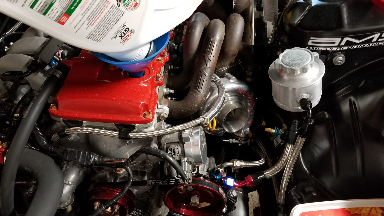

I went with this manifold for a few reasons. One of them is the fact that it's a AMS manifold. It's fully warrantied so I'm good if anything happens to it. It'll also be easier to fab/mate the downpipe to the rest of the exhaust and lastly, there motor balance in the engine bay will be improved since the weight of the turbo will be down low now.

Did some **** over my weekend. Finished up the oil plumbing by installing a 1/8 NPT -T- on the filter adapter to run the oil pressure sensors. Also mated the transmission to the motor for the 1st time since 2009, and then dropped it into the chassis with some help from friends. Booked a welder to fab up all the intake and exhaust piping. She'll be going on a trailer in a few weeks here. Getting there!

What fittings did you use for coolant? So that will be the drain for the turbo, where will you get the feed?

street_240sx wrote:What fittings did you use for coolant? So that will be the drain for the turbo, where will you get the feed?
A few others have asked me the same question. I bought it through Summit Racing back in 2010, but they had since updated their website and I lost my order history in the process. I just spent a good amount of time looking through my emails and I found the fitting info in one of them!!!
So, for those of you who would like to use the drain hole as a feed for cooling a turbo/wastegate, here's the fitting you'll need. You can run the return to the back of the intake manifold.
Fragola 491201-BL: https://www.summitracing.com/parts/fra-491201-bl
From what I remember, you'll need to re-tap that thread in order for this to work. My father, who's a manual machinist, helped me with this.

Hmmm wonder why you have to retap it? I have the taps at my work so it shouldnt be an ordeal. What part of the intake? I dont have a factory one anymore so i only have the heater hose, maybe tee into that for the return?

street_240sx wrote: Hmmm wonder why you have to retap it? I have the taps at my work so it shouldnt be an ordeal. What part of the intake? I dont have a factory one anymore so i only have the heater hose, maybe tee into that for the return?
I believe we did it to clean the threads up a bit and to seat the fitting deeper into the block. You should be able to -T- into the heater core return hose.

Post by Alonso » Fri Oct 21, 2016 9:35 pm
the coolant plug on the side of the block has 1/4" BSPT threads.

Alonso wrote:the coolant plug on the side of the block has 1/4" BSPT threads.
Yup, additionally, the 1/4" BSPT has 19 threads/inch VS the 18 that the NPT has.
