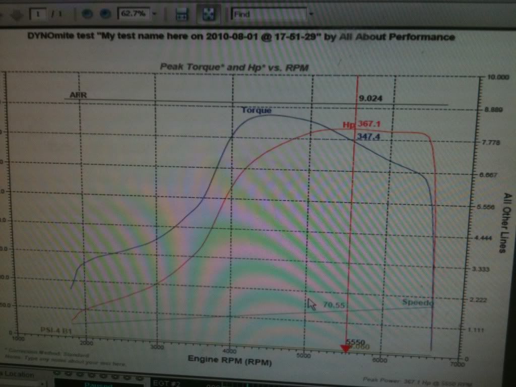

They said they would email me the dyno sheet, but until then... heres a pic I took with my phone.
Vid: http://s286.photobucket.com/albums/ll82 ... G_2389.mp4
Hy35 @ 16lbs
DW 810s
N62 Maf
9:1 Wiseco pistons
AMS rods
Stock cams
Stage 1 port/polish head
Felpro headgasket
Full ARP hardware
RB20 flywheel
350z Stage 2 full-faced
Eprom tune
Safc2 for fine tuning (I hate admitting this, but I messed with the tune on the way to the dyno with the afc.. will eventually fine tune on eprom, but it was leaning out up top. That probably screwed with my timing a bit)
