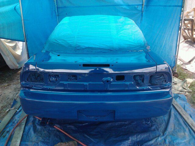

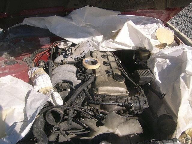

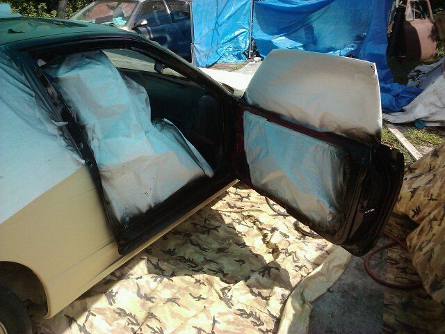

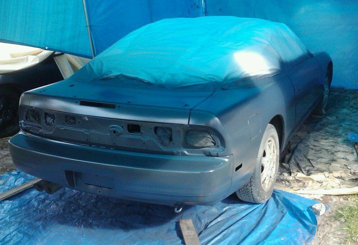

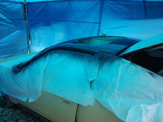

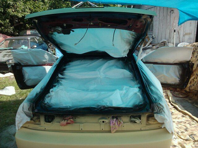

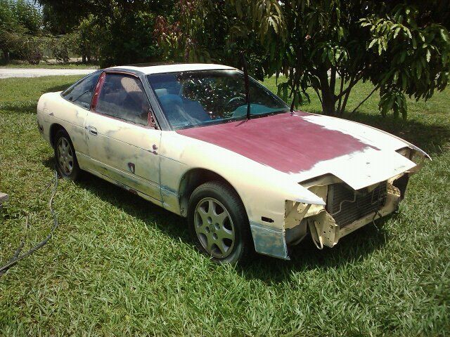

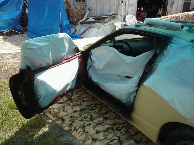

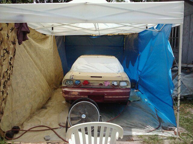

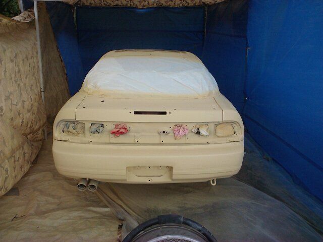

thanks miliman...what pic are you talking about though...i dont have a brace on the engine...i have been rubbing down the body for clear then i will pay more attention to the bay...also, i will be updating pics in the next two weeks or so with a better camera...then you can see the setup better...

It's funny what new paint can do to a car and I like that color.
Post by supakat »

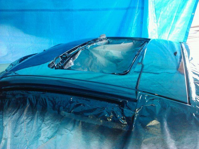

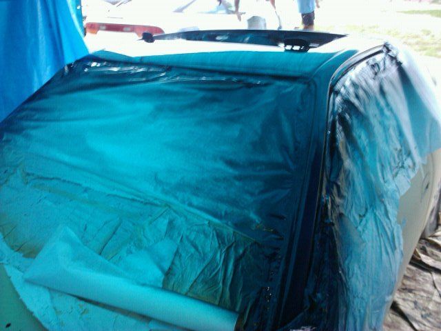

yup...same applies for rims...it can make or break a car...i am thinking about putting red tint in the clear...so at different sun angles, it will have slight difference...
I wish the color was darker but it keeps growing on me...

supakat wrote:yup...same applies for rims...it can make or break a car...i am thinking about putting red tint in the clear...so at different sun angles, it will have slight difference...
that would be pretty tuff. Do it.

Car looks clean, i like the blue. Mine is going into the paint booth as well its going to be the porsches midnight blue
Post by supakat »

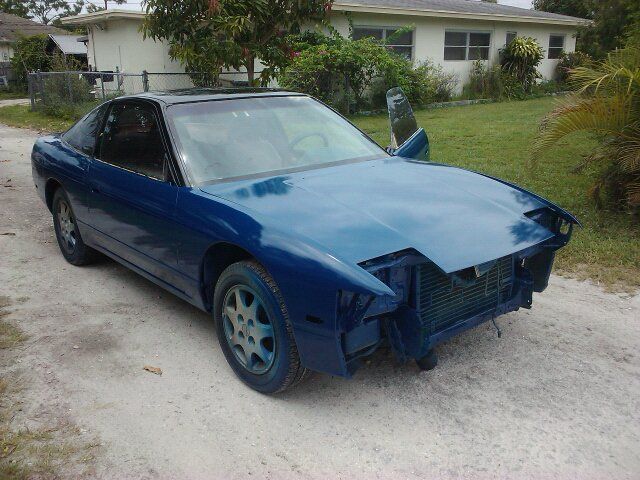

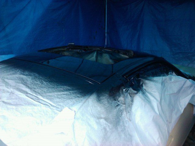

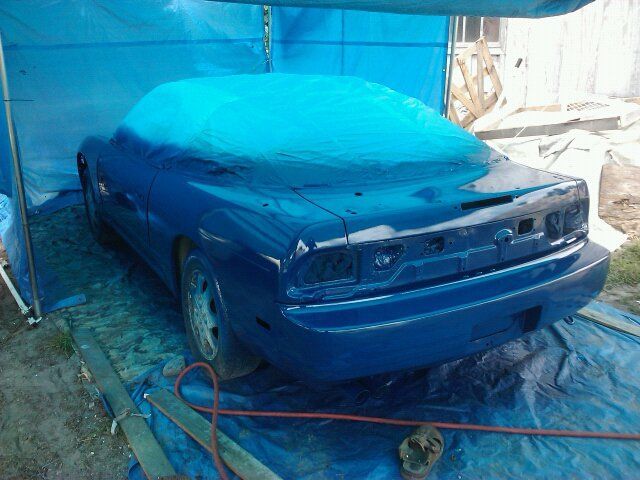

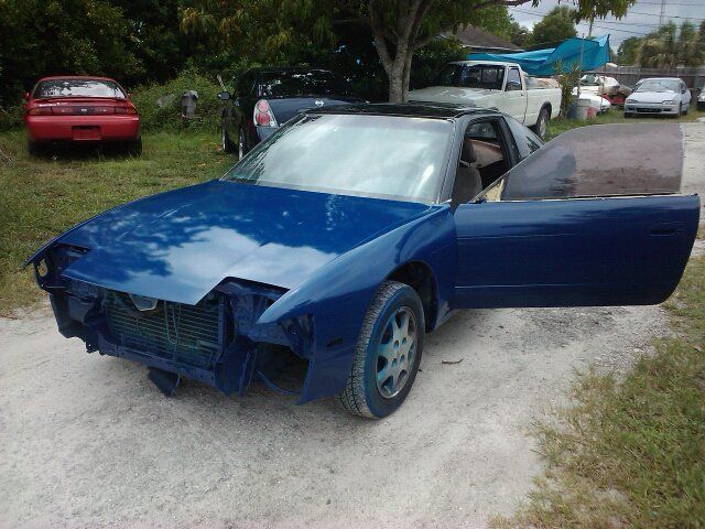

Clear is done...spec v's on car...ready to roll!!!

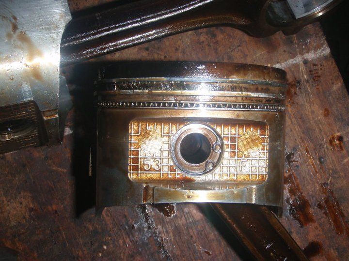

Update: Well back in October I overboosted on the motor. Here are the damages to the motor. Next week take the block the shop, figure what i need .020 or .040 and order pistons and rods. I need to mic the crank for the bearings which i hope are still standard size.
And get her done.
Three pistons broke the ring lands.

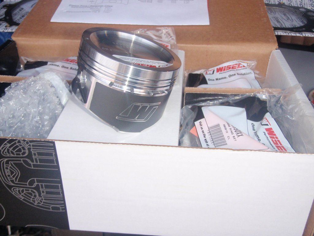

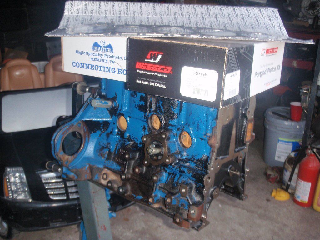

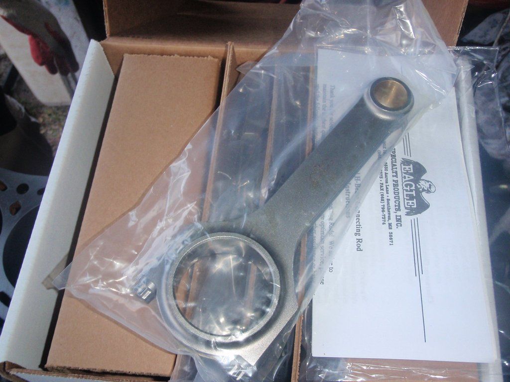

Machine shop called me. I am gonna go get my block today with rod's, piston's, HG and some other stuff. Will post pics once I get the block back on the stand.
.020 bore
9:1 comp .020 bore
H beam rods

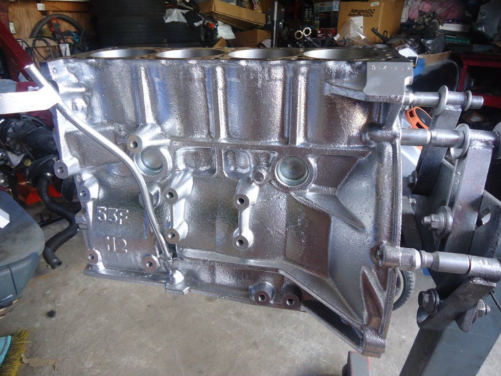

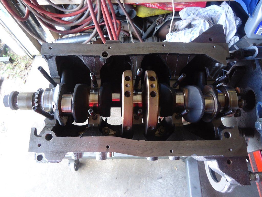

I did some work last night. Put in the new freeze plugs, installed the oil squirters and sprayed the block. I am going to see about installing the crank hopefully today or tomorrow.
Installed crank and pistons/rods

Tonight was a good night. Assembled the short block. Pistons went it smoothly and torqued to specs. Rotating assembly rotates by hand just smoothly. Now to redo a return line to the oil pan and bolt up the front timing cover.
