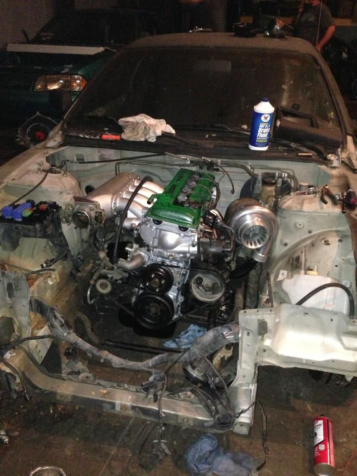

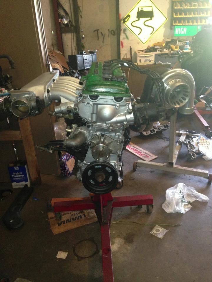

heres a picture of the motor in question

denty95 wrote:93 octane for daily.
when i take it to tx2k im going to use c16 and get a retune
Nice man engine is clean . Make sure you keep us posted on your progress =)
KA-T S12
Posts: 58
Joined: Tue Sep 11, 2012 3:55 pm
Location: Whaleyville, Maryland
Re: Just a few questions regarding a tune
Post by KA-T S12 »
^ agreed. Can't see anything that I don't like there. Keep it up 8)

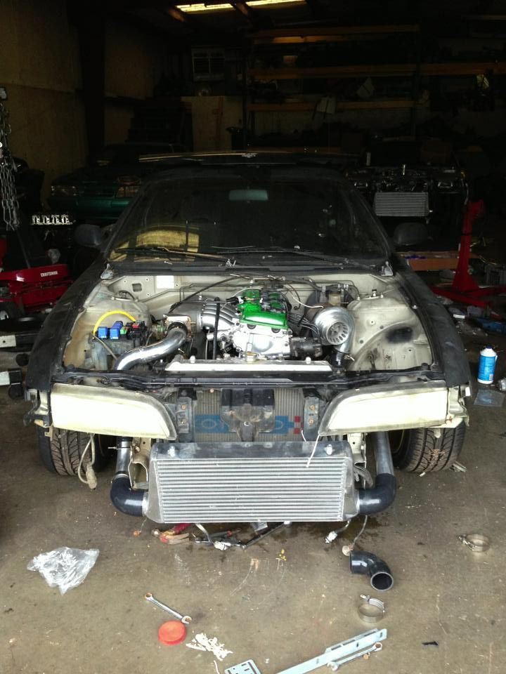

I got my bov and AEM in the mail, so in went the motor tonight. Its a tight fit, but im going to make it work.

I decided I was tired of wiring last night, so I welded my core support back in and out my fenders and hood back on, anyone else's turbo not clear the hood? :/

thanks man I appreciate it. heres how it sits as of tonight. tomorrow I have to make a faceplate for my gauges and put my bride reps in.

nice progress man
