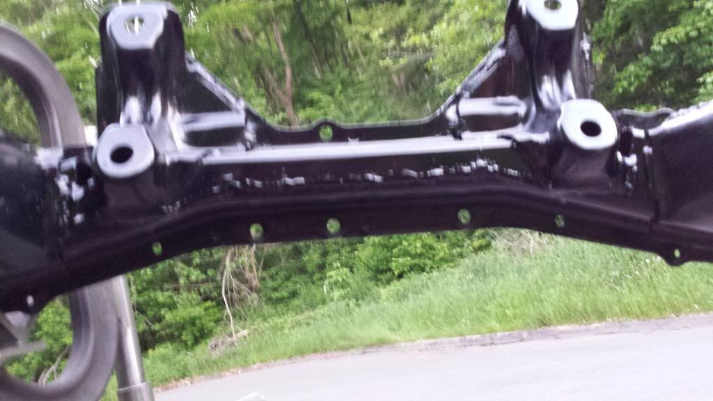

Here are some recent mods ive done to my suspension / steering setup. after 1 event, i couldnt be happier with the result.
Knuckles, Cut N Chut, 3 7/8" ball joint to tierod center to center, no ackerman correction
only have one blury photo of the root pass. 200 amp tig no filler, then ran 200 amp mig with mild steel wire. V groove prepped joint so i could get 100% penetration. came out purdy good.

Steering Rack Relocation ~ 1"
this is a really quick and easy mod - if you have the subframe out already. ive since added PBM rack bushings as the Energy Suspension ones quickly tacked out after install (clunking etc) as a note, with JGS mounts, the rack relocation and PBM mounts, i had to space up my mounts almost an 1/8" for the rack to clear the pan.
